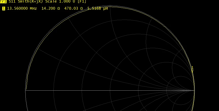

I'm trying to measure X-Nucleo-nfc03a1 with VNA:
i got completely different values for C11 C22 and C2 as is on nucleo board. I understood something wrong?
and when I remove Resistors 330ohm, inductor and 4 100pF capacitors
I got like:

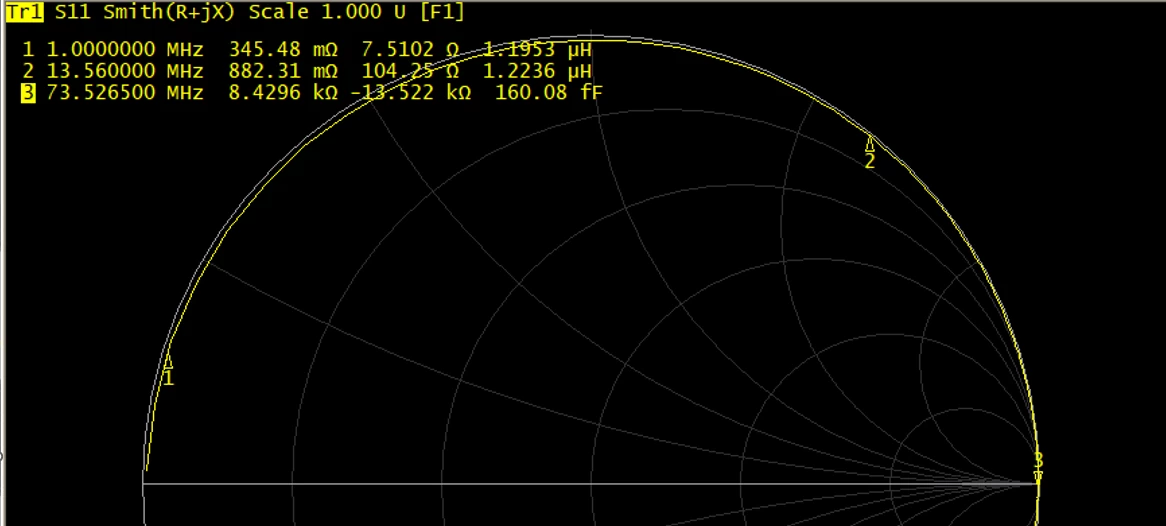

I made some step by step measurements to help you in your investigations (after removing all components on the board). Impedance are extracted @ 13.56MHz.
- antenna impedance: Za=1.19Ohm ~ 1.25uH (~means "in series with")

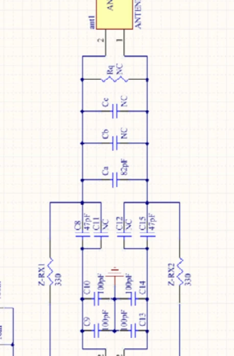

- ST/CR95HF input impedance on RX1/RX1: ZCR95HF= 16 ~ 22pF = 20kOhm//22pF
- Za // (ST95HF ~ 330Ohm ~330Omh)= 9.9Ohm ~ 1.35uH
- [Za // (ST95HF ~ 330Ohm ~330Omh)]//82pF = 196~5.6uH
- [[Za // (ST95HF ~ 330Ohm ~330Omh)]//82pF] ~ 47pF ~47pF = 164 ~ 283pF = 190 // 24.3 pF
- [[[Za // (ST95HF ~ 330Ohm ~330Omh)]//82pF] ~ 47pF ~47pF]// (200pF ~200pF) = 41.7~157pF

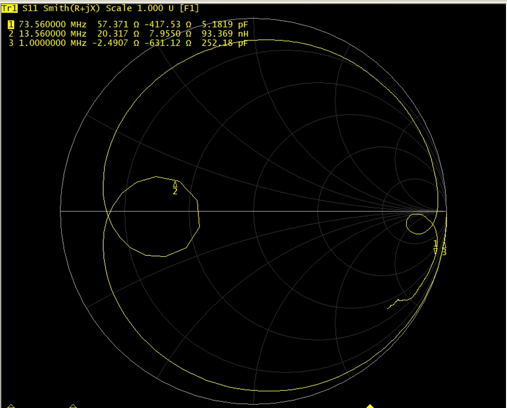

- "Rin" = Zin = 47 ~ 177nH (+15j)

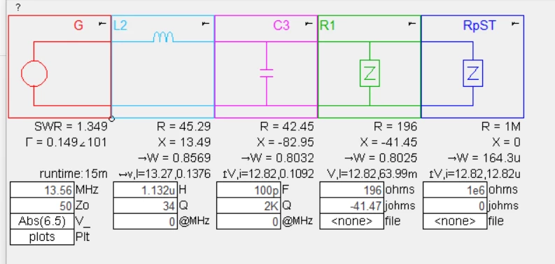

if you use a tool like SimNEC and start the matching form the impedance mesured on the input of the two 47pF capacitances Z=[[Za // (ST95HF ~ 330Ohm ~330Omh)]//82pF] ~ 47pF ~47pF] = 239 ~156pF = 262 // 14pF, you'll see that the result is Zin= 45.3 ~13j which is very close to the measured value Zin = 47 + 15j.
To summarize, the issue you are facing comes from a BOM issue combined with the limits of the model used in excel sheet. As said by Travis, our ST25R reader IC family as to be considered for production but also because it comes with a more accurate and detailed  simulation model based on QUCS and available in our online tool eDesign Suite.

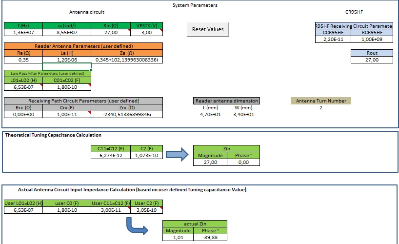

on tx1 and tx2
the question still what I measured wrong in first step that I didn't got the same capacitors as calculated in excelsheet? Any help are welcome

as far as I can see, you have changed R1 compared to the AN5248 from 50Ohm to 27Ohm.
Can you confirm that for the antenna measurement in your first post, you have disconnected the antenna?
