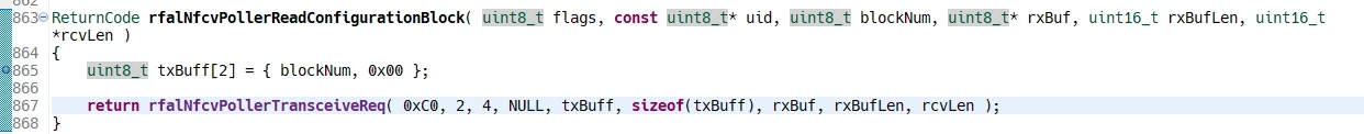

Thank you for your reply.  I have updated my function to this:

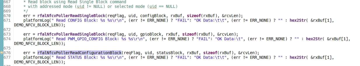

So, just for testing, the parameters flags and uid aren't used, and instead I hard code the values passed to rfalNfcvPollerTranceiveReq(). It is being used in the X-CUBE-NFC6 example application demo_polling, inside the demoNfcV() function like this:

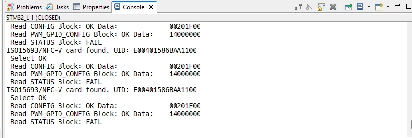

And it is not quite working for me.  The output to the console is this:
and when I debug, I can see that err = 4, which is RFAL_ERR_TIMEOUT.  Do you have any thoughts as to where I might look next?  It seems that inside of rfalNfcvTranceiveReq() the message is being built properly, but I'm a little out of my depth.  Thank you.

any reason why you reversed the txBuff and why you changed the 0xA0 to 0x00?
Ulysses
