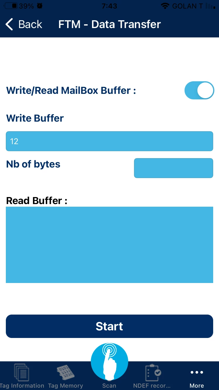

While doing an FTM transmission from RF to I2C and reading the MB_LEN_Dyn register, it will always report a length which is 6 bytes more (or 7 after the increase by one in my code) than the actual message length.
Below is the code of the ISR handling this. Can you please let me know what am I doing wrong?
On the mobile side, I am running the NFC Tap and using the FTM - Data Transfer screen.
Thank you,
Nir.

NDvas.3
NDvas.3Author
September 12, 2022
Hey JL,
Thank you. Please see attached the screen shot from the NFC tap. In this case, i was sending "12" which is suppose to be 2 bytes long.0693W00000Sv8c9QAB.pngThe output i got for this from my serial logger is:
113,  7 ,  5,  49,  50,  23,  4,  219,  103
As you can see, there 9 bytes here. Only the bolded ones (which I have bolded here) are the actual data (ASCII representation of 1 and 2). I do not know what the App sends out but I thought it would
just be the data itself. Is there a prefix or suffix sent?
Mind you, I found a clue to this mystery. The second byte (in this case 7) will always be in the value of the length i get (in this case 9) minus 2. Maybe this can help explain something.
Thank you for your help,
Nir
JL. Lebon
JL. LebonBest answer
September 12, 2022
Hello Nir,
Ok, yes. The NFC Tap is using a kind of SW protocol on top of the FTM feature to allow control and error check for long data transmissions. It is meant to be used with the ST25DV-DISCOvery board, which understand this protocol for its FTM embedded demos.
Basically, this protocol adds some headers and CRCs to the data you want to send. The STM32 FW of the ST25DV discovery kit is able to decode those headers and CRC so that the whole system is able to detect errors and eventually retransmit packets.
In your example, the first byte "113" means that the data sent is a full segment of data, that next byte is the length of data transmitted and that CRC is present.
The next one "7", as you guessed, is the length of data to come.
Then you have "5" which means in this SW protocol "FTM send data"
Then you have your 2 bytes of data.
And finally 4 bytes of CRC for this packet.
This protocol is an example of what can be done on top of FTM. You can get the source code here and see how it works: https://www.st.com/content/st_com/en/products/embedded-software/st25-nfc-rfid-software/stsw-st25ios001.html
Best regards.
NDvas.3
NDvas.3Author
September 12, 2022
Oh! I spent almost 5 hours trying to figure out what's going on! I think it will be a good
idea to note this somewhere so that someone using the NFC Tap with a dedicated hardware would be aware of this.
Anyway, thank you for your help!!
