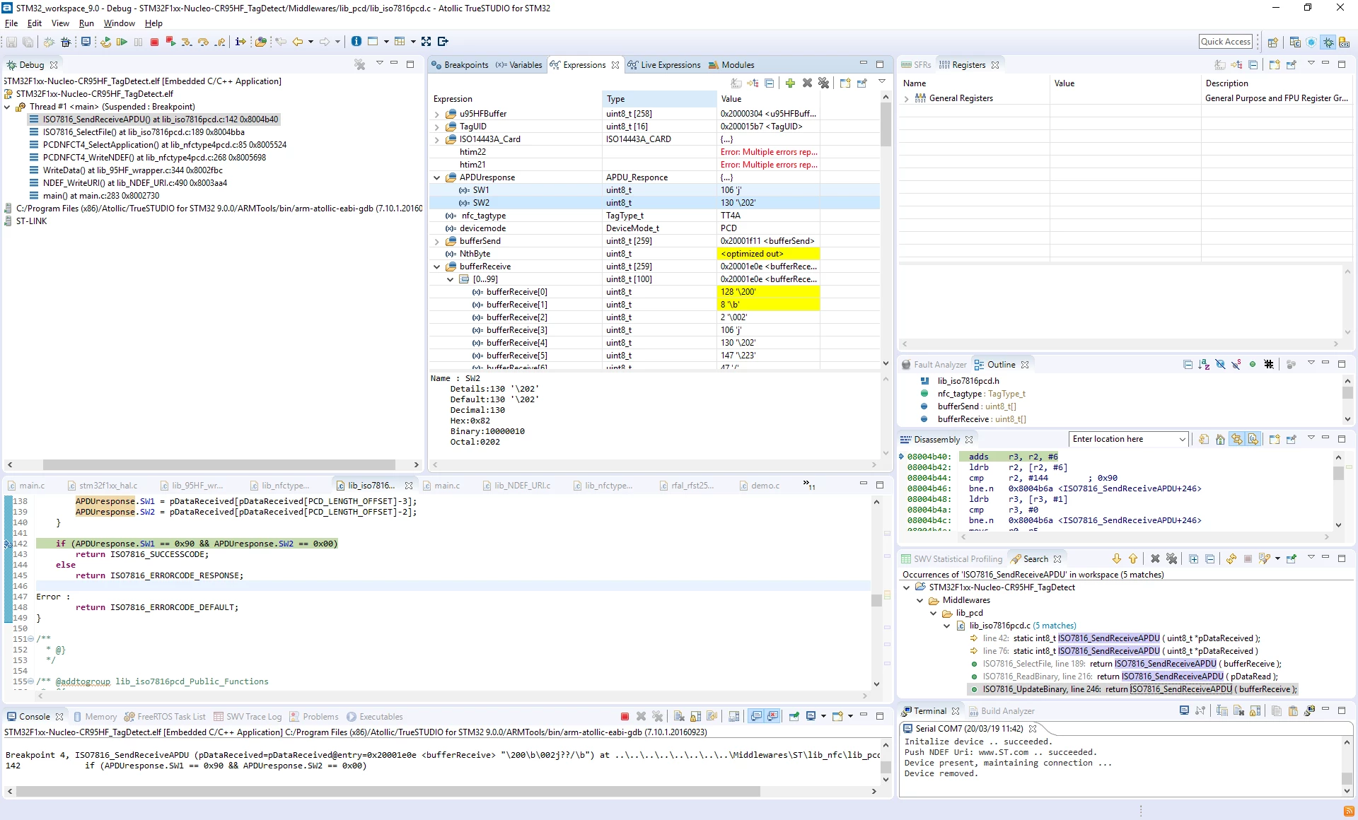

I downloaded STM32CubeExpansion_NFC3_V1.4.0.
I use the example projectCR95HF_TagDetect with the board X-NUCLEO-NFC03A1 and the board NUCLEO-F103RB.
I use smartphone Sony Xperia L1 (TT4B) an Samsung Galaxy S7 (TT4A).
I want test the function NDEF_WriteURI(&url);
the sub-function ISO7816_SendReceiveAPDU don't return the right argument.
I have always the same result .
APDUresponse.SW1 = 0x6A and APDUresponse.SW2= 0x82 instead of APDUresponse.SW1 = 0x90 and APDUresponse.SW2= 0x00.
Is this mistak cause by the smartphones or by the CR95HF or by software ?

    Hi Mickaël,
    Write_URI is an API for writing a URI in a tag supporting the NDEF application.
    As per NFC Forum Type 4 Tag Technical Specification Version 1.0 § 7.2.1 symbol 1, a Select NDEF Tag Application APDU is sent. Here, the reply from the smartphone is 6Ah 82h "NDEF Tag Application not found" which means that the NDEF application is not supported by the smartphone. Usually, smartphones emulates NFCA or NFCB tags for payment applications, not for the NDEF application.
    If you want to use Write_URI, you have to use Type 4 tags such ST25TA.
    If you want to send an URI to a smartphone, you have to use the Simple NDEF Exchange Protocol (SNEP) which is not available in  STM32CubeExpansion_NFC3_V1.4.0
    Feel free to give more information about your application, in particular why you need to send an URI to a smart phone.
