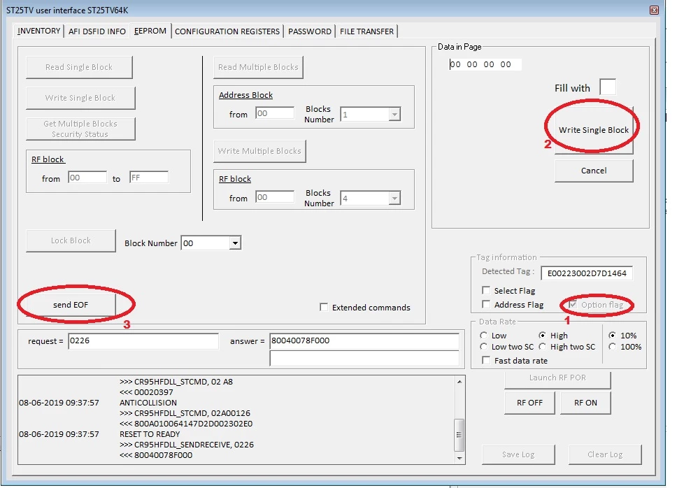

Why doesn't the M24LR Discovery (with CR95HF) WRITE to a Texas Instruments Tag?
We have some legacy TI tags in our ecosystem - (TI RI-I02-112A-03). The M24LR will read them. Our TI reader will READ and WRITE to them, but the M24LR will not WRITE to them. We see a '0000 (03) Option is not supported' message in the ISO15693 UI window.

    ​Hi,
    such tags require the Option_flag (bit b7 of the Request flags) in the Write-alike commands.
    Which GUI do you use? CR95 development software GUI or ST25PC-NFC GUI?

    JMcIn
    JMcInAuthor
    August 5, 2019
    We are using the CR95HF development software 2..3.1.
    Can you let me know how to set this bit through this GUI?
    Thanks,
    Jim

    ​Hi Jim
    The ISO15693 menu of the CR95HF development software is mostly designed for reading ST tags. Anyway, when using for example the ISO15693->ST25TV64K-->EEPROM menu, you can tick the Option flag check box.  In that case, the next command will sent with Option flag bit being set.
    Note: when option flag is set in Write-alike commands (write, lock, etc.), tags will delay their response until an isolated EOF is received (the purpose of this is to give more time to the tag for executing EEPROM write operation). In that case, the tag will not respond to the write command and a timeout will be returned by the CR95HF. The tag response will be received when using "send EOF".
    Basically:
    1. tick the Option flag check box
    2. click Write Single block, enter your data and write the block.
    3. Send EOF to read the tag response
    08-06-2019 09:56:27	WRITE SINGLE BLOCK
    			>>> CR95HFDLL_SENDRECEIVE, 42210100000000
    			<<< 8700 : Frame wait time out OR no tag
    08-06-2019 09:56:30	SEND EOF
    			>>> CR95HFDLL_STCMD, 010400
    			<<< 80040078F000
