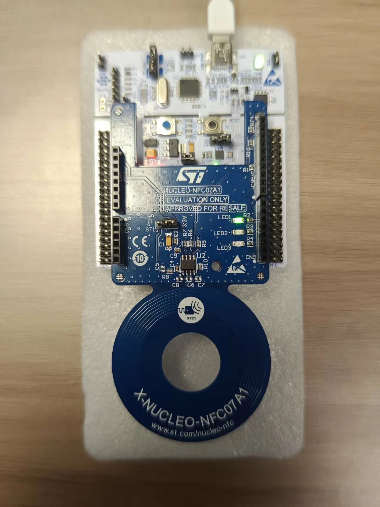

I'm developing a new secret card project using STM32L476RG and X-NUCLEO-NFC07A1 board,
I plan to let the secret card to store private key and do signature related tasks. I'm not sure where can I get blank card which contains the same MCU with STM32L476RG) and the same NFC7 with X-NUCLEO-NFC07A1? I found there are blank card in sale support NFC ISO 14443 protocol. Seem the NFC7 using ISO 15693 protocol. So the NFC blank card support support ISO 15693 protocol can run my image, as showed in image below?
Thanks

nice project, thanks for sharing it.
The X-NUCLEO-NFC07A1 board is based on ST25DV‑I2C (ISO 15693 / NFC‑V tag).
This device is an NFC/RFID memory tag with I²C interface, not a microcontroller.
The STM32L476RG on your NUCLEO board runs your firmware, while the ST25DV is only used as a contactless memory (EEPROM) that can be accessed either:
  • from the STM32 via I²C, and
  • from an NFC reader / phone via ISO 15693 (NFC‑V).
Because of that:
  1. There is no “blank card” that contains the same MCU + NFC7 circuitry.
    The combination “STM32L476RG + ST25DV” is a board design, not a standard NFC card product.
  2. Standard NFC cards using ISO 14443 (NFC‑A/B) are not compatible with your current firmware/example, which targets ISO 15693 (NFC‑V).
    An ISO 14443 card cannot be used as a drop‑in replacement for the ST25DV‑I2C tag.
According to your security requirements level, you may consider using a ST25TA-E Secure Tag or adding a secure element (e.g. STSAFE authentication and secure data management services device) to your design.

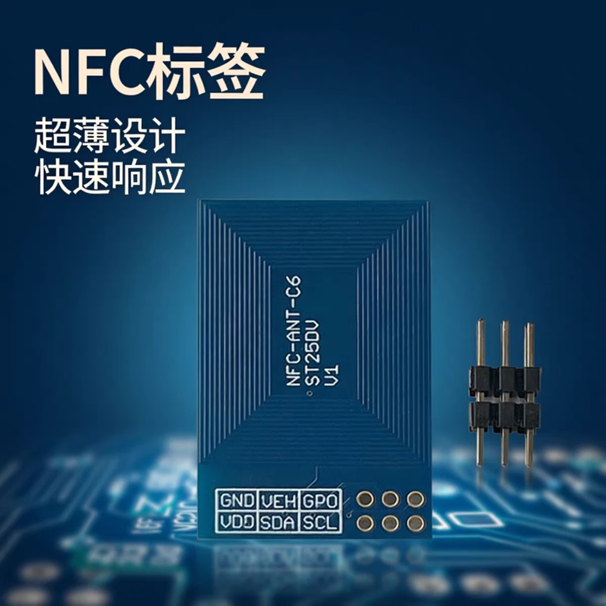

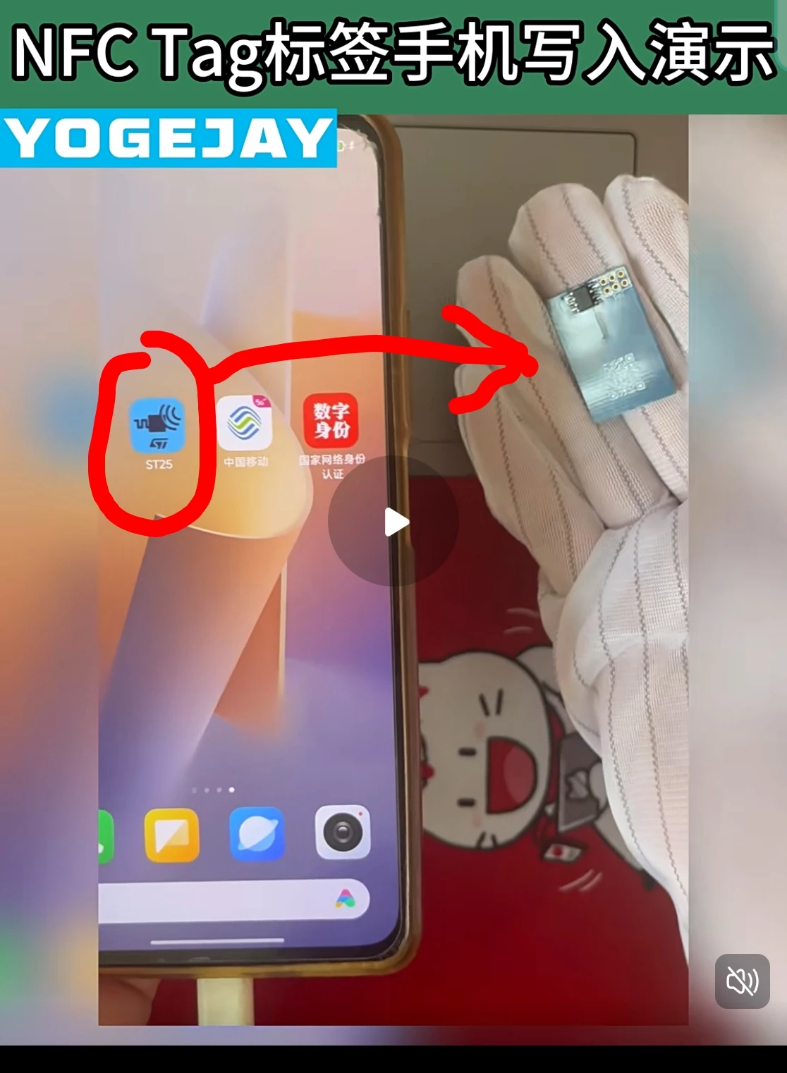

As you mentioned the ST25TA-E Secure Tag, I found the similar NFC module which can use ST25 APP to write/read NFC tag by NDEF.
The NFC module parameter:

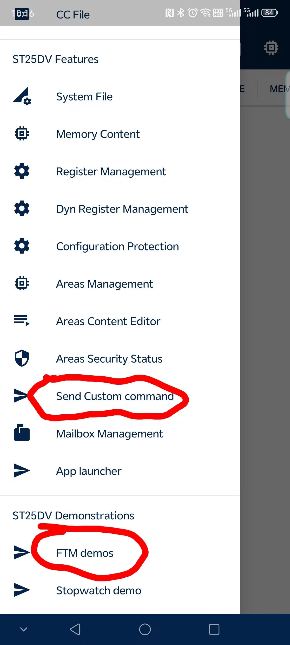

Is this NFC module can communicate with ST25 app by mailbox to "Send Custom command" or even use "FTM demos" to exchange massvie data over 256 bytes?
BRs
Jack Ding

January 27, 2026
As soon as a ST25DV is connected through I2C to an MCU running the FTM protocol, the ST25 App FTM demo can be used.
So, make sure to connect the needed pins from the module to your MCU and run the FTM protocol FW on the MCU.
Rgds
