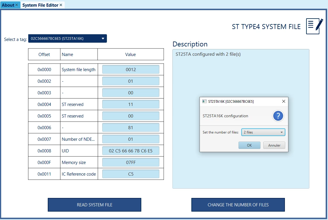

    When you go in system file editor and you click on the number of ndef file, you can change this number.
    My question is not if I can put multiple ndef records into one ndef message, but if you can create multiples ndef files, in order , in each ndef files, create an ndef message with multiple ndef records.

    just looking at the GUI I find on v2.6.1:
    1. System File Editor (Tags->ISO14443a/Type4A->System File Editor) only a dialog which allows to display the content of the system file0693W00000Nr1wxQAB.png
    2. ST Type4 Access Rights Management (Tags->ST25TA->Access Rights Management) has a combobox to select an NDEF file but has only one file selectable.
    If you find different please let me know / share screen shots.
    To my knowledge the number of ndef files is fixed to one but I am more on the reader side. Likely . @Olivier L​ can give a definite answer.
    BR, Ulysses

    When i'm in the same window as you, system file editor, if I click on number of NDEF(version for you ?), I can change the number of NDEF files.
    If I can manage to create multiple NDEF files on the ST app, I suppose that it is possible to create more than one.
    Maybe @Olivier L​ could help us if he cans, thanks.

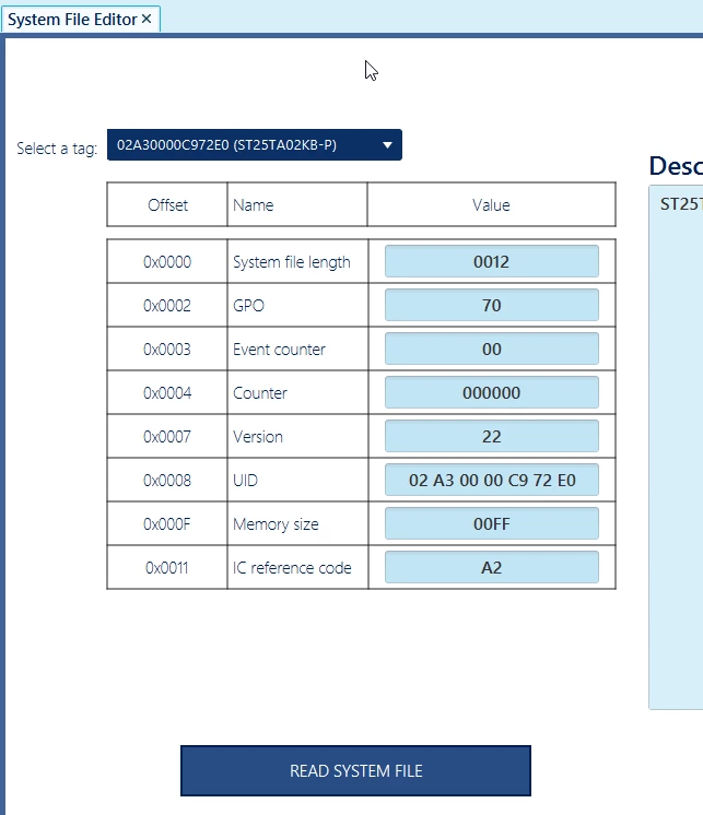

    The ST25TA02KB only contains one file. Due to the structure of it memory, only one file can be used. No way to define several files.

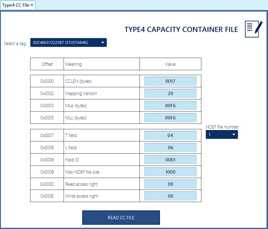

    The ST25TA16K and ST25TA64K products (same for M24SR products ) have a different memory structure that allow to divide the memory in 1 to 8 separate files. In the System file, the "Number of NDEF file" field defines the number of files of the tag. For example on ST25TA16K : '0' means 1 file (file name = 0001 size=16k) , '1' means 2 files (1st file name = 0001 size 8k, 2nd file name = 0002 size = 8k) etc ... .
    Reading CC File will give you all the information concerning each file (File name, max file size, access rights).

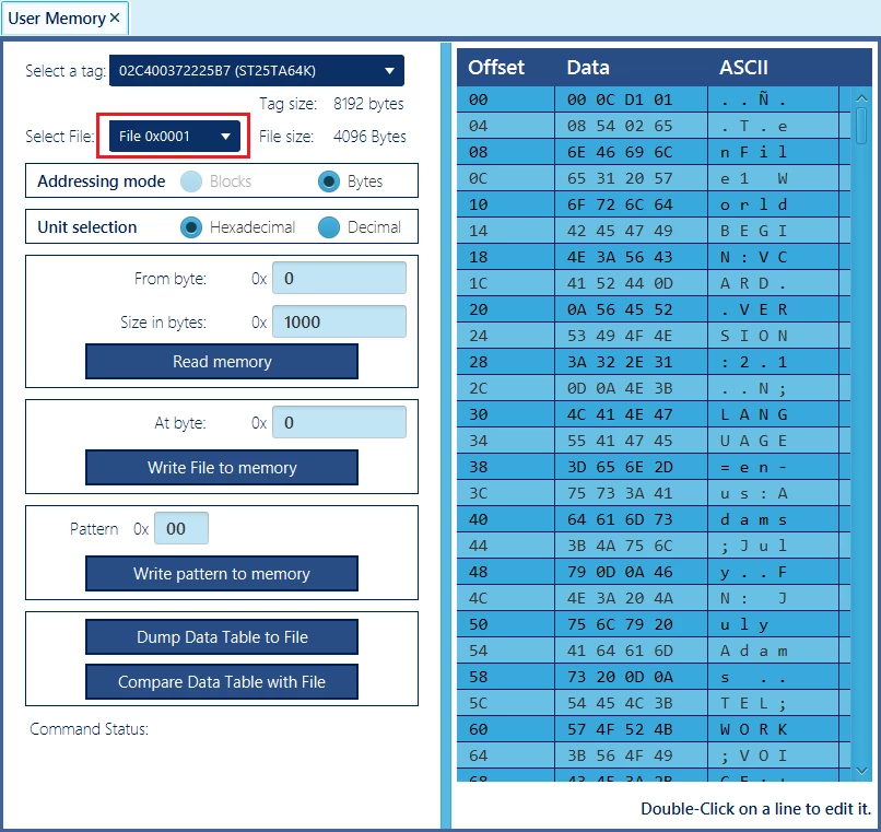

    0693W00000Nr9n5QAB.pngTo read, write each file, you can use User Memory user interface :

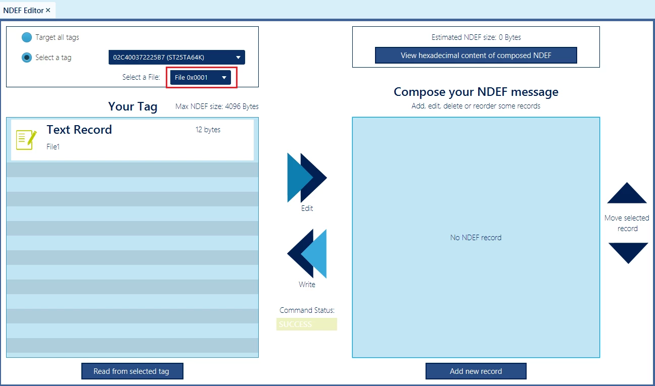

    0693W00000Nr9nKQAR.pngTo read or to write NDEF file in each File, you can use the NDEF Editor :
    0693W00000Nr9neQAB.pngBut again, only ST25TA16K, ST25tA4K and M24SR series can manage several files.

    It is weird because, on the application, with a st25ta 2k it is possible to create multiple files, but maybe i've done a strange manipulation.
