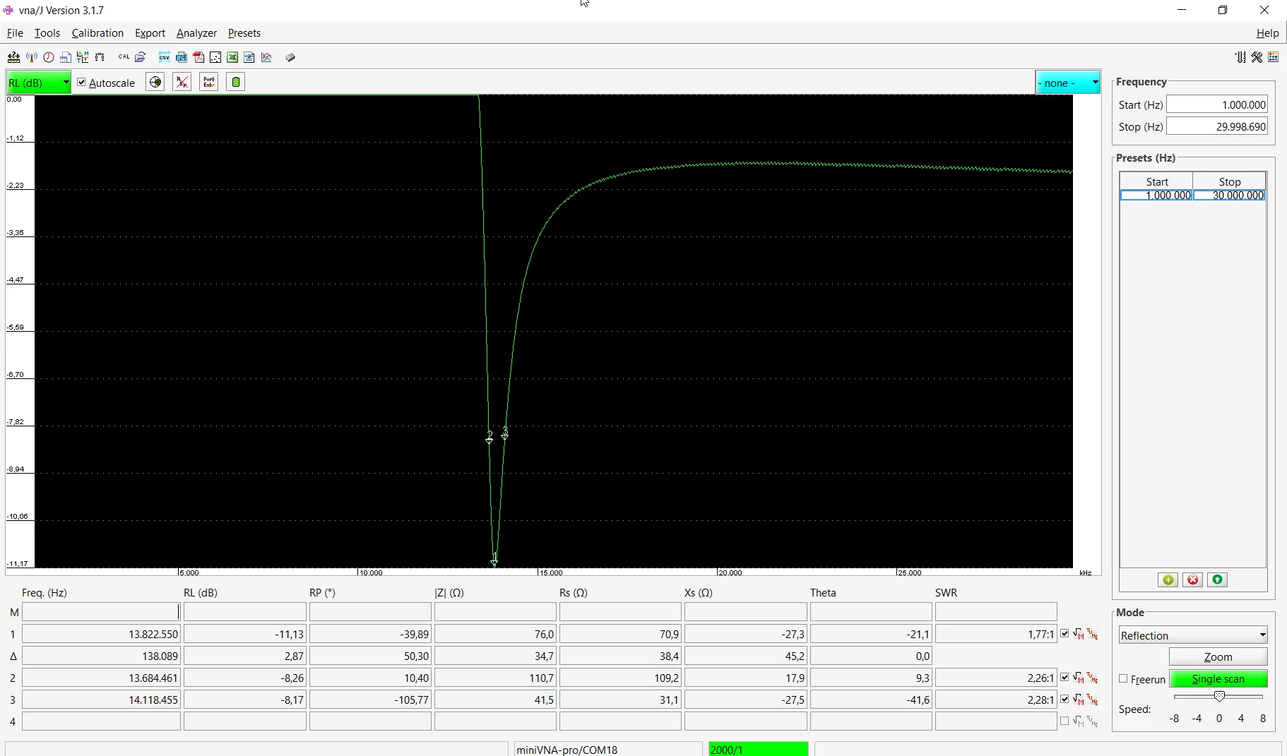

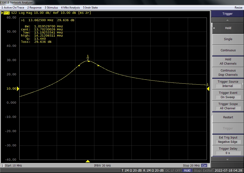

I have captured two traces: first one is taken with our Keysight VNA:
0693W00000QLRpWQAX.pngThe second one is captured with the miniVNA pro:
0693W00000QLRq5QAH.pngYou can use this pictures to compare the two results. Both use the same antenna and same tag on top.
The miniVNA is missing the Z-conversion. But i assume you can export the S-parameter and do the conversion externally.

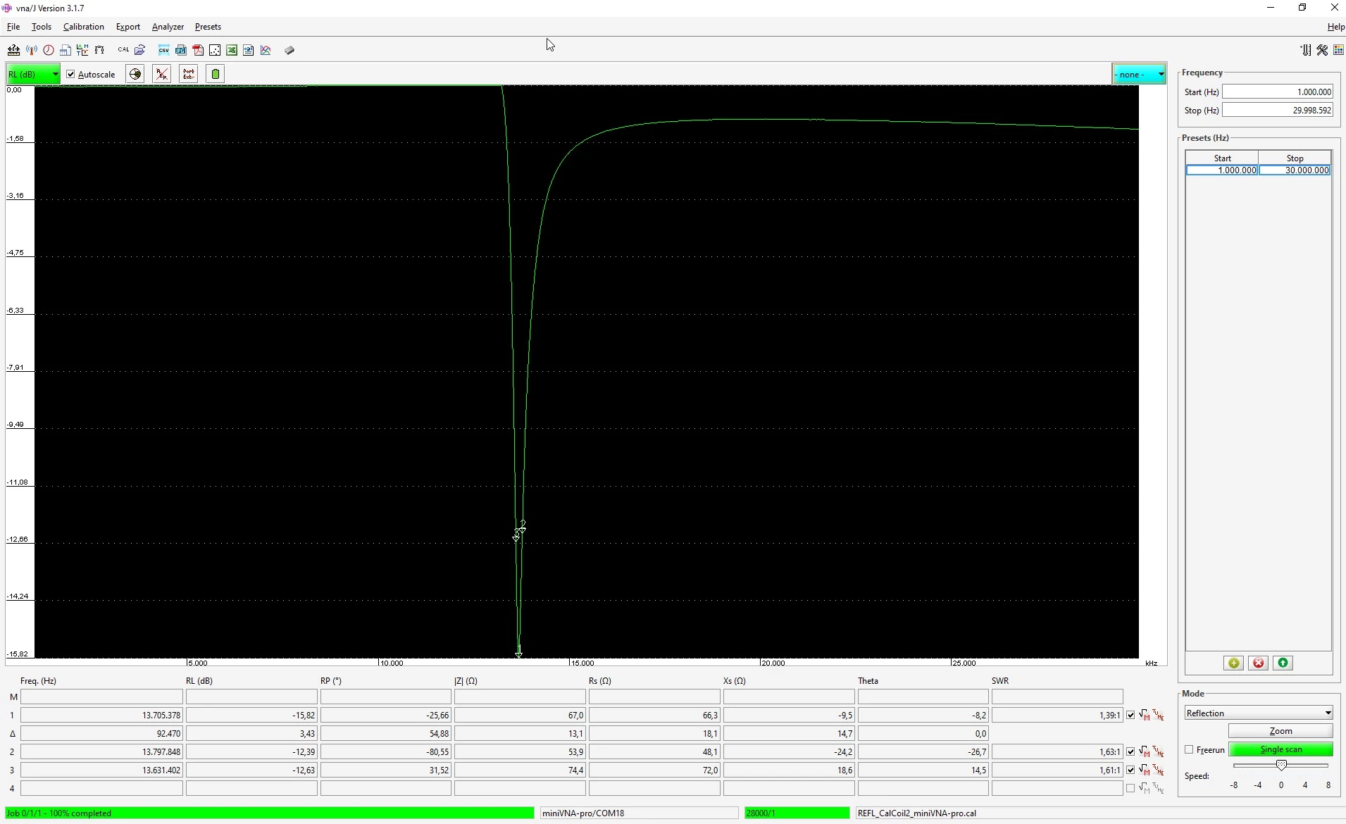

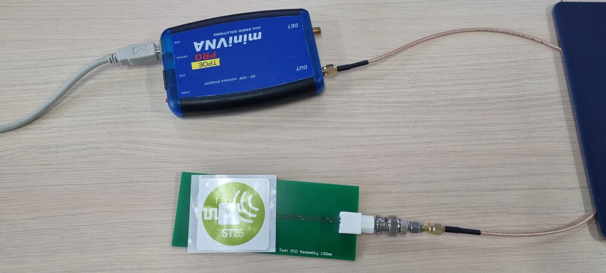

Travis Palmer
June 24, 2022
Hello Ted,
i had another look with my colleague.
If you replace the short during OSL calibration by the antenna, you can sense the resonance frequency of the tag.
I can crosscheck the results next week, once I have access to our VNA again.
Below a picture of my setup + measurement result.
br Travis

I also have trouble measuring the Q factor of an antenna with a MiniVNA Pro. In your last message, you provide 2 screenshots for which I would like some precisions :
  • The first one is, according to the display, S22. So when does the conversion to Z:Reflection mentioned in the AN4974 steps in ? I also assume that S22 is equivalent to S11 in your setup, is it true ?
  • The second one is the Return Loss which is related to the S11. You advise to convert it to Z-parameter, but to do so you need S21, S12 and S22 (see formula below).
This last point on S21 is true for both. According to the Agilent E5061A/E5062A ENA Series RF Network Analyzers User’s Guide, Zreflection is a function of Sab (see image below), which is S21 to me.
0693W00000QM9npQAD.pngMy question is : did you perform a transmission measure ? How ?
