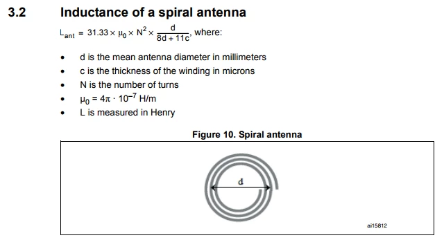

By the document AN2972(How to design an antenna for dynamic NFC tags),In section 3.2 Inductance of a spiral antenna
,there is a calculation formula about a spiral antenna.As follow,
those parameters are:
d = 40mm
N = 8
c = 35um
The result of inductance is   1.7870e-05H.
It is not 4.5uH,Why? because capacitance of st25dv04 is 28.5 pf.
For the ST25dv series,what is the best inductance of antenna? 4.5uH or not?

    Henry Crane
    January 21, 2019
    ​Hello Liu,
     you are right, there is an error in the document and a misleading information in the description:
    the right formula is:
    L=31.33.µ0. N².a²/(8a+11c) where:
    • a is the mean radius of the spiral a=(ri+ro)/2 where ri is the inner radius and ro is the outer radius of the coil
    •  and c = ro-ri, representing the width of the space occupied by the turns or the summ of turns width and turns spacing . In some literature dealing with stacked windings, it is called the thickness of wires, so sorry for the confusion)
    with new formula and a=22mm and c=10mm, it comes L= 4.26µH which is more in line with what is expected.
    Please keep in mind that this formula only estimates the self inductance of the coil and not the stray capacitance. Because of the self resonnance frequency caused by the presence of this stray capacitor (few pF generally), the actual  imaginary part of coil impedance is higher than 4.26µH*2*pi*13.56MHz. Finally coil impedance imaginary part is close to 4.7µH which is the chip impedance complex (28.5pF) close to 13.56MHz.
    Don't hesitate to contact us for more information,
    best regards,
    HC.

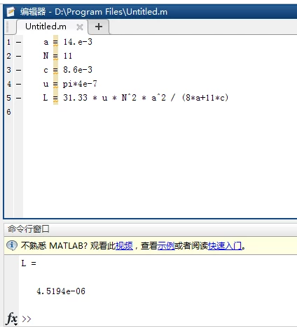

    0690X000006DC4vQAG.pngthank you again;According to your formula above,I designer a single layer antenna in PCB, Please help me check what is wrong?
    a = 14mm; N = 11; c = 8.6mm; u0; ri = 9.7mm; ro = 18.3mm.
    Conductor: width = 0.6mm; spacing = 0.2mm; thickness = 35um.:*

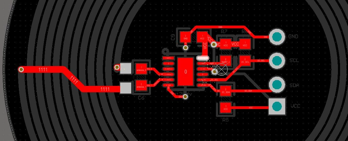

    Henry Crane
    Henry CraneBest answer
    January 22, 2019
    ​Hello Liu,
    nothing particular to say about spiral parameters, they sound good to me.
    concerning the schematic: you can remove C8 and C7 (they could be used to improve EMI robustness but are useless in your case. For same reason you can remove R10. It will simplify layout. Outer via of coil routing can be simplified too.
    You'll find a quick and dirty illustration, just as an example, of these recommendation in the picture here attached.
    Some additional optimization of the SCL, SDA , GP0 pull up resistors and C9 decoupling cap placement may be possible.
    BR,
    HC.
    Henry Crane
    January 22, 2019
    ​Hello Liu,
    some connections are laking in you original design between spiral and ST25DV coil pads AC0/AC1 (I did not fix it in layout example above).
    BR
    HC.

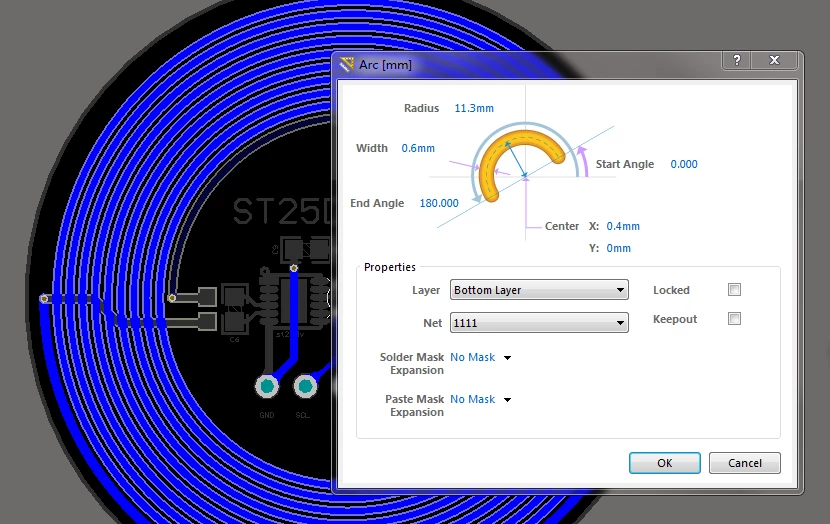

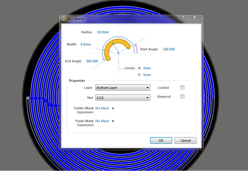

    January 23, 2019
    Hi HC,
    Thank you for your professional reply.!
    Today I modify antenna parameter. As follow Figs, It shows how to test ro and ri value. Is it right?
    By this way, ro = 18.9 mm, ri = 11.3 mm, N =10, ==> L = 4.4uH.As follow
    By those spiral parameter, the PCB file is attached. Pls help me check again.
    Thank you very much!
    BR,
    Liu
    Henry Crane
    January 23, 2019
    ​Hello Liu,
    Antenna is OK for me.
    Concerning the Layout/schematic: maybe my comments are not relevant if your project is still under development but you do not use LPD pin:
    • GPO pin is connected to Vcc thru a pull-up resitor while it is a  CMOS output ->  no need for pull up resitor contrary to 8-pin version of ST25DV-I²C where GPO is open-drain.
    • I note also that GPO is not connected to any PCB IO.
    • Why not switch to 8-pin version of the ST25DV-I²C?
    best regards,
    HC.
