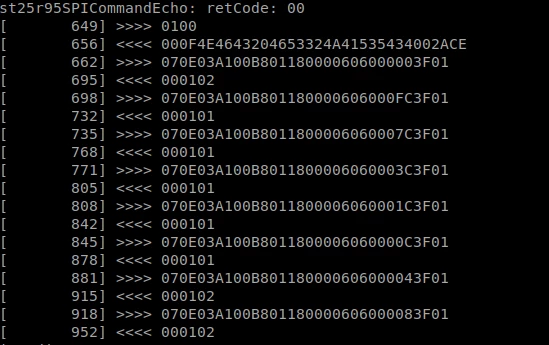

    Hi Brian,
    Yes the datasheet I used was old. I have changed the command to {0x07, 0x0E, 0x0A, 0x21, 0x00, 0x38, 0x01, 0x18, 0x00, 0x20, 0x60, 0x60, 0x74, 0x84, 0x3F, 0x00};
    and Implemented the demo.c example in my project I just removed the button press in democycle function. The values 0x64 and 0x74 I have copied from an old datasheet, I am not sure about the DacDataL and DacDataH bytes. How do I get them do I need to calculate them?
    If I set the discParam.wakeupEnabled = true the current drops to 400uA and it is always in state RFAL_NFC_STATE_WAKEUP_MODE and can't wake up the device.
    If discParam.wakeupEnabled = false I can detect a tag but the current is to high
    Also I have checked st25r95CalibrateTagDetector() everyting seems ok I am getting ERR_NONE. Currently I don't have the X-NUCLEO-NFC03A1 board.
    This is the output from st25r95CalibrateTagDetector0693W000007CDC9QAO.pngRgds Suad
    Brian TIDAL
    January 21, 2021
    st25r95CalibrateTagDetector() returns the Dac Reference Value (DacRefValue). This DacRefValue is used to derive the detection guard band [DacDataL; DacDataH]:
    • DacDataL = DacDataRef – Guard and ,
    • DacDataH = DacDataRef + Guard,
    • with a recommended Guard value of 2 DAC steps (i.e. 8).
    See 5.9.5 Tag detection calibration procedure in the ST25R95 datasheet.
    The Dac Reference Value is stored in gRFAL.wum.CalTagDet during rfalInitialize().
    So you should not use hard coded value in st25r95Idle(), but you should use (gRFAL.wum.CalTagDet - 8U) and (gRFAL.wum.CalTagDet + 8U) as in the rfalWakeUpModeStart() reference code.
    I had a look to your output of st25r95CalibrateTagDetector and if I am not wrong the returned value is 0x08. This looks very strange to me. Can you make sure to run the calibration procedure with no tag within the antenna RF operating volume? Is there any shielding or ground plan under the antenna?
    Rgds
    BT
