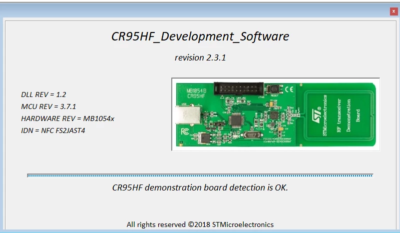

Brian TIDAL
September 5, 2023
also make sure to have the latest HW revision of the board. When starting the CR95HF development software, you should see something like:
The IDN should be "NFC FS2JAST4"
Rgds
BT
