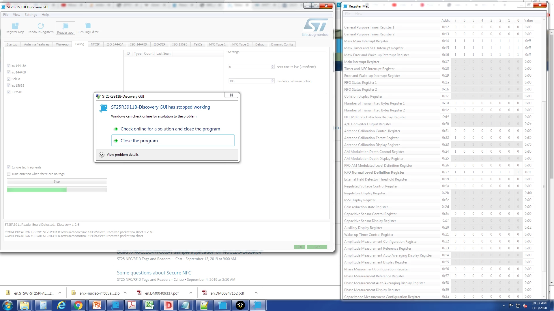

Using the ST25R3911B Disco GUI, we are seeing the message "ext field detected, not polling" in the status window. What does this mean?

We are trying to increase the read distance by adding an RF amplifier, routing the "Rx" chain through an external divider to RFI1&2. We cannot find any reference to this message in any of the docs or source code we have. Has anybody experienced this?

    CFerr.1
    CFerr.1Author
    January 13, 2020
    Thanks for the reply. I see two types in reg 0x30, Peer & Collision. I suspect this has something to do with how we are trying to handle Rx when using the amplifier for increased read distance. We have limited the RFI through the divider but something is still wrong. With the GUI, we can get reads but within a few seconds, the GUI crashes. We restart and all is good until we attempt to read again. If we disconnect the RFIs, the GUI runs continuously. Using a differential probe on the RFI, I do not see any overdriving. the A/D values never approach saturation that I can see. Any ideas as to what might be causing the app to stop? We are running version 1.2.8.0.

    it may happen that if in ISO15693/NFC-V the receiver gets completely flooded then the anticollision takes several seconds. The GUI times out after max 1 second so it may be this timeout. This shouldn't happen when disabling NFC-V in e.g. Polling Tab.

    CFerr.1
    CFerr.1Author
    January 13, 2020
    I am using polling as shown in the attached. The crash happens pretty quickly and on this last attempt, I had FF in reg 0x27 just to see if no Tx power would allow the GUI to keep running. But the flooding hypothesis is what I was considering. I do have a differential probe on the RFI signals and do not see anything significant there. I will look at the SPI & IRQ sigs next.
