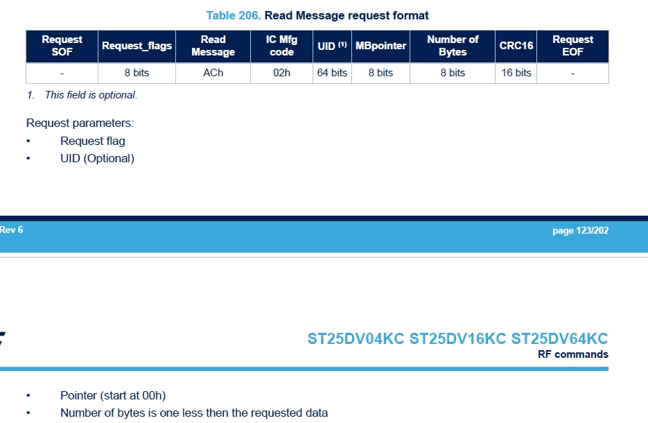

2025-05-12 08:32:09.483 12263-19515 Iso15693CustomCommand   com.wavecontrol.mtiotmobileapp       D  ==> Send readMsg command: 22 ac 02 7f 46 b6 7c 67 51 02 e0 00 ff
2025-05-12 08:32:09.588 12263-19515 Iso15693CustomCommand   com.wavecontrol.mtiotmobileapp       D  Response: 00 02 7b 22 6a 73 6f 6e 72 70 63 22 3a 22 32 2e 30 22 2c 22 72 65 73 75 6c 74 22 3a 22 54 30 36 3a 31 34 3a 34 35 2e 33 30 36 20 52 65 63 65 69 76 65 64 20 67 65 74 5f 69 6e 66 6f 5f 6d 65 61 73 75 72 65 5c 6e 5b 49 5d 20 32 30 32 35 2d 30 35 2d 31 32 54 30 36 3a 31 34 3a 34 38 2e 37 32 31 20 4e 46 43 20 73 65 73 73 69 6f 6e 20 73 74 61 72 74 5c 6e 5b 49 5d 20 32 30 32 35 2d 30 35 2d 31 32 54 30 36 3a 31 34 3a 34 38 2e 37 32 32 20 52 65 73 74 61 72 74 65 64 20 6f 6e 65 2d 73 68 6f 74 20 74 69 6d 65 72 20 4e 46 43 20 73 65 73 73 69 6f 6e 20 74 69 6d 65 72 20 77 69 74 68 20 74 69 6d 65 6f 75 74 20 31 30 30 30 30 20 6d 73 2e 5c 6e 5b 49 5d 20 32 30 32 35 2d 30 35 2d 31 32 54 30 36 3a 31 34 3a 34 38 2e 37 32 37 20 52 65 63 65 69 76 65 64 20 67 65 74 5f 69 6e 66 e4

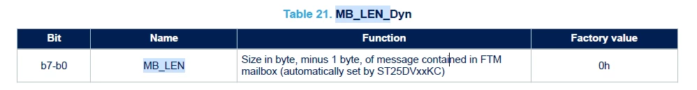

As can be seen, the retrieved message length is 255, which according to the datasheet is the size of the message in the mailbox - 1.
Then I issue a readMsg command passing it the 0xff, so it should read 0xff + 1 bytes
But at the end I get that 0xe4, which I'm confident wasn't put by the host side. As a result I lose one byte.

The ST25DV64KC is able to transmit a frame that contains the 256 bytes of data from the mailbox,
But is the phone capable of receiving such a long frame?
When transmitting 256 bytes of data from tag to phone, the frame size will be 256 bytes long (256 byte of data + 1 byte of response flag + 2 bytes of CRC).
If the phone's receive buffer is 256 Bytes size, there is a risk that last bytes of data cause an overflow.
So maybe you can check the phone capabilities regarding received frame size.
Best regards.
