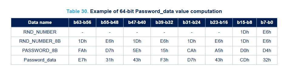

I am encountering a persistent issue while attempting to program a new password for the user memory in AREA1 of an ST25TVxxXC NFC tag using an ST25R200 reader and the RFAL library.
I have followed below procedures for setting the password:
  1. Get a 2-byte Random Number from the tag using rfalST25xVPollerGetRandomNumber() api.
  2. XOR the desired 64-bit password with the obtained Random Number, as per table 30 of ST25TV02KC datasheet
  3. Use the PresentPassword command to enter secure session mode with default password {0,0,0,0,0,0,0,0} using rfalST25xVPollerPresentPassword() api.
  4. Use the WritePassword command to set the new password using rfalST25xVPollerWritePassword() api.
I have written a local function to perform XOR operation and confirmed that the XORed output matches as per below table of ST25TV02KC datasheet:

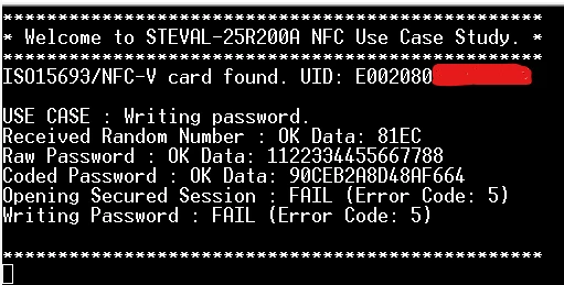

However, I am unable to successfully enter the secure session using present password api, consistently receiving RFAL_ERR_REQUEST (invalid request or requested function can't be executed at the moment).
Below is the debug prints on Tera Term terminal:
Any guidance, insights into common pitfalls, or suggestions for further debugging would be greatly appreciated.

and below is the debug prints captured on tera term terminal:
Please let me know if i missed anything.
I would like to confirm my understanding: In order to set a new password for AREA1 on a fresh tag, we must first open the USER_AREA1_SECURITY_SESSION using the default password, after which the new password can be written.

May 30, 2025
Hi Tanuj,
if a "fresh ST25TV02KC" is being used, the password factory value is 0000000000000000 and likely not 1122334455667788. See Table 19 in ST25TV02KC datasheet for the factory value. Presenting a 1122334455667788 XOR'ed password instead of a 0000000000000000 XOR'ed password will not work. Presenting a non-XOR'ed password (as in line 22 of your initial code snipped: default_pwd is a non-XOR'ed password) will not work as well.
See also section 5.1.2 Password management and table 26 regarding the update of PWD_A1.
Just XOR the factory password and present the XOR'ed value.
Rgds

May 30, 2025
Hi Tanuj,
in case of PWD_A1, pwdLengthInBytes should be 8 not 4 (this is 4 in case of PWD_CFG) and line 17 should be replaced by:
	for (uint8_t i = 0; i < pwdLengthInBytes; i++)

June 5, 2025
Hello Brian,
Apologies for the delayed response. Thanks for the fix—it worked.
I am now able to set and modify the password.
