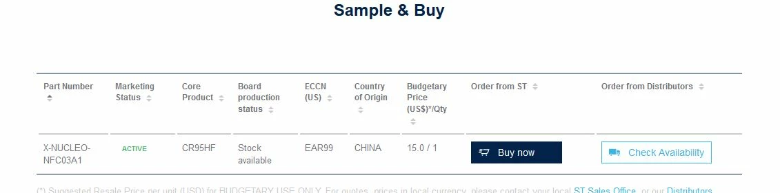

I would like to buy a X-NUCLEO-NFC03A1 with the chip ST25R95-VMD5T. On ST website, it looks like there is two references of this evaluation board, one with the ST25R95 chip, and another one with the CR95HF chip: 0693W000001qhliQAA.jpg
I can't find a supplier for the eval board with the ST25R95 chip. Even on the ST web page, we can find only one reference:
Why the nucleo with the st25r95 core is not available ?

    Hi Emilien,
    see https://community.st.com/s/question/0D50X0000AyB7p3/can-anyone-confirm-that-stm32l476rgnucleo-binary-located-in-cstm32cubeexpansionnfc3v200projectsstm32l476rgnucleoapplicationspollingbinary-does-support-cr95hf- for similar question.
    You can use the X-NUCLEO-NFC03A1 for your ST25R95/CR95HF developments. ST25R95 and CR95HF are just ordering variant. ST25R95 is recommanded for new designs based on SPI communication and/or based on Card emulation feature. I would suggest you contact your local ST sales representative for a quote for ST25R95. CR95HF can be ordered for existing designs.

    Oh, I miss this thread, thanks for your answer !
