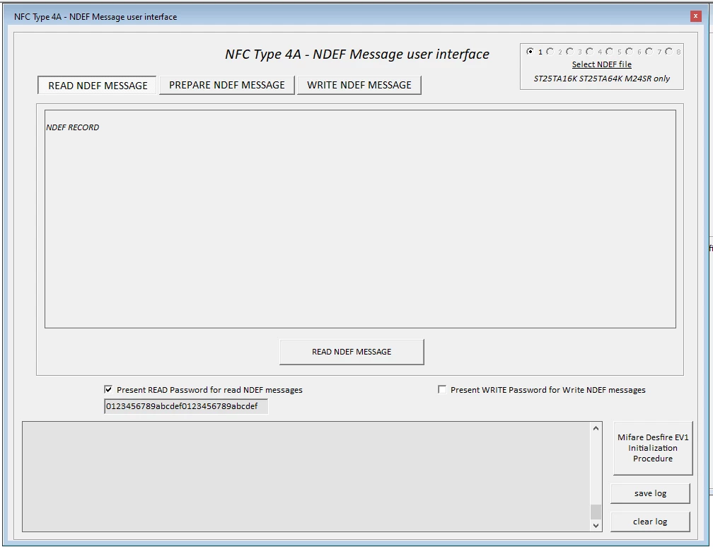

I have downloaded en.x-cube-nfc5 project from:
st(site)/en/ecosystems/x-nucleo-nfc05a1_html
I have connected the X-NUCLEO-NFC05A1 Shield to one of my lab boards, based on STM32F103.
I managed to make the whole thing work with this example: ndef_example_read.c (see below)
I even managed to read one of my tags (NFC type 4A)
I have ST25R3911B-DISCO board too as an example
I run it with "NFC Type 4A - NDEF Message user interface"
there are two options in the supplied ST Windows software:
Present Read Password for read NDEF message
Present Write Password for write NDEF message
and with those options I can read or write my tags with a 16Bytes password length.
I need to do the same with my board (the one with STM32F103), directly connected to the ST25r3911b, and so far I can't find how to define and send those read / write passwords.

Brian TIDAL
February 9, 2023
Hi Nathanael,
you will find an rfalST25xVPollerPresentPassword() API in rfal_st25xv.c. See https://community.st.com/s/question/0D53W000004m5e4SAA/can-anyone-provide-an-example-of-api-rfalst25xvpollerreadmessage for a code example.
Basically, you should add the call to this API before ndefPollerContextInitialization.
If this answers to your question, would you please "select as best answer". Otherwise feel free to ask more information.
Rgds
BT

Brian TIDAL
February 9, 2023
Hi Nathanael,
it seems you are using a Type 4A tag. My previous answer is related to a Type V tag. Sorry for the confusion. Can you confirm you are using a ST25TA tag?
If you are using a ST25TA tag, basically you have to send a Verify command. This should be done after selecting the NDEF file. I would suggest to modify the ndefT4TPollerNdefDetect() just after the NDEF file select command (see comment /* Select NDEF File TS T4T v1.0 7.2.1.9 */ and ndefT4TPollerSelectFile() call in ndefT4TPollerNdefDetect).
As there is no API to send the verify command, you'll have to compose the APDU and to send it. I would suggest to get inspiration from one of the existing command (such as ndefT4TPollerReadBinary) to compose the APU and then you just need to use ndefT4TTransceiveTxRx to transmit it.
Feel free to share your modifications if you face some issue.

Nathaniel Arzoine
Nathaniel ArzoineAuthorBest answer
February 14, 2023
Thank you a lot
I finished writing my code, I made a few little changes in additions to yours @Brian TIDAL_O​ :
I add 2 function call, that get the read pass arr and the write pass arr, from my code:
GetReadPassword_p();
GetWritePassword_p();
I also added:
ret = ndefT4TPollerManageAccessRight(ctx, false); // write password
at the end of the call to gives access to write too
The file ndef_t4t.c looks like that now:

  if( !read && (pwd == NULL) )
    return ERR_PARAM;
  ndefT4TInitializeIsoDepTxRxParam(ctx, &isoDepAPDU);
  ret = ndefT4TPollerComposeVerify(isoDepAPDU.txBuf, read, pwd, (pwd == NULL) ? 0x00 : 0x10, &isoDepAPDU.txBufLen);
  if( ret == ERR_NONE )
    ret = ndefT4TTransceiveTxRx(ctx, &isoDepAPDU);
  return ret;
static ReturnCode ndefT4TPollerManageAccessRight(ndefContext *ctx, bool read)
uint8_t* readpwd = GetReadPassword_p();
uint8_t* writepwd = GetWritePassword_p();
  if(read)
return ndefT4TPollerVerify(ctx, read, readpwd);
return ndefT4TPollerVerify(ctx, read, writepwd);
ReturnCode ndefT4TPollerNdefDetect(ndefContext *ctx, ndefInfo *info)
  ReturnCode      ret;
  uint8_t*       nLen;
  uint8_t       nlenLen;
  if( info != NULL )
    info->state        = NDEF_STATE_INVALID;
    info->majorVersion     = 0U;
    info->minorVersion     = 0U;
    info->areaLen       = 0U;
    info->areaAvalableSpaceLen = 0U;
    info->messageLen      = 0U;
  if( (ctx == NULL) || !ndefT4TisT4TDevice(&ctx->device) )
    return ERR_PARAM;
  ctx->state = NDEF_STATE_INVALID;
  /* Select NDEF Tag application TS T4T v1.0 7.2.1.1 */
  ret = ndefT4TPollerSelectNdefTagApplication(ctx);
  if( ret != ERR_NONE )
    /* Conclude procedure TS T4T v1.0 7.2.1.2 */
    return ret;
  /* TS T4T v1.0 7.2.1.3 and following */
  ret = ndefT4TReadAndParseCCFile(ctx);
    return ret;
  nlenLen = ( ndefMajorVersion(ctx->cc.t4t.vNo) == ndefMajorVersion(NDEF_T4T_MAPPING_VERSION_3_0) ) ? NDEF_T4T_ENLEN_LEN : NDEF_T4T_NLEN_LEN;
  /* TS T4T v1.0 7.2.1.7 verify file READ access */
  if( !(ndefT4TIsReadAccessGranted(ctx->cc.t4t.readAccess)) )
    /* Conclude procedure TS T4T v1.0 7.2.1.8 */
    return ERR_REQUEST;
  /* File size need at least be enough to store NLEN or ENLEN */
  if( ctx->cc.t4t.fileSize < nlenLen)
    return ERR_REQUEST;
  ret = ndefT4TPollerSelectFile(ctx, ctx->cc.t4t.fileId);
    /* Conclude procedure TS T4T v1.0 7.2.1.10 */
    return ret;
  /* READ Access right management */
  ret = ndefT4TPollerManageAccessRight(ctx, true); // read password
    return ret;
  /* Read NLEN/ENLEN TS T4T v1.0 7.2.1.11 */
  ret = ndefT4TPollerReadBinary(ctx, 0U, nlenLen);
    /* Conclude procedure TS T4T v1.0 7.2.1.11 */
    return ret;
  nLen = ctx->subCtx.t4t.rApduBuf.apdu;
  ctx->messageLen  = (nlenLen == NDEF_T4T_ENLEN_LEN) ? GETU32(&nLen[0]) : (uint32_t)ndefBytes2Uint16(nLen[0], nLen[1]);
  ctx->messageOffset = nlenLen;
  ctx->areaLen    = ctx->cc.t4t.fileSize;
  if ( (ctx->messageLen > (ctx->cc.t4t.fileSize - nlenLen)) || ((ctx->messageLen > 0U) && (ctx->messageLen < NDEF_T4T_MIN_NLEN)) )
    return ERR_REQUEST;
  if( ctx->messageLen == 0U )
    if( !(ndefT4TIsWriteAccessGranted(ctx->cc.t4t.writeAccess)) )
      return ERR_REQUEST;
    ctx->state = NDEF_STATE_INITIALIZED;
  else
    ctx->state = (ndefT4TIsWriteAccessGranted(ctx->cc.t4t.writeAccess)) ? NDEF_STATE_READWRITE : NDEF_STATE_READONLY;
  if( info != NULL )
    info->state        = ctx->state;
    info->majorVersion     = ndefMajorVersion(ctx->cc.t4t.vNo);
    info->minorVersion     = ndefMinorVersion(ctx->cc.t4t.vNo);
    info->areaLen       = ctx->areaLen;
    info->areaAvalableSpaceLen = ctx->areaLen - ctx->messageOffset;
    info->messageLen      = ctx->messageLen;
    return ret;
  return ERR_NONE;
