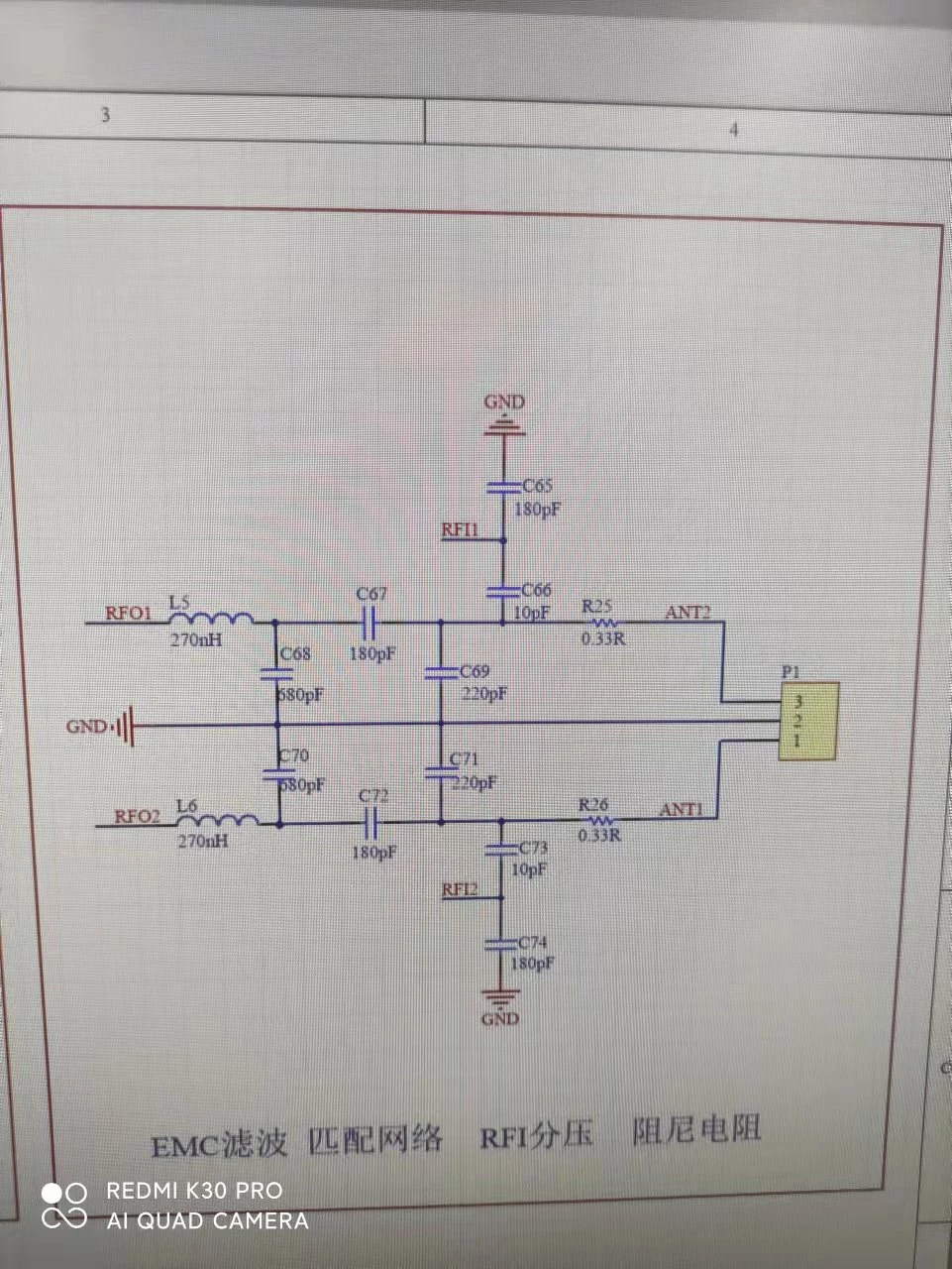

I am using ST25R3916 to make an RFID reader, but I don't know how to calculate the transmit power of its antenna. I am using a differential antenna design, as shown in the figure below:
0693W00000GWHCvQAP.jpgHope to get somebody's support.
best regards,
Lingfu
Best answer by Ulysses HERNIOSUS
Hi Lingfu,
did you study AN5276, especially chapter 3.2?
Best Regards, Ulysses
