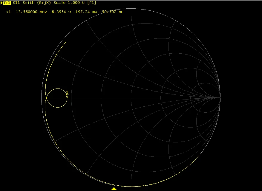

I modified one of our ST25R3916-DISCO board to ~8.4Ohm which gives a driver current around 350mA.
The supply is done via USB (~4.8 to 5V).
0693W00000LwntjQAB.pngIf selecting an in-proper setting Reg: 2Ch = 0xf8 (too less drop) and then turning on the field, the Regulator display register is showing 0xf1 => i_lim bit is "1".
When selecting an proper setting (Reg: 2Ch = 0xd0 => 4.6V), then the i_lim bit is "0".
Values above trigger the i_lim bit to "1".
(Regulator display register is showing 0xa0).
The Procedure is always: Go to "ISO 14443A" tab, press configure and modify the registers via "Register map". Read back / update the register map via "Ctrl + R"
BR Travis

(1) How did you calculate 8.4 Ohms as the impedance that would produce 350mA of output current? R = V/I, and if V = 4.8V and I = 350mA, then R should be 13.7 Ohms?
(2) I have modified the NFC06A1 to have a lower impedance than yours (~3 ohms) and set the regulator to manual 5V (2Ch = 0xf8), and still the ilim is not triggered. I would have figured that, while 3 ohms is not an optimal impedance, it would certainly draw over 350mA. Is it known why this is not the case?

Travis Palmer
April 5, 2022
Hello Oliver,
can you prepare your setup to measure the supply current?
We cannot simply do a DC operating point calculation to estimate the current consumption.
The typical NFC application has a matching network attached to the RFO pins. This matching network transforms the inductive impedance to a real ohmic load. The EMI filter is the first part of this matching network.
The EMI filter is transforming the rectangular voltage, which is outputted by the driver into a sinus shaped voltage. As a result, also the current going through the regulator is approximately sinus shaped. This is because the drivers produce a square wave voltage, but the EMC filter only passes the first harmonic.
below an example of calculating the current and also the dissipated power:
Input parameters:
VDD = 5V
Mathing Impedance = 8.4Ohm
LDO drop = 0.3V
RDRV = 1.75Ohm
IAL = 0.021A
Calculation:
PAL = VDD * IAL = 5 * 0.021 = 0.105 W
PREG = (VDD – VDDDR)*(VDDdr*1.27*0.637)/(2*RDS_on + ZLoad) = (5-4.7)*(4.7*1.27*0.637)/(2*1.75+8.4)
PREG = 0.0959W
VREG = (VDD-0.3)/2*1.27 = (5-0.3)/2*1.27 = 2.9845 V
IPEAK = (2*VREG)/(2*RDS_on+Zload) = (2*2.9845)/(2*1,75+8,4) = 0,501A
IAVG = IPEAK*0,637 = 0.501*0.637= 0,32A
PDRV = (IPEAK²/2)/(2*RDS_on) = (0,501^2/2)*(2*1,75)=0.439W
The total dissipated power of the device is then:
PTOT = PAL + PREG + PDRV = 0.105 + 0.0959 + 0.439 = 0.64W
The DC current (IAVG) is in this case around 320mA.
For triggering the i_lim bit, it is important to turn on the field.
BR Travis
