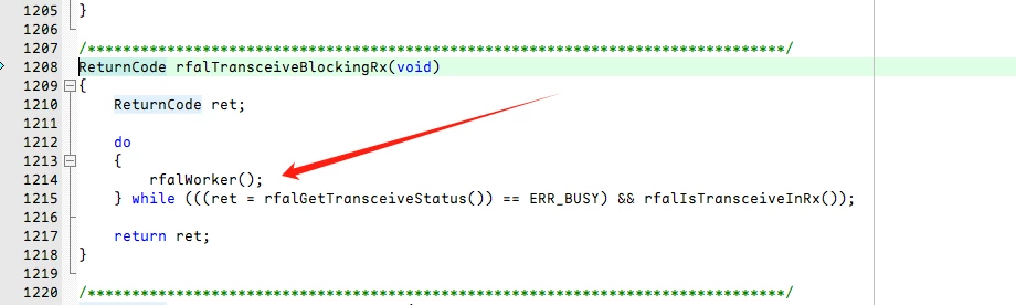

I checked the code, and it seemed that the nfcv card could not be detected in this place, and then returned the timeout flag

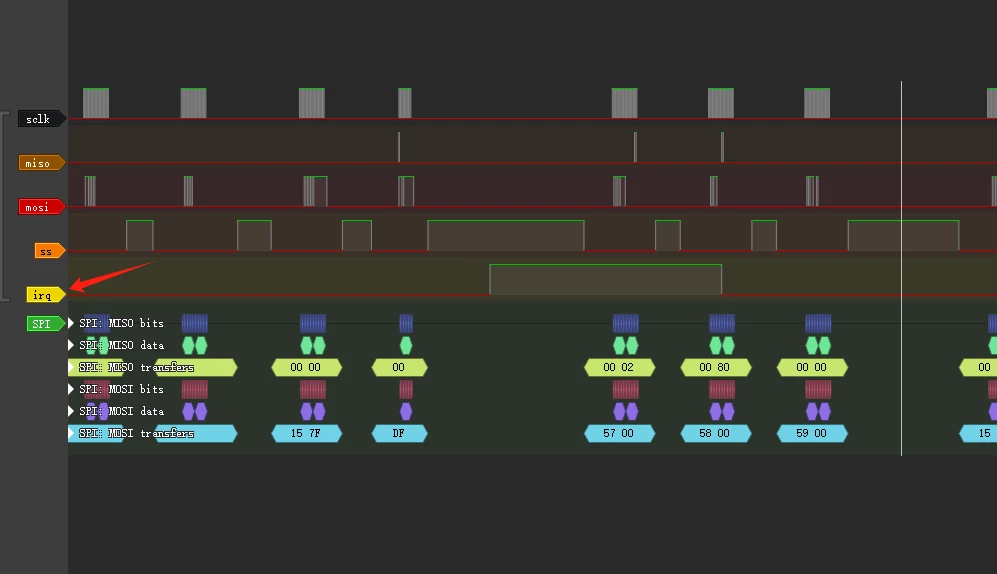

What I can confirm is the following points. The first is that the st25r3911 development board I use is normal, because I can read the data of the nfcv card by using the supporting stm32 development board; the second is that the connection between the st25 development board and the nrf development board is normal, because it can be initialized normally; the third is that when I use stm32 or nrf to drive the st25 development board to initialize, the registers inside the st25 chip read are the same.I can also provide the waveform chart after nrf initialization, using pulseview to view it, But it seems that uploading this file is not allowed in the attachment~~~~

Hi LevenTao,
inspecting the trace you shared I find:
  • 1E B0 : Number of transmitted bytes: 0xb * 2 = 22 bytes to be transmitted
  • 80 21 .......02 Write FIFO with 21 bytes
  • C5 Transmit without CRC direct command
The coding for an EOF for NFCV is 0x04 (#define ISO15693_DAT_EOF_1_4 0x04). So the transmitted frame is one byte short - missing the EOF. This will not be understood by the card and no answer will be provided.
Please check your SPI driver, where this last byte gets lost.
I still see the interrupt status register being read one by one. This violates DS ("The
interrupt registers 0x17, 0x18 and 0x19 are to be read in one attempt."). So please revert all the changes on the interrupt system. Even if working now with single reads, it cries out for problems in future.
Regards, Ulysses

The logic analyzer trace shows that RFAL original driver code (e.g. st25r3911CheckForReceivedInterrupts or st25r3911ReadMultipleRegisters) has been modified. When an interrupt is received, the 3 interrupt registers (main/0x17, timers/0x18 and errors/0x19) are read through 3 elementary SPI read commands (Select 57h 00h Deselect / Select 58h 00h Deselect /Select 59h 00h Deselect) whereas it should be a single SPI command to read the 3 registers consecutively (Select 58h 00h 00h 00h Deselect).
Can you share information on your SPI driver and RFAL modifications? I would suggest to revert all modifications inside the RFAL and to make sure that the SPI Chip Select management provides support for frames transmission (such as sending 58h 00h 00h 00h as Select 58h 00h 00h 00h Deselect).

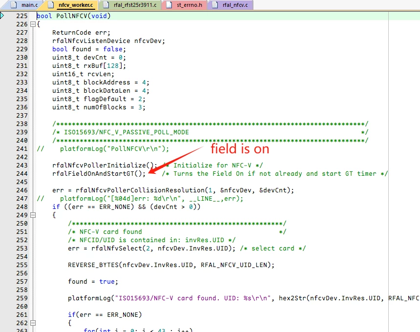

I basically ported it according to the code of the st25r3911 nucleo-nfc5_1.3.0_Type V read_write block project. The specific key points involved should be the following files
main.c
int main(void)
// bsp_board_init(BSP_INIT_LEDS);
 APP_ERROR_CHECK(NRF_LOG_INIT(NULL));
 NRF_LOG_DEFAULT_BACKENDS_INIT();
 gpio_init();
 uart_init();
 rtc_init();
 hal_spi_init(); //SPI初始化
 nrf_delay_ms(100);
 NRF_LOG_INFO("...start\r\n");
 printf("...start\r\n");
 rfalAnalogConfigInitialize();
 if (rfalInitialize() != ERR_NONE)
 platformLog("RFAL initialization failed..\r\n");
 else
 platformLog("RFAL initialization succeeded..\r\n");
 for (int i = 0; i < 64; i++)
 st25r3911ReadRegister(ST25R3911_REG_IO_CONF1 + i, &register_data[i]);
// nrf_delay_ms(1);
 platformLog("[0x%02x] : 0x%02x \r\n",i,register_data[i]);
 nrf_delay_ms(1);
 while (true)
 rfalWorker();
 workCycle();
