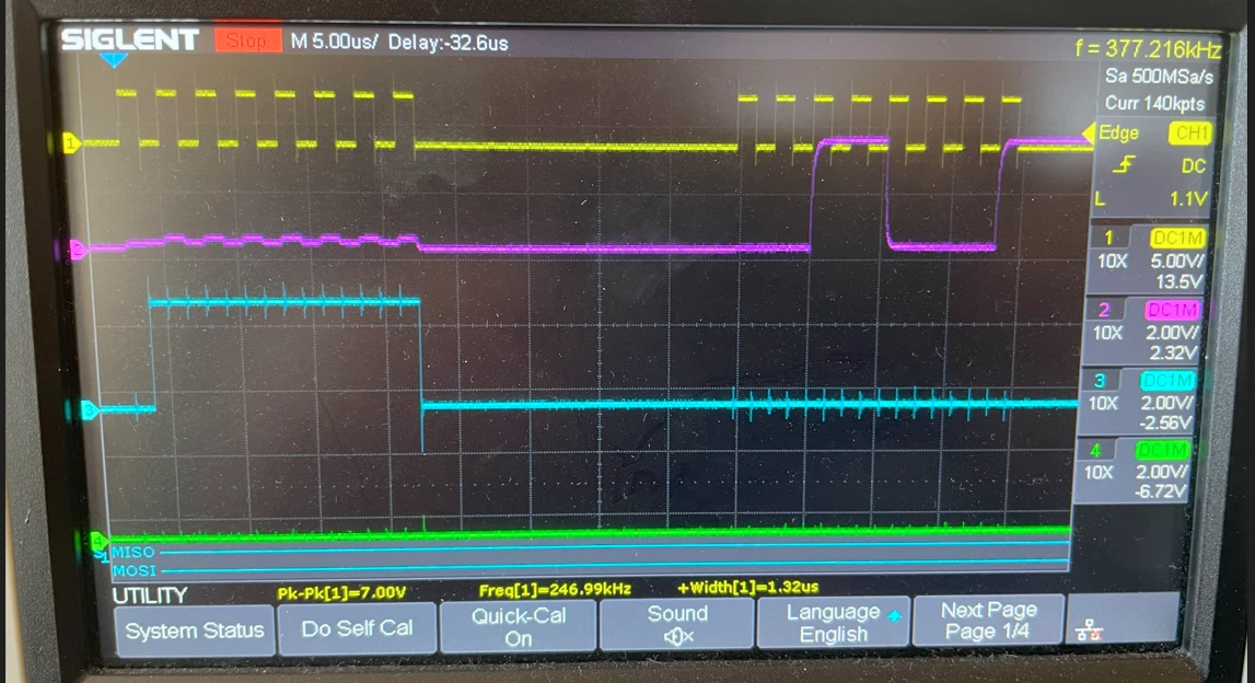

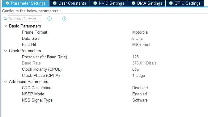

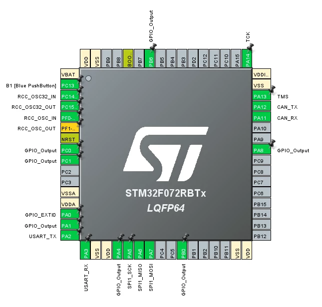

I am trying to port/get running the NFC08A1 RFAL polling demo on the NUCLEO-F072B.  I had no issues using L476RG.  I am fairly certain I have SPI set up correctly in CubeMX.

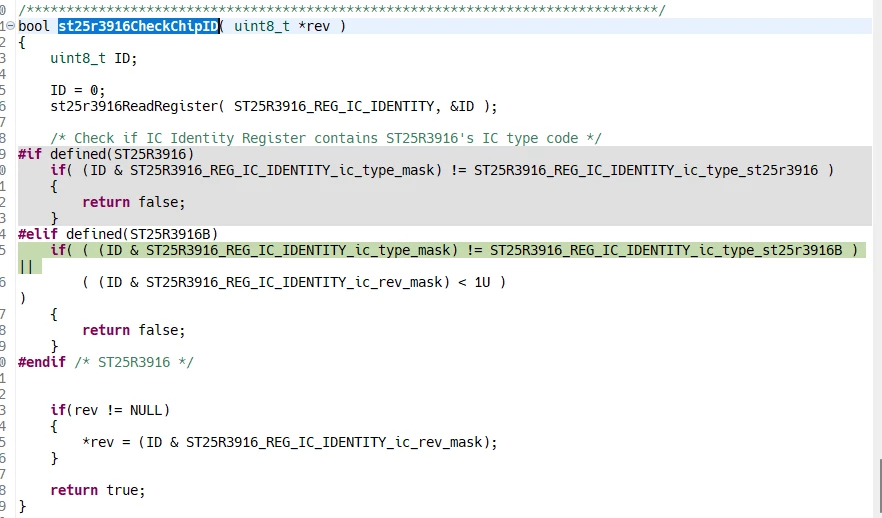

But, I am getting stuck at initialization, specifically at st25r3916CheckChipID().
ID is read as 0x18, which is causing it to return false and throw an error.  I was taking a look at the SPI traces and MISO (pink) looks not quite as clean as MOSI (blue) (sorry, had to capture using phone camera):

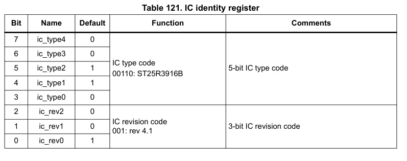

Rise/fall on MISO looks a little slow compared to MOSI.  Could this be causing the issue?  From the datasheet, it looks like chip ID should come back as 0x31:
Anywhere else you think I should look?  Thanks.
Best answer by Ulysses HERNIOSUS
On the scope you can read the 0x31 on falling slopes.
SPI  clock is set incorrectly, you need to put at "2 Edge" instead of "1 Edge".
BR, Ulysses

Ulysses HERNIOSUS
March 12, 2024
BR, Ulysses
