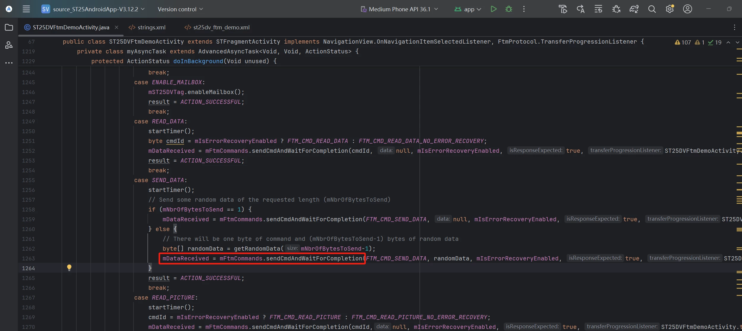

I use Android ST25 (ST25AndroidApp-V3.12.2) to communicate with NFC7(STM32L476RG) by FTM.

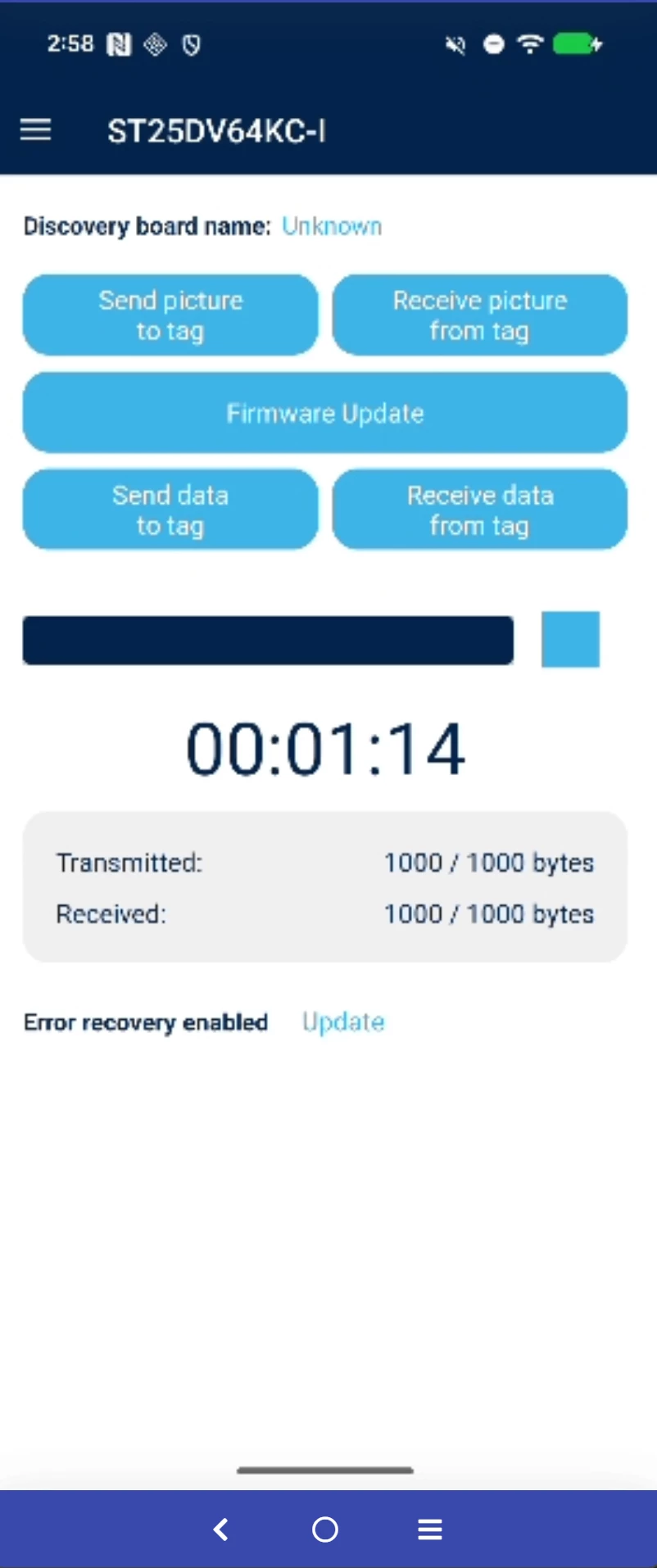

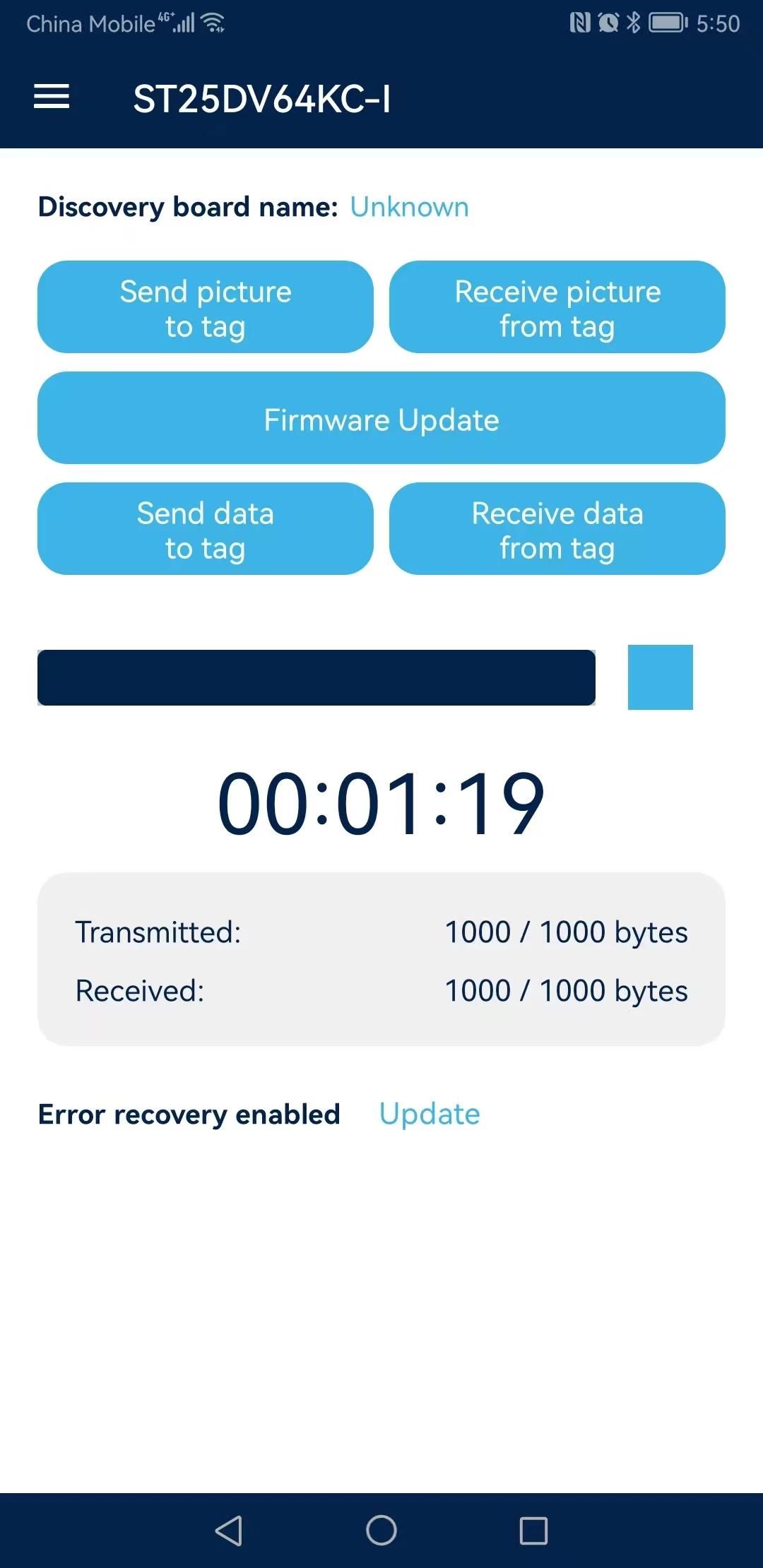

Click FTM demos of  Menu ST25DV Demostrations on Android ST25 APP, and click Send data to tag, 1000 bytes by default, the Transmission/Reception success with showd 1000/1000 bytes as showed in image below:

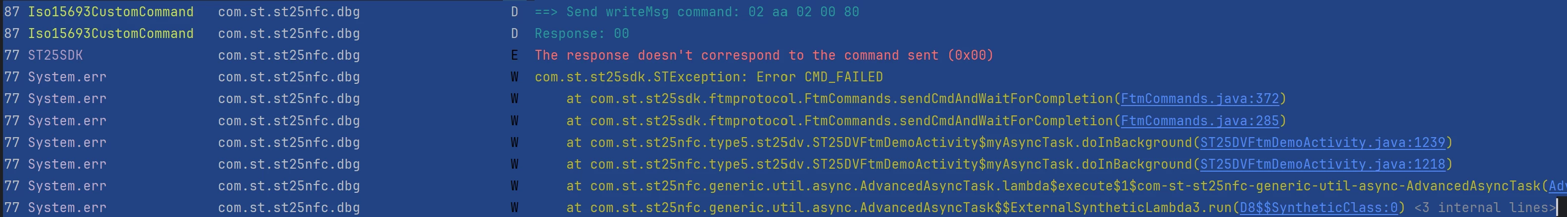

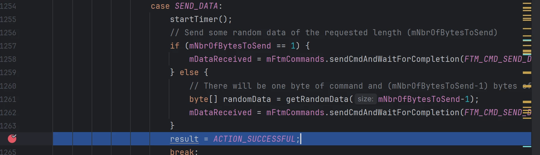

but the show exception "Command failed"  from
mDataReceived = mFtmCommands.sendCmdAndWaitForCompletion(...)
of source_ST25AndroidApp-V3.12.2\app\src\main\java\com\st\st25nfc\type5\st25dv\ST25DVFtmDemoActivity.java
the frimware is built by
STMicroelectronics\ST25NFC_Embedded_Lib_ST25R3911B_1.8.0\Projects\STM32L476RG-Nucleo\Applications\X-NUCLEO-NFC07A1\FTM\STM32CubeIDE

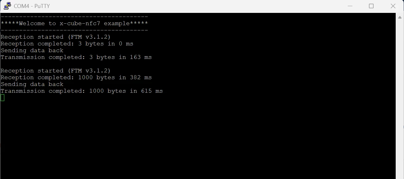

and the uart console shows success
After build and run (with ST25FTM_ENABLE_LOG enabled), the uart log as below

I found error "22049: TxState = ST25FTM_TX_ERROR" in side.
How to fixed the issue?
Best answer by France Berthelot

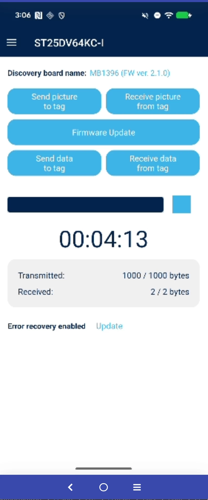

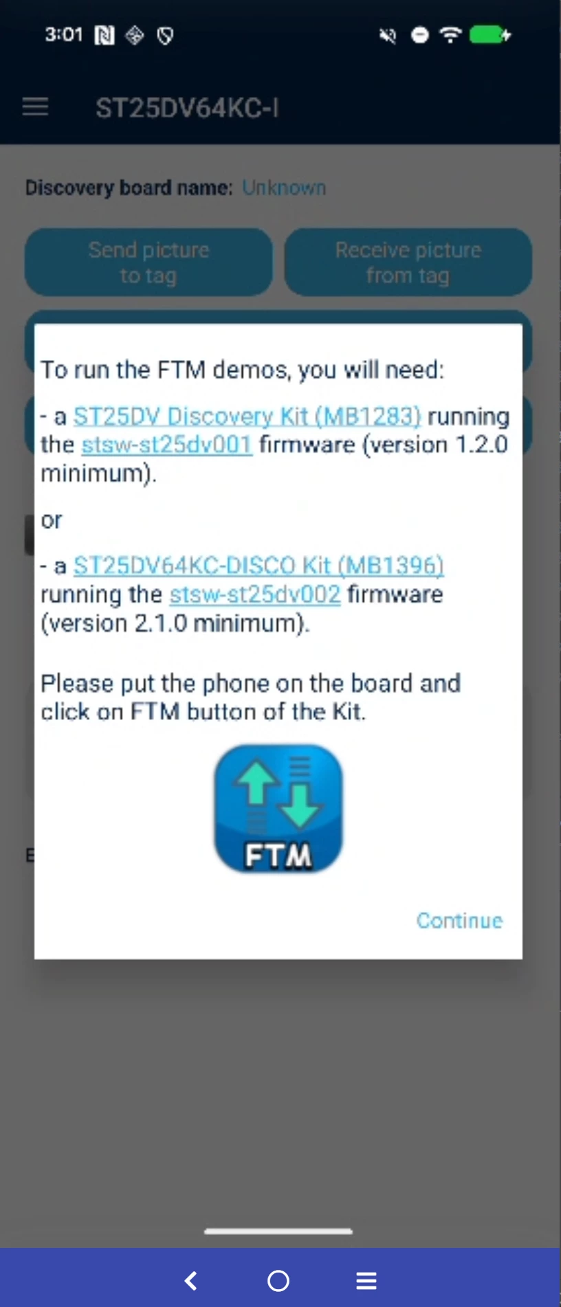

Hello
The X-NUCLEO-NFC07A1 is not developped to be in front of the Android demo
Only FW on Discovery board handle Android demo.
This is why Android demo + NFC07 raised the error : The NFC07 just do an echo of data received.
When exchange works, with FW of correct Mother board, here the result: 1000 bytes sent, 2 received
With NFC07 1000 bytes sent and 1000 received....
You have to adapt the FW demo for the demo with the NFC07 with the one provided for the discovery
Hope it clarify
