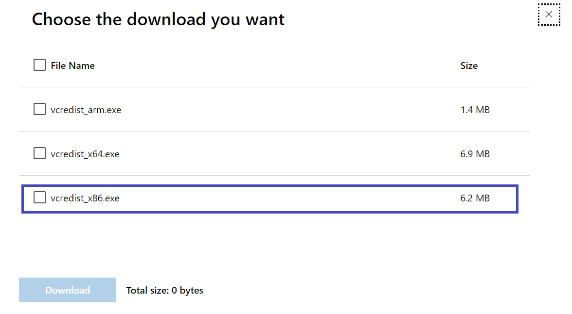

August 24, 2023
as our application is x86's based, can you please try to install vcredist_86.exe.
Best regards,
NFC Customer Support

NFC/RFID Customer support
August 23, 2023
this error comes from a conflict between the different DLLs installed by Windows. In some versions of Windows 10/11, DLLs necessary for the ST25PC SW application are missing.
Please download and install the Visual C++ Redistributable Packages for Visual Studio 2013
https://www.microsoft.com/en-us/download/details.aspx?id=40784
This will correct crash issue.
Best regards,

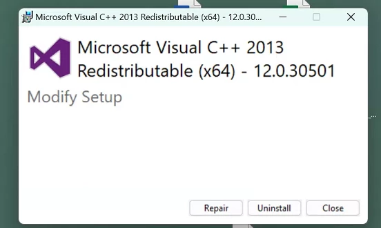

helpdeskAuthor
August 23, 2023
I installed Visual C++ Redistributable Packages for Visual Studio 2013 and that didn't resolve the crashing issue. Do you have any other solutions? Thanks in advance.
helpdeskAuthor
August 23, 2023
vcredist_x64.exe
