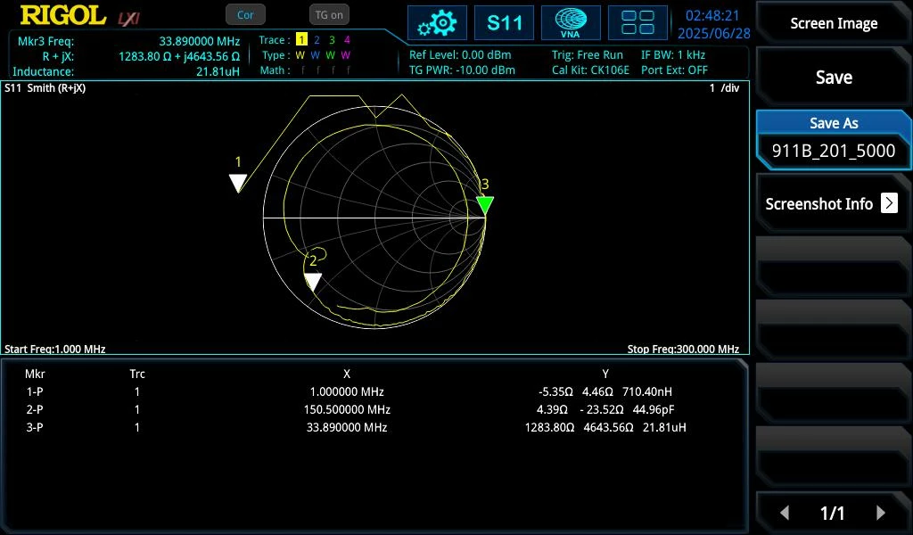

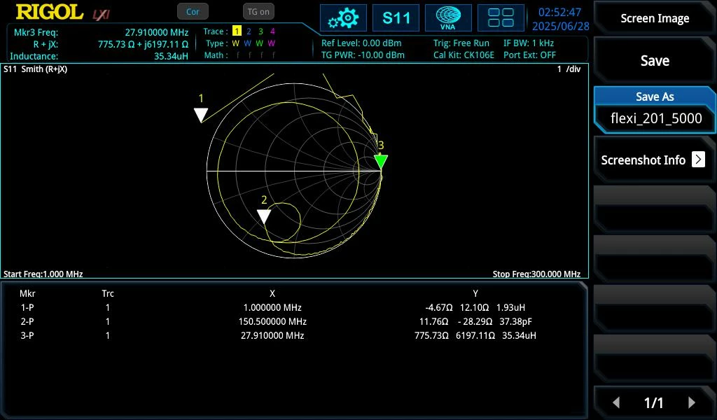

The first picture is my flexi antenna and the second is the antenna of the st25r3911b-disco board.flexi_201_5000.jpg3911B_201_5000.jpg
First of all, the low frequencies are very jagged and I'm not sure why. My only guess is maybe there's something wrong with my calibration process. I'm also guessing this may be why I'm measuring negative ohms... The antenna inductance looks okay for both cases. I expected my antenna's inductance to be high. My other confusion is that the inductance at the resonant frequency is very high compared to the app. note and other references.

From the pictures you are showing, i would also assume that there is something wrong with the calibration or scaling of the VNA. The S11 curve is normalized to 50Ohm and should not leave the smith chart.
The smith chart of the ST25R3911B-DISCO can be found in AN4914. It should be an inductive matching, which means that the resonance circle is in the upper half of the smith chart.
You can also check the calibration by measuring a 50Ohm resistor (better would be a 50Ohm calibration kit).
It is also possible to take a capacitor (e.g. 390pF) and see how the curve looks like.

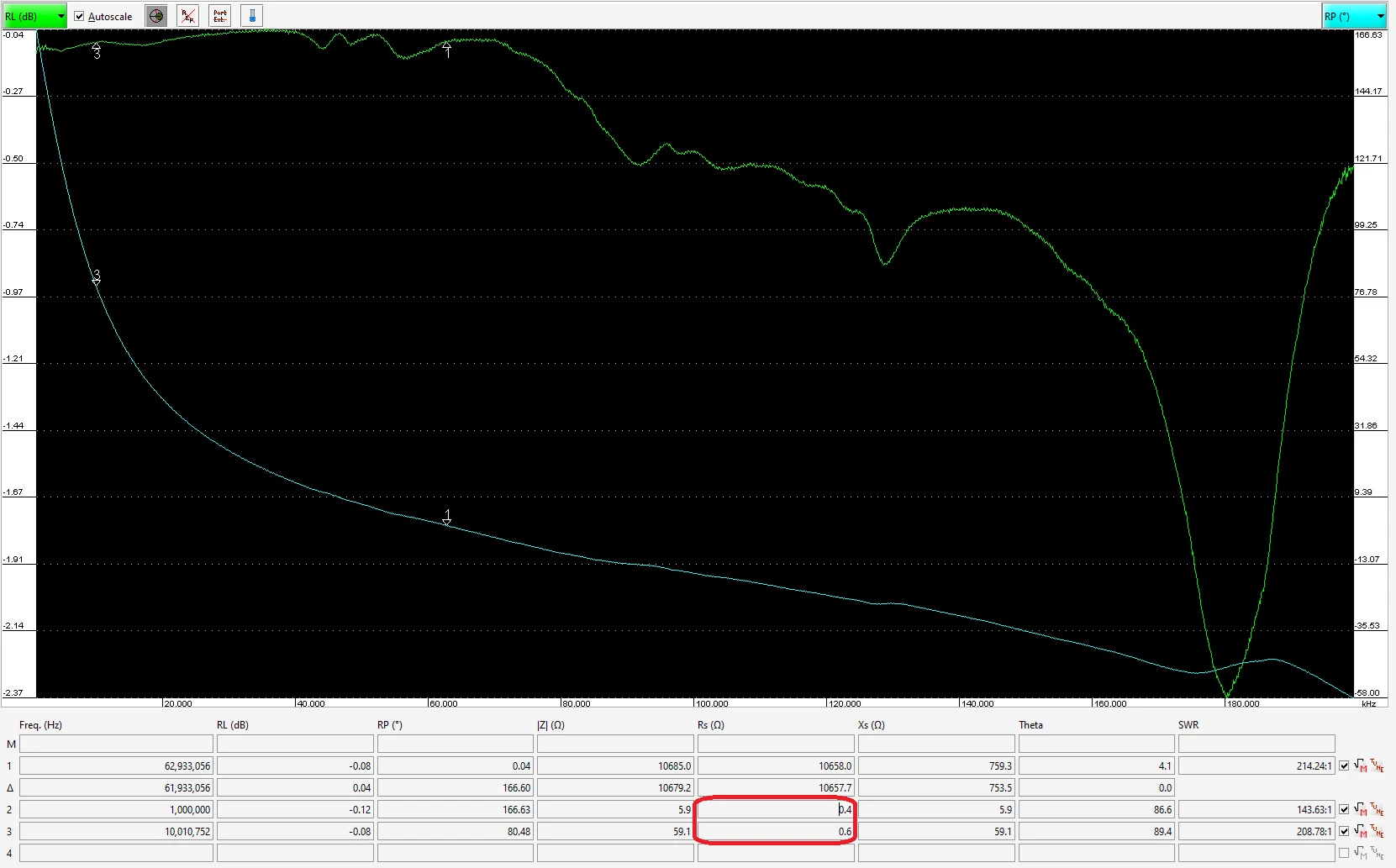

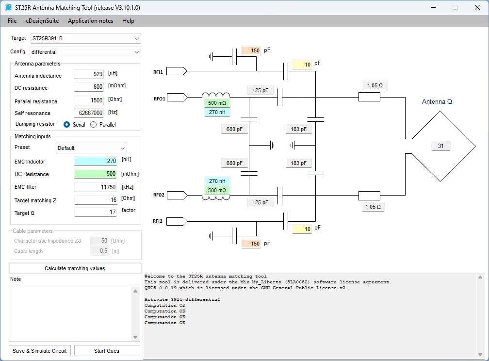

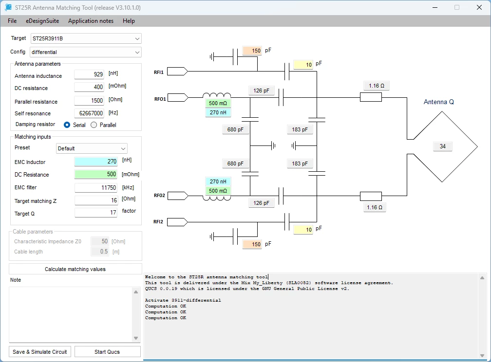

As example on the ST25R3911B-DISCO antenna the "DC" resistance at 1MHz is 0.4Ohm and at 10MHz 0.6Ohm.
If we just use the AMT and calculate the default ST25R3911B-DISCO antenna using 400mOhm:
and 600mOhm:
BR Travis
