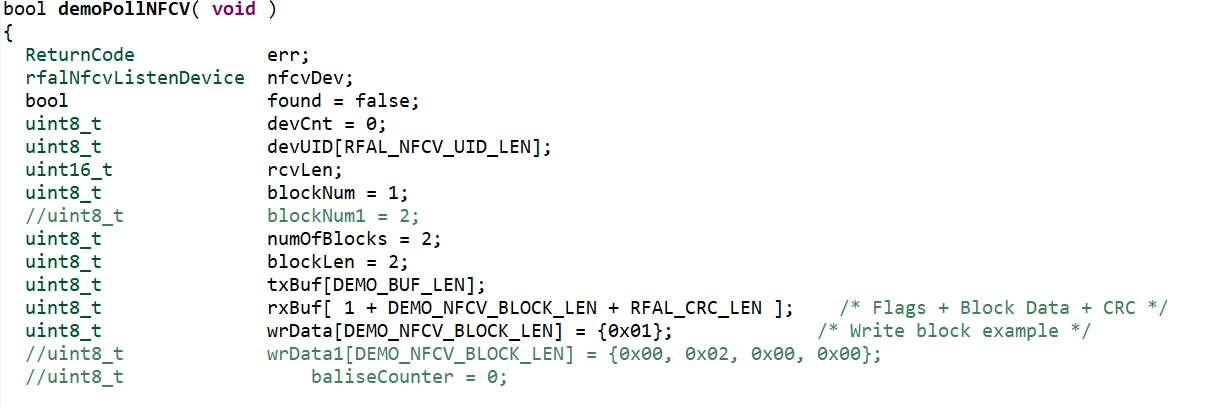

STM32L476RG + ST25R95 : write in the NFC tag several times and put the data in the rxbuffer following without overwriting previous data.
I'm using the X-NUCLEO NFC03A1 board with the NUCLEO L476RG board. I'm testing the STM32L4xx-ST25R95-Polling software example to exchange datas between my PC and a NFC tag ( an ISO 15693 ICODE SLIX). my tag is a icode slix iso15693 so I use the demoPollNfcV part of the program. When i'm reading and writing on my tag, previous data are overwriting in the rxBuffer by new data. I would like to use wrData as an array of character and write characters after characters and write in the rxBuffer following without delete previous data.

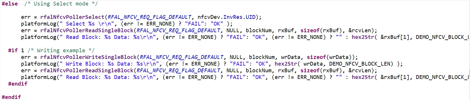

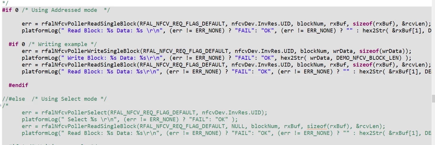

    Ok thanks for your answer, I will try to do this. I have another question, what is the different between addressed mode and select mode ?
    Brian TIDAL
    ​Hi,
    All tags in the RF field receive the commands from reader/writer. In order to communicate with a given tag:
    • either the Address_flag is set to 1 in the Flags header of the command and the command contains the UID of the tag. In this case, tags compare the received UID with their own UID. If it matches, command is executed and returns a response to the reader/writer. If it does not match, the tag remains silent.
    • or the tag has been set to Select mode thanks to the Select command. In that case, commands are sent with Select_flag set to 1 and without UID. A tag in selected state  executes the command and returns a response to the reader/writer when receiving a request with the Select_flag set to 1. Other tags in the field not in selected state remain silent

    I have tried to write in one block only, several numbers but when I write in the block, it erases the previous number in the block, so I had to create 3 blocks and write a number in each block. I don't succeed to write in one block the 3 numbers following.
