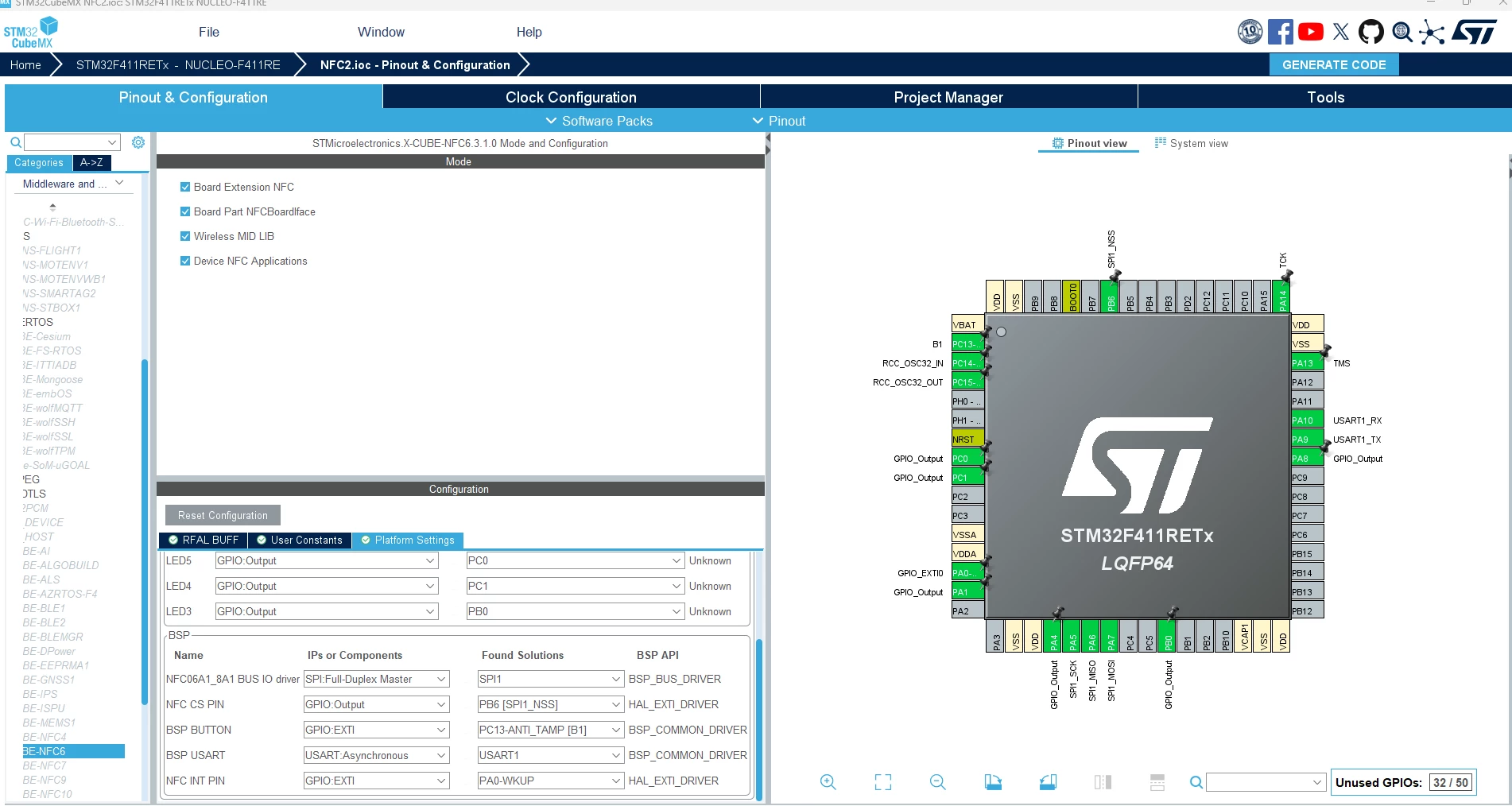

I am using the Nucleo-STM32F411RE development board and X-NUCLEO-NFC08A1 NFC module, particularly NFC Tag read/write from Android Phone for my development use cases.
To achieve this, I downloaded the X-CUBE-NFC6 package as it was mentioned in the product brief. However, I could not find any example projects specifically for the STM32F4 series.
I also attempted to modify examples from other STM32 series, but I encountered faults and was unable to successfully run the code.
Could anyone provide a working example for the STM32F4 series, or share a step-by-step user guide? As I am new to STM32 MCU boards, this has been quite time-consuming, and any guidance would be greatly appreciated.

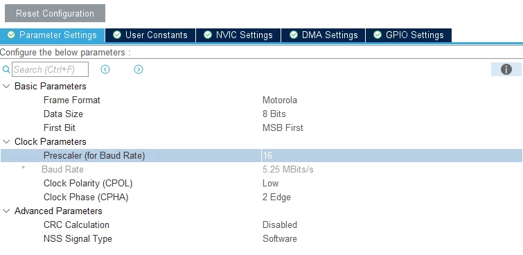

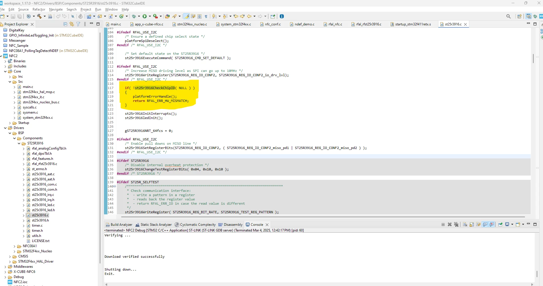

Thanks, I have configured and tried running the sample application using SPI approach but there is some execption or error fault and stuck here. Please help.
Below I have attached the configuration and code snippet where the error is caught.

By referring to other tickets. Got the issue it was related to edges and clock rate after changing it is working.
I will check other operations and get back.
