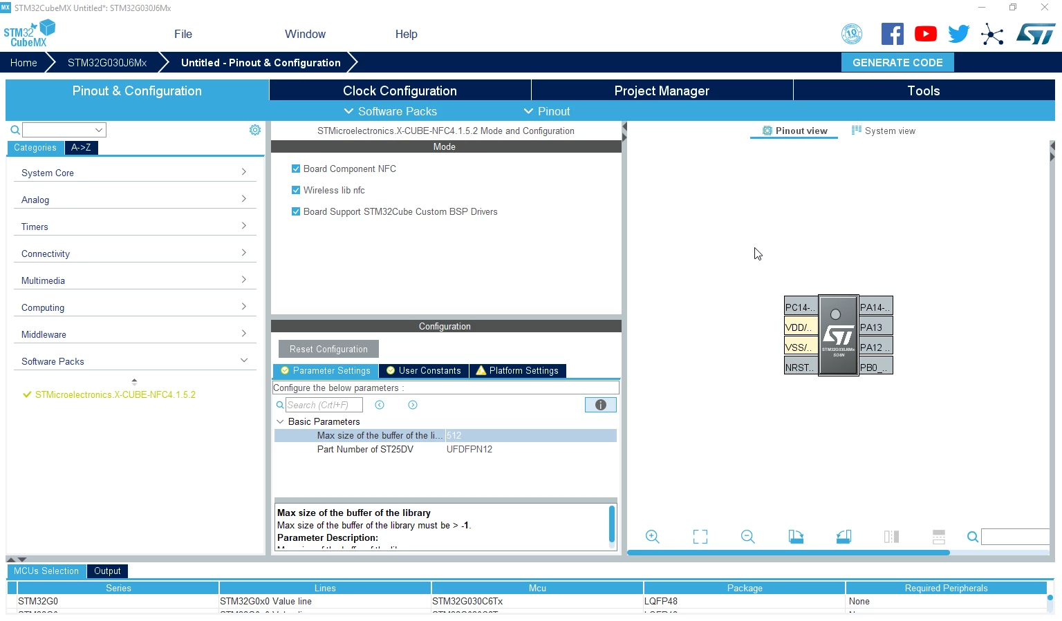

Msam.1
Msam.1Author
Jun 3, 2020 6:43 PM UTC
Hello Laurent,
I am able to create .ioc file for a 8 pin mcu from STM32G0 and please check the attached .ioc file. After that without any change for the source code files, I have an error after compiling the project in KEIL:
"../Src/lib_NDEF_config.c(31): error: #5: cannot open source input file "nfc04a1_nfctag.h": No such file or directory"
Then I have to change the include statement from "nfc04a1.h" to "custom_nfc04a1.h" in the lib_NDEF_config.c.
After that I face more errors when in compiling in KEIL.
Please advice.
Thank you and Regards,
Mark
Msam.1
Msam.1Author
Jun 3, 2020 10:25 PM UTC
Hello Laurent,
The following screen shows the errors result I mentioned in my last post for your reference.
I wonder you can open the attached .ioc file with the STM32CUBEMX and do your correction in order to run the generated source in KEIL without error.
Best Regards,
Mark

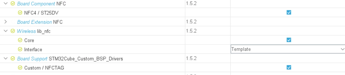

KTiwa.1
KTiwa.1Best answer
Visitor II
Jun 4, 2020 11:45 AM UTC
Hello Mark,
Kindly select Interface as "Template" instead of "Basic" in Addition software setting for NFC4. Since for custom board implementation Template is used as interface 0693W000001q2bRQAQ.png
Best Regards
Rahul

Msam.1
Msam.1Author
Jun 4, 2020 11:16 PM UTC
Hi Rahul,
It works after I verified.
Thank you for help!
Mark
