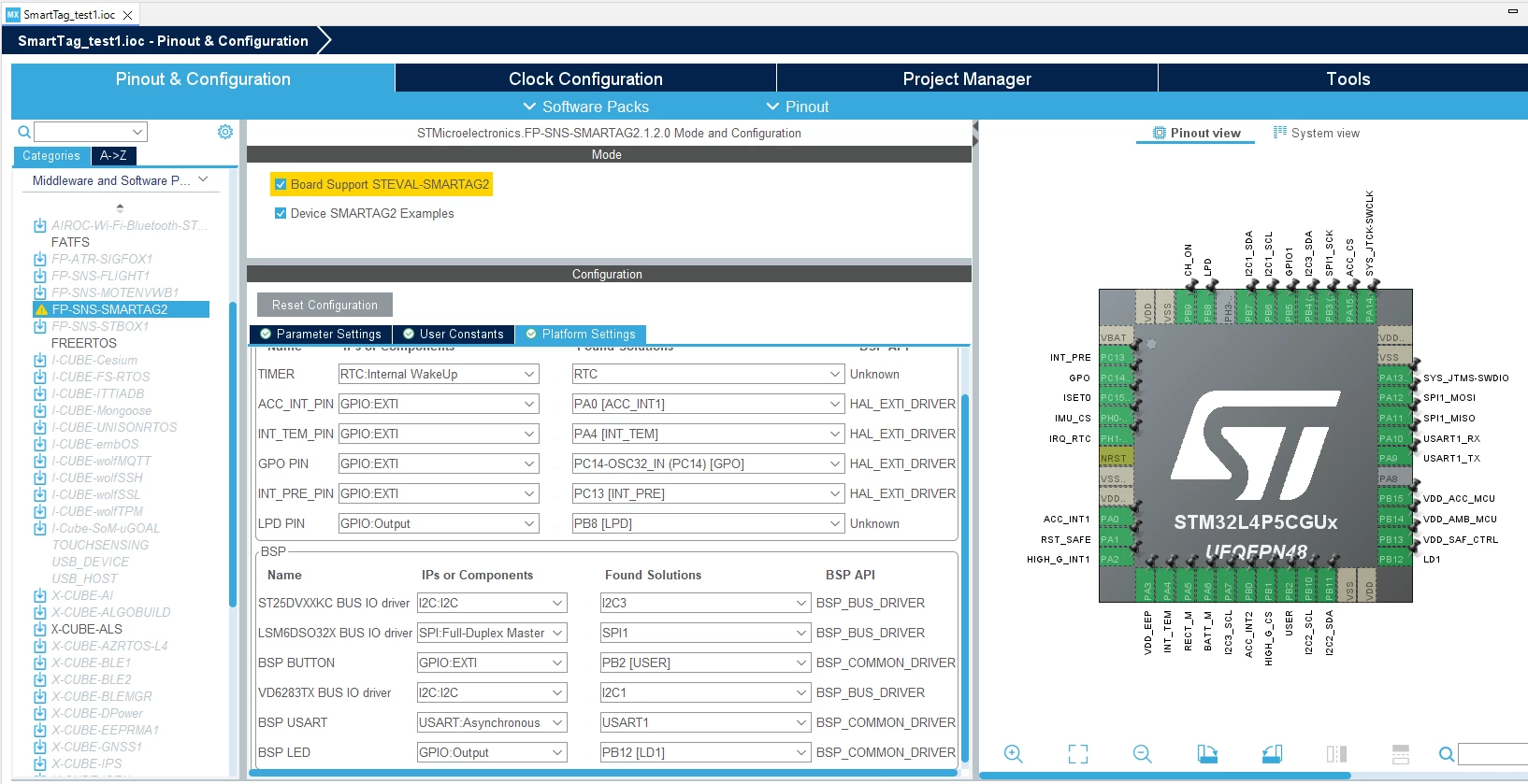

Hello, I'm using STEVAL-SMARTAG2. In the future I want to design my own PCB with  ST25DV64KC and STM32L4P5-CGU6. But for now I want to create my own program and try it on STEVAL-SMARTAG2.
If I import example project in CubeIDE and complie it, It works fine.

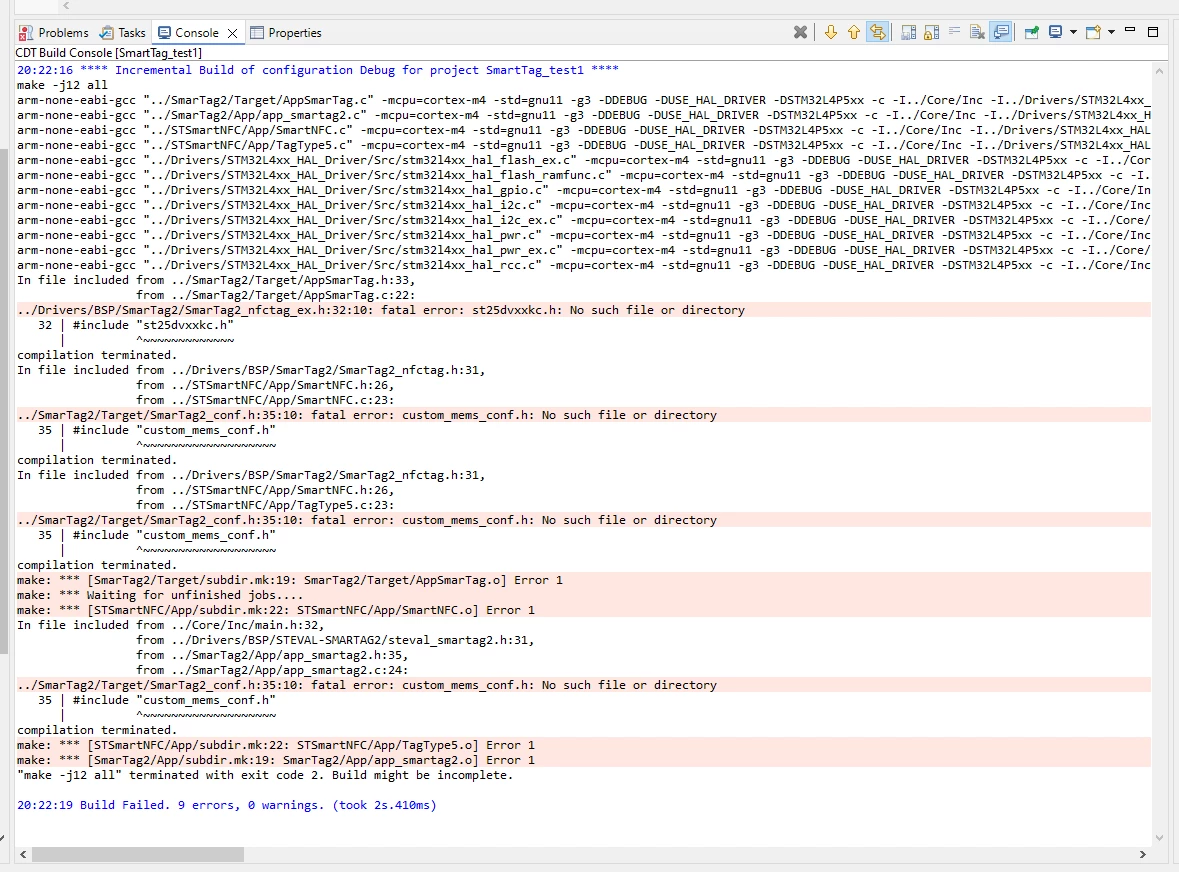

If I want to create my own project and include libraries I get an errors during compiling.
So, I did the following:
- start new project in CubeIDE and select "STEVAL-SMARTAG2"
- set inputs/outputs as default (press OK when pop-up window ask me if i want to keep it)
- middleware/software package... download and select FP-SN-SMARTTAG2
- define platform settings (picture below)
- save and run the compiler and get an errors (picture below)
It looks like I miss something?
Also in my further project I don't need to use all the sensors on the protoboard. I just want to use NFC-V and powering tag with energy harvesting.
Thank you for your time.

First of thanks for your interest in ST25 products !
Then, the details described are not sufficient to well identify the problem.
The file SmarTag_test1.ioc (STM32CubeMX configuration file for the generated project ) will be necessary.
What can be said is that:
  • In the first picture  "Board Support STEVAL-SMARTAG2" is in yellow color.
  • This means that a few components have not been included in the "Select Components" phase: I suppose NFC7 board extension and X-CUBE-MEMS1 driver components.
I hope this helps,
Best Regards,
BB
