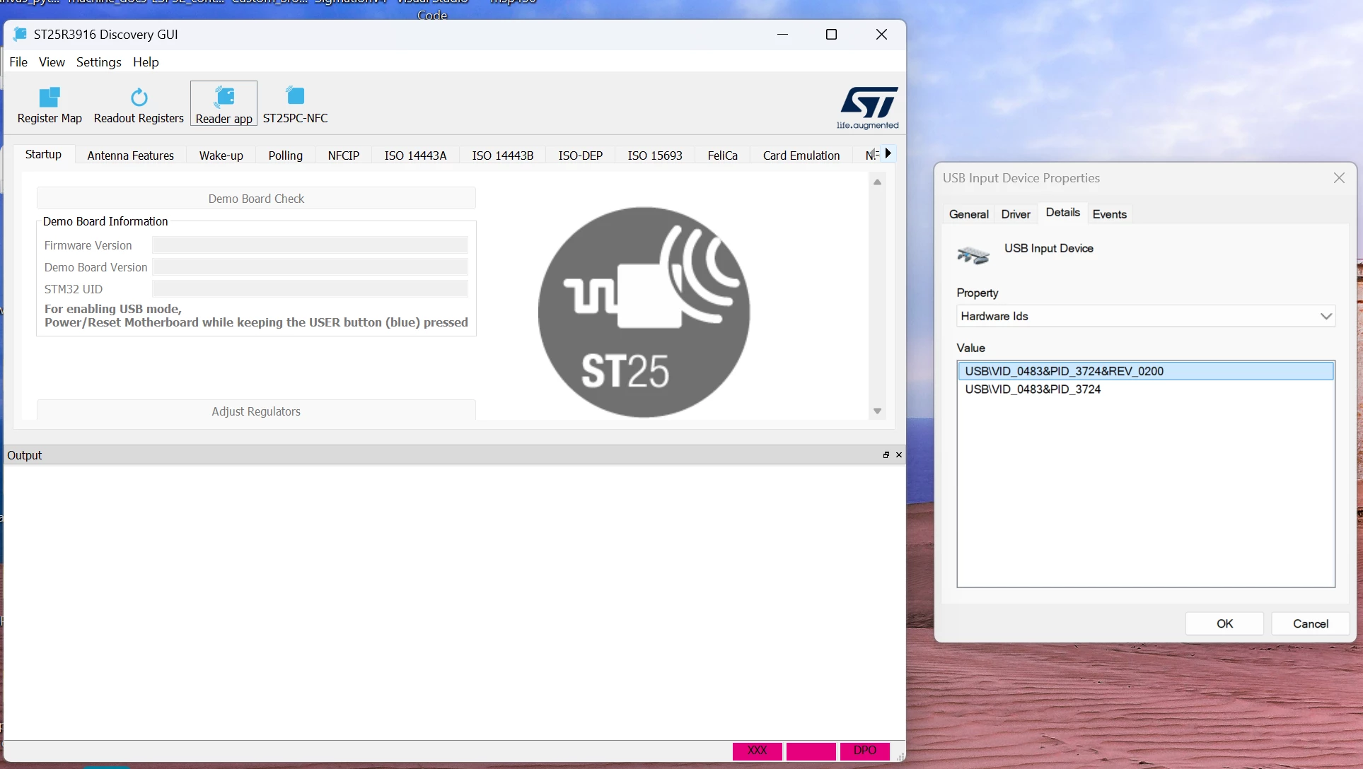

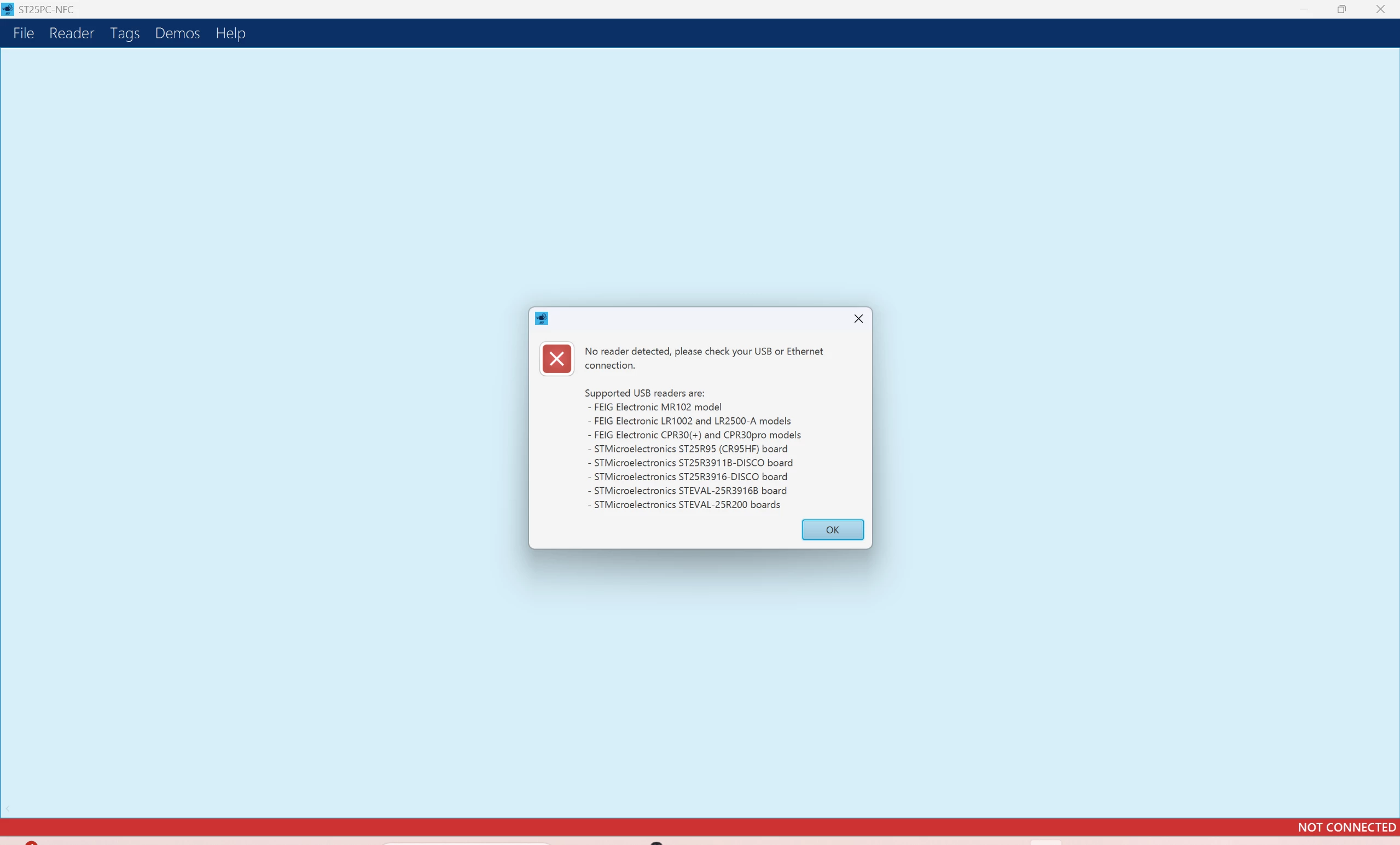

I recently purchased the STEVAL-25R3916B board and it functions correctly with the out-of-the-box demo. However, I’ve been unable to get it working with any of the available software tools, such as the ST25R3916 Discovery GUI or ST25-PC.

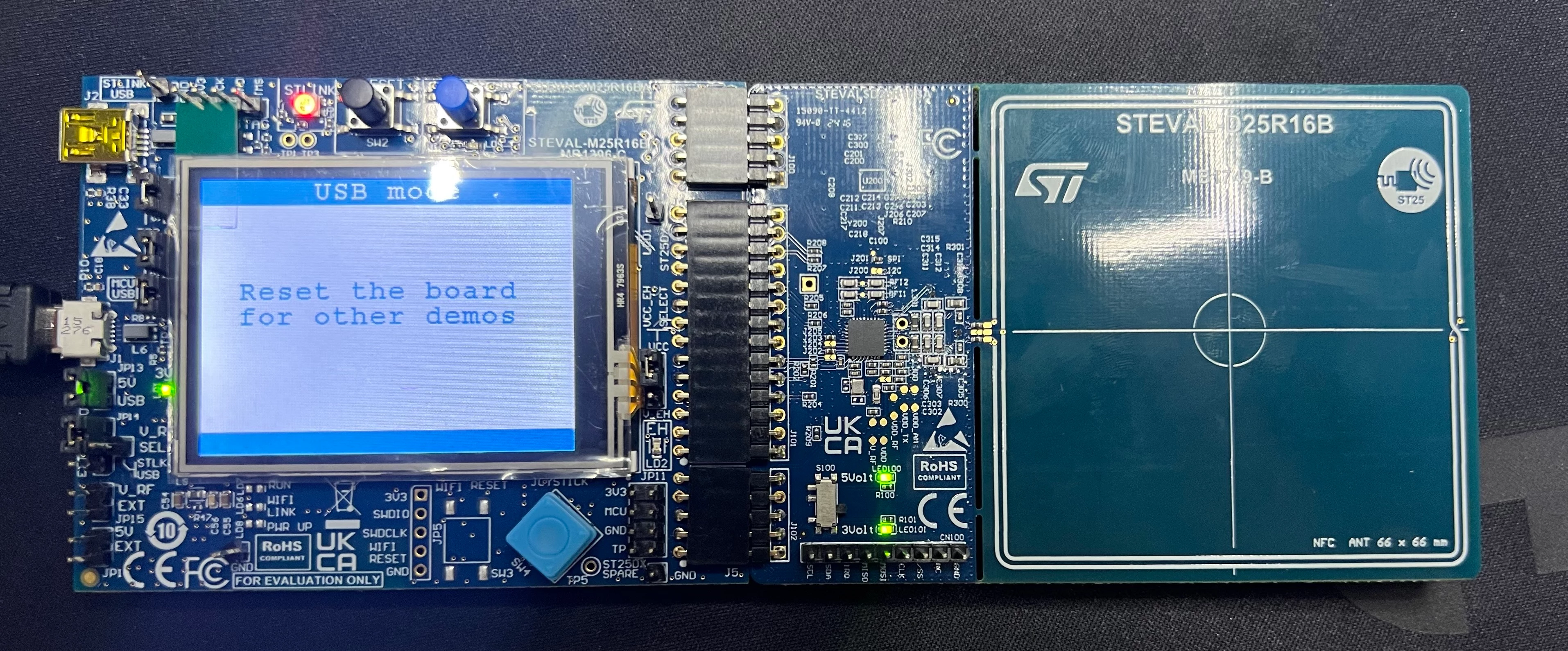

I’ve confirmed that JP14 is correctly configured, the board is set to USB mode, and I’m using the correct USB port as per the documentation. Despite this, the software does not detect the board.

please confirm that:
- the following message is displayed on the screen:
- the USB is connected on "MCU USB" (type B connector):
- JP14 and JP13 are in the position indicated as red on the picture
- your USB cable is not defective (please test the cable)
- you can see USB input device with the following VID/PID in the device manager:

For starters, I would like to extend my thanks for your prompt response. I can confirm that all of the specified requirements are met as:
1- USB connections and jumpers were done correctly:
2- USB Device is identified as you have shared, but none of the apps can use it.
3- I have tested using multiple cables, and the problem seems to persist. I have also tested the product on a different computer, but the state is the same.

you checked already pretty much everything. Which leaves me puzzled. Last time such issue was resolved by moving from a power-only USB cable to a data USB cable. But the device is even enumerated in your case....
  1. What is the Windows version you are using? Which architecture?
  2. Can you keep the GUI open and observe output while resetting the board and putting back into USB mode? (AFAIK some log messages about device detected should appear)
  3. I presume you were using a different PC with basically same company applied restrictions. Can you try this on a completely different PC (private one?) This should give us hints if the issue is with the board or somewhere else.

Thanks for your reply. After testing the module with a non-company PC, the USB mode functionality works as expected. It seems that the issue was a company group policy or something of similar nature.
Thanks for your timely help and support.
