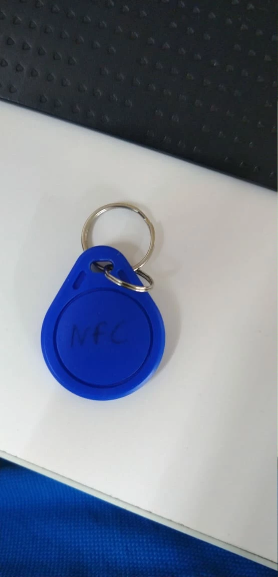

I'm trying to communicate with a tag that has a chip FM11RF08.
Following are the sequence of commands I send to ST95HF
>> 0x02 02 02 00 <-------------Select Protocol
<< 0x0000
>> 0x04 02 26 07 <------------REQA
<< 0x8700
When, I checked the datasheet it says 0x87 "Frame wait time out (no valid reception)".
Please, help me to debug this issue@, correct me if i have missed something.
Hardware used:
  • In-house designed PCB, that includes 16 bit MCU with ST95HF
  • PCB Antenna, 1.86uH @ 13.56MHz
Software setup:
  • SPI communication with ST95HF
  • I'm my own handler code for ST95HF
Tag used:
@Brian TIDAL_O​
    Brian TIDAL
    Brian TIDALBest answer

    HI,
    I would suggest to
    • check that this tag is not malfunctioning by reading it with another reader (e.g. a smartphone with NFC support)
    • check that the reader is properly working with a reference ISO14443A tag such as ST25TA tag
    Rgds
    BT
