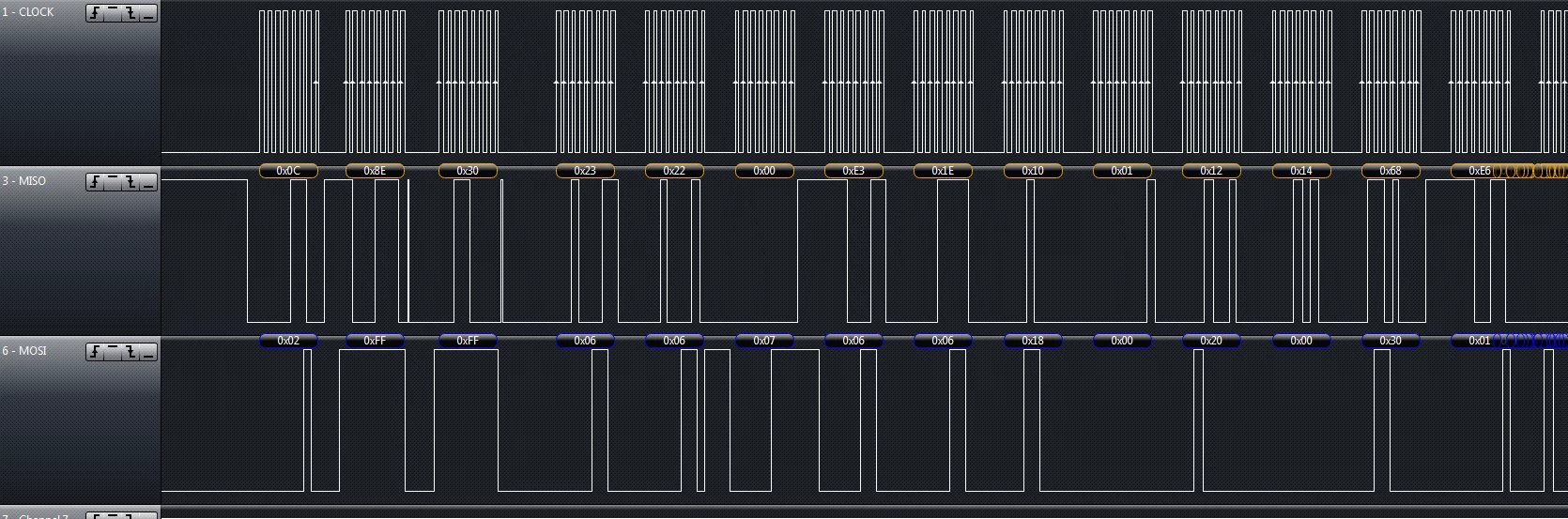

    Ye zhihuang
    August 24, 2017
    Posted on August 24, 2017 at 07:55
    Thank you so much for your reply.There are our command code:(We select 15693 protocol in reader mode,we want to read 15693 tag)
    1�?00 02 02 02 09
    2�?02 ff ff
    3�?00 09 04 68 01 01 D1
    4�?02 ff ff
    5�?00 04 03 26 01 00
    6�?00 55
    7�?02 ff ff ff
    8�?00 02 02 00 00
    After we send the 00 02 02 00 00,the ST95HF replys a lot of code back,which more than 50 byte.

    ________________
    Attachments :
    The error codes.logicdata.zip : https://st--c.eu10.content.force.com/sfc/dist/version/download/?oid=00Db0000000YtG6&ids=0680X000006HyKR&d=%2Fa%2F0X0000000b8R%2FH6VWbLfSLP49ZuOKU.FhfkAwpr_PUD6XZj5cnvo3Jvw&asPdf=false

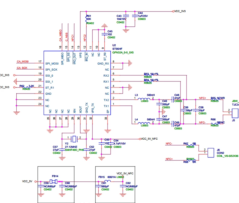

    Ye zhihuang
    August 26, 2017
    Posted on August 26, 2017 at 08:52
    Thank you very much for your reply.
    We do want to select 15693 protocol to read 15693 tag.At our design,the VPS is used 3.3V for supply voltage,and the VPS_TX is used 5V for supply voltage.But i do not see any suggestions about the VPS ?VPS_TX have to be designed with the same voltage in the ST95HF DataSheet. There is my design schematic diagram below.Looking forward to your more suggestion. 0690X000006081QQAQ.png
    Rene Lenerve
    August 28, 2017
    Posted on August 28, 2017 at 11:03
    1) If you want to read/write ISO15693 Tags, you first need to select ISO15693 protocol by sending the following command to the ST95HF:
    -> 00 02 02 01 1D
    2) What I intended to say by '
    You cannot change
    VPS_TX voltage only', is not that you must have VPS_TX = VPS_Main. But if you design your board with VPS_Main = X.X Volts and VPS_TX = Y.Y Volts, you cannot change those values without adapting the board (antenna tuning, capacitors, ...).

    Ye zhihuang
    August 29, 2017
    Posted on August 29, 2017 at 02:43
    Thank you again for your information. it does help me a lot.
    I had follow the antenna design guide and used the calculation tool to design the antenna. Is there any problem
    with VPS_Main = 3.3Volts and VPS_TX = 5 Volts,would it do harm to the ST95HF.
     I
    sent the following command to the ST95HF to select ISO15693 protocol:-> 00 02 02 01 09(26Kbps WFS MOD100% Single subcarrier CRC appended), is it OK?
    Thank you again.Looking forward to your reply.

    Rene Lenerve
    August 29, 2017
    Posted on August 29, 2017 at 10:02
    There is no problem to use ST95HF
    with VPS_Main = 3.3Volts and VPS_TX = 5 Volts. O
    ne thing to be aware is that the signal on RX1 and RX2 (between RX1-GND and RX2-GND) does not exceed 8 Volts. With your 1Kohm resistor, this is very sufficient to attenuate the signal.
    Your command to select ISO15693 protocol is OK and the ST95HF should answer:
    -> 02 00 00
    And after that the ST95Hf is ready to send RF commands.
    Best regards.
