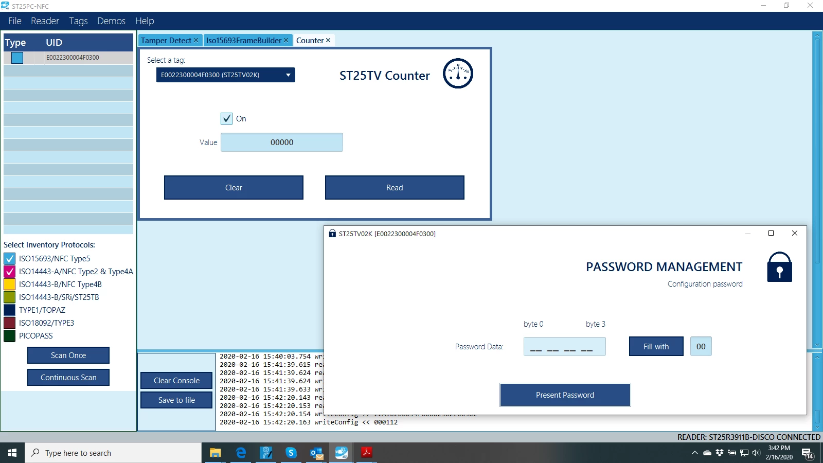

ST25TV Default Password
I have a ST25TV in the eSEAL Evaluation Board. I want to set the Counter Configuration. I need a password to do this (which I never set). What is the default password?
Thanks,
Vince
    Berenice BENVEGUDA
    ​Hello,
    First of all thanks for your interest to ST25 product family !
    Then, If you haven't never set the configuration password, the default value ( factory value) should be 00000000h.
    See datasheet : ST25TV02K DS , chapter 5.2.1 Data protection registers
    Best Regards,
    BB
