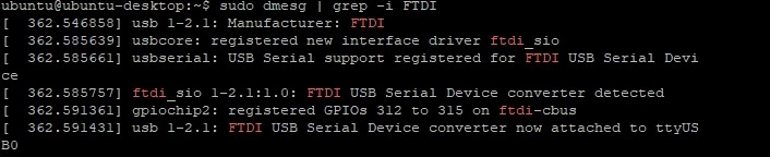

yes sir, i've alreadly checked usb devices in the command line and the board appear as FTDI_FT231_USB_UART_DK0E4A01, but i received this when i run the .out file
Nick K
July 22, 2024
when version is reported as V0.0.0.0 this normally indicates that the serial connection to the board failed.
could you please check all available USB to serial converts on your device and list their mount points with
dmesg | grep -i FTDI

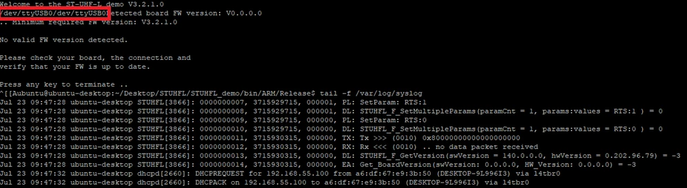

could you also please share the STUHFL log from your out file to see the return value of STUHFL_F_Connect(..) by using
tail -f /var/log/syslog"
July 23, 2024
Hi, Mr.Nick
Here are all the logs you asked for, i don't really understand the error

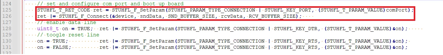

Before this the log of line 125, 126 and 128 is missing, which connects to the board in STUHFL_demo.c and should give more info why the connect fails.
What is a bit strange in your screenshot of the terminal output is the following.
This should be "/dev/ttyUSB0". (only once). If you call STUHFL_F_Connect with "/dev/ttyUSB0/dev/ttyUSB0" the call will fail.
STUHFL_demo.c printf in line 264 the COM_PORT define. Have you added a additonal printf statement ?
Or have you modified the COM_PORT define in line 67, or any idea were this comes from ?

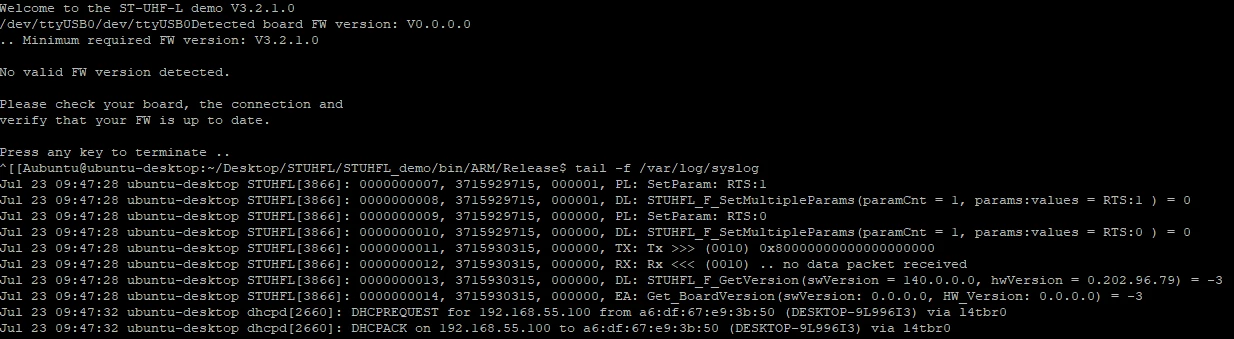

July 29, 2024
Hi cuongnguyen,
thanks for the screenshots. As already assumed is the issue is the STUHFL_F_Connect function.
The call to the function seams to be using correct parameters.
The only change to find the reason why it is failing with your board is to debug the implementation.

cuongnguyenAuthorBest answer
July 31, 2024
Turn out that i did not set permission for the program to access serial device, thanks for debugging advice, everything works fine now, thank you so much
