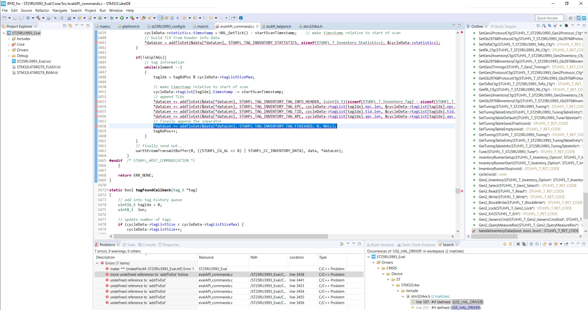

0693W000001rC0IQAU.pngHi Cedric, Thank you for your response.
The file which fails is evalAPI_commands.c
In fact, I want to compile the original firmware, then the only change I want to make is compile the fw but for a baudrate of 115200 bauds.
I want to use STM32 Cube for compiling. To accomplish that I generate a project "ST25RU3993_Eval.ioc" file. Then I added all the source files necessary.
I added the preprocessor defines because as a blank project does not include those ones.
At first I copied all the files and compiles OK. But after downloading the .bin file the board does not work (no leds activity)
For this reason I want to turn on the debug to check the failure, but i guess that the original fw works properly without any intervention.
Regards
Franco
Cedric Dalban
June 22, 2020
Hi Franco,
it seems your project does not contain the file stuhfl_helpers.c (...\Middleware\clib\STUHFL\src) or/nor the path to its header file (...\Middleware\clib\STUHFL\inc) explaining the compilation error in evalAPI_commands.c.
For your info, with all releases we provide an ARM project but also a TrueStudio project (v9.3.0) (...\Firmware\Eval\TrueSTUDIO\ST25RU3993_Eval\.project).
This will help you to generate your project by importing it directly to STM32 Cube.
Concerning, the baudrate if your project does not define FAST_UART or define it to 0 (default is FAST_UART=1) the baudrate will be set by default to 115200.
The only problem with such modification is your FW will no more be able to communicate with the GUI.
Indeed the GUI has been configured to communicate at 3MBits, this baudrate being required to sustain communications up to 800 tags/sec.
Hoping this helps,
regards,
Cedric.

Thank you. The missing evalAPI_commands.c file fixed the compilation. Now I download the .bin file but the board does not run. Also I will try using the TrueStudio migration but something seems wrong because in the procedure ask me indefinitely the microcontroller to use. I select the STM32L476RGT6 but the IDE ask the same endless.

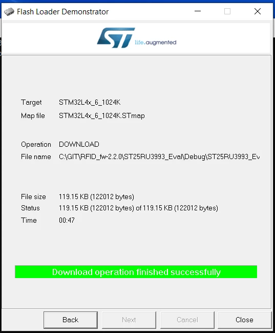

Thank you for your response. I have installed TrueSTUDIO 9.3.0, but I have the same effect. Project compiles correctly but the Eval Board does not work using my compiled fw.
However I have a weird symptom when the board is downloading the firmware:
When is downloading original .bin file provided with the ReaderSuite, the progress bar increases up to 94% or more (it is difficult to see the latest value) and a message box shows "Successfully downloaded firmware!" then automatically eval board works perfectly.
When I download the .bin file from my own compilation the progress bar increases only up to 73% approximately only, shows the "Successfully downloaded firmware!" but the eval board does not work.
It can be some size constraint or any similar? It is weird, in some cases after the downloading procedure the ReaderSuite closes unexpectedly.

I could solve the problem. I guess that is some issue into the integrated ReaderSuite flasher utility.
Now I can download my own .bin compilated file using the ST Flash Loader Demonstrator, the firmware is downloaded and the EvalBoard works correctly.
Also the .bin file compiled using the STM32 Cube IDE v1.3.1 works as well as the .bin compiled using TrueSTUDIO.
