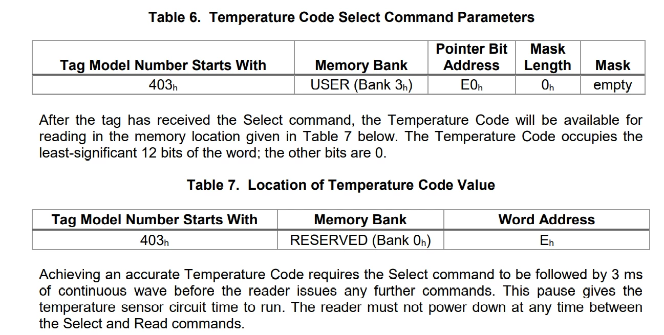

I want the Temperature code. In the application note AN002F38, it is mentioned as below:
"As with the On-Chip RSSI Code, reading the Temperature Code is a two-step process requiring standard UHF Select and Read commands.
1. Send a standard Class-1 Generation-2 UHF Select command with the parameters described in Table 6 to initialize the temperature sensor and calculate a Temperature Code.
2. Send a standard Class-1 Generation-2 UHF Read command to retrieve the Temperature Code from the tag memory at the location given in Table 7."
0693W00000HpfLAQAZ.pngHow can i send select commands and access the particular memory bank so that i can fetch the temperature code and calculate the actual temperature.
How to read a memory bank using SDK source code provided by the ST.
I want to know if a particular API is available to achieve this and in which place in the source code should i use it.
The application note and the related documents are attached below for your reference.

according to the application note the sensor TAG needs 3ms continuous wave after the Gen2_Select command before any further command from the reader.
The actual ST25RU3993 do not allow this out of the box. Although, the Gen2_Select command is a separate API calls the FW
collects Gen2_Select commands and send them direct before scanning for TAGs with the Gen2_Query commands.
There is no delay after the Gen2_Select command, as this is not needed under normal conditions.
To add a delay after the Select before the inventory you need to modify the FW first.
The easiest would be to add a HAL_Delay(3); to the functions
static void inventoryGen2(void) in file evalAPI_commands.c
In this function search for "performSelectsGen2();" and add there a delay of 3ms afterwards
With this fix then do the following to select, inventory and read a TAG
To send a Gen2_Select and a following Gen2_Read command please use the following API functions.
NOTE: The Gen2_Select API do not send any command by itself it only store the "select" request(s) in the FW.
The FW executes then all Gen2_Select commands when running an inventory, as discussed above.
-> This means in your case execute an Gen2_Select, followed by an InventoryRunnerStart and when your TAG is found send a Gen2_Read command.

The parameter target, action, memoryBank, mask, truncation are as defined in the UIHF Gen2 standard.
Accodring to the application note, in case of temperature measurement with this sensor TAG you could use the default initalization values, except the memoryBank.
eg:
STUHFL_T_Gen2_Select Gen2Select = STUHFL_O_GEN2_SELECT_INIT(); // Set to FW default values
Gen2Select.memoryBank = STUHFL_D_GEN2_MEMORY_BANK_USER; // set memory bank
// mask and maskBitLength is empty by default
// Execute the Gen2_Select command
Gen2_Select(&Gen2Select);

In your case the memoryBank must be set to STUHFL_D_GEN2_MEMORY_BANK_RESERVED and the wordPtr must be set to WordAddr 0x0E

As mentioned by you, I made the changes and called the select api, followed by inventory and read.
But still not getting the temperature data. I am getting only zeroes.
However, I noticed the following:
1. When STUHFL_T_Gen2_Select variable is declared, initialized and Gen2_Select() function is called, Only the first 'if' block inside it is getting executed, as all the parameters are set to default except memory bank.
2. Inside performSelectsGen2() function, the gen2Select() function is not getting called as numSelects value is 0.
static void performSelectsGen2(void)
 for(uint32_t i=0 ; i<numSelects ; i++) {
   gen2Select(&selParams[i]);
 StoreTestData(TEST_ID_GEN2_SELECT_T4MIN, sizeof(uint16_t), (uint8_t*)&gen2Configuration.T4Min);
 And moreover selParams will be sent as the argument for gen2Select, which are all zeroes.
I have added the HAL_Delay(3), right below the PerformSelectsGen2() inside inventoryGen2() in evalAPI_commands.c file. That particular part of code is attached below for reference.
   // Search for TAGs ..
HAL_Delay(3);
tagCnt = gen2SearchForTags(autoAckMode, &p);
 // update counters
 increaseRoundCounter();
The While loop inside my main function looks like this.
while(1)
  STUHFL_T_InventoryOption invOption;
  STUHFL_T_InventoryData invData = STUHFL_O_INVENTORY_DATA_INIT();
  // apply data storage location, where the found TAGs shall be stored
  STUHFL_T_InventoryTag tagData[STUHFL_DEVICE_MODE_MAX_TAGS] = { 0 };
  invData.tagList = tagData;
  // setup options
  invOption.rssiMode = STUHFL_D_RSSI_MODE_2NDBYTE;
  invOption.roundCnt = 1;
  invOption.inventoryDelay = 0;
  invOption.options = 0x00;
  // assign correct size of applied tag storage
  invData.tagListSizeMax = STUHFL_DEVICE_MODE_MAX_TAGS;
  //doInventoryCfg(true, false, STUHFL_D_ANTENNA_1); // single TAG
  doInventoryCfg(false, true, STUHFL_D_ANTENNA_2); // multiple TAGs
  // Single round inventory with tags post process
  Gen2_Inventory(&invOption, &invData);
  LOG("Found tags: %d\n",invData.tagListSize);
  // Multiple rounds inventory with tags on the run processing
  inventoryCycleCbCnt = 0;
  Inventory_RunnerStart(&invOption, cbInventoryCycle, NULL, &invData);
   * NOTE: Starting the inventory runner is a blocking call. Whenever
   * transponders found the STUHFL_T_InventoryCycle callback is called.
   * Within this callback processing of the data should take place.
   * To stop the runner and return from the Inventory_RunnerStart function
   * there are 2 possibilities.
   * 1. A call to Inventory_RunnerStop. Can be called from the callback
   * 2. When the number of requested rounds are executed
  for(int i = 1; i < 16; i++) {
   invOption.roundCnt = i;
  /*1.Configure and call select command*/
 // Gen2Select.maskBitPointer = 0xE0;
 /*2.start the inventory round*/
 /*3.Read the TAG*/
STUHFL_T_Gen2_Read readData;
readData.memoryBank = STUHFL_D_GEN2_MEMORY_BANK_RESERVED;
readData.wordPtr = 0x0E;
readData.numBytesToRead = 8;
Gen2_Read(&readData);
Please tell me if I am doing something wrong.

I was not able to read the tag data.
It says the Tag cannot be read. I tried with 2 temperature tags RFM3200 and 2 moisture tags RFM2100.
But I couldn't read the data from any tag.
the output which i got is pasted below.
*******************************************OUTPUT******************************************
Choose an action below:
    v: Version from HOST side
    T: Toggle tuning mechanism
    t: Tune frequencies
    g: Gen2Inventory from HOST side
    i: InventoryRunner from HOST side (1000 rounds)
    I: InventoryRunner from HOST side (infinite loop)
    r: Read/Write tag from HOST side
    G: Gen2 Generic Command from HOST side
    q: quit
r
Reading/Writing data on tag
Tuning Profile frequencies: algo: STUHFL_D_TUNING_ALGO_SLOW
--- Gen2_Inventory Option ---
rssiMode  : 6
reportMode : 0
--- Round Info ---
tuningStatus: TUNED
roundCnt  : 1
sensitivity : 3
Q      : 1
adc     : 0
frequency  : 866900
tagCnt   : 1
empty Slots : 14
collisions : 0
preampleErr : 0
crcErr   : 0
--- 001 ---
agc     : 15
rssiLogI  : 12
rssiLogQ  : 14
rssiLinI  : 38
rssiLinQ  : 127
pc     : 30 00
epcLen   : 12
epc     : 00 00 00 00 00 00 00 00 00 00 83 50
tidLen   : 0
tid     :
--- Selecting TAG ---
Tag cannot be read
--- Write 1st word TAG data ---
    => 0xa55a
Tag cannot be read
    => 0xcccc
Tag cannot be read
Task finished .. press a key to continue

Can someone help me in reading the tag data
