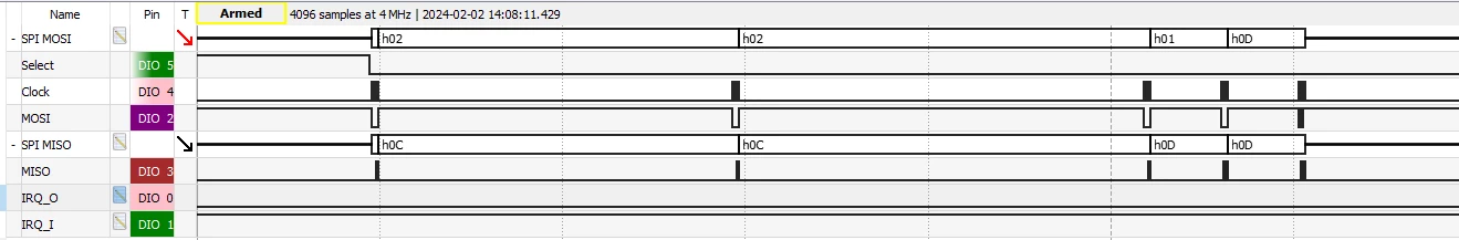

February 2, 2024
Ok, I have my SPI set for 2MHz and SPI Mode 0, so CPOL=CPHA=0.
Spoiler
Arduino Code: SPISettings(2000000, MSBFIRST, SPI_MODE0)
Just narrowing the scope of my question down to setting the Protocol, I have captured the sequence of sending 0,2,2,1,D to setup ISO15693. MISO is responding C,C,C,D,D
the 0 is the first little box
I don't know why there would be such variability in the time between frames but I also don't know if it matters.
Even though MISO is responding differently than 6, I can put the scope loop by the antenna and measure the 13.56MHz field after sending this sequence.
Brian TIDAL
February 2, 2024
as explained in my previous post, make sure to have a GTv Guard Time (>5ms) between the ProtocolSelect command that enables the field on and the first SendRcvd command. Then fill free to send me the raw file from the logic analyzer (make sure to include the startup sequence, the protocolSelect and the SendRcvd commands).
