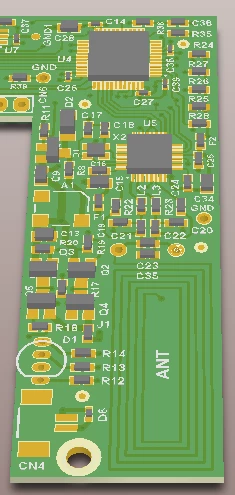

I am going to make a complete prototype of a PCB which include NFC transceiver ST25R95. I Have calculated with ST spreadsheets the values of matching capacitors from estimated values of Rant and Lant, Cant is unknown and is not being considered. The measures, I mean from one hole to another hole, the coil/antenna. The coil is drawn on both sides of the PCB.

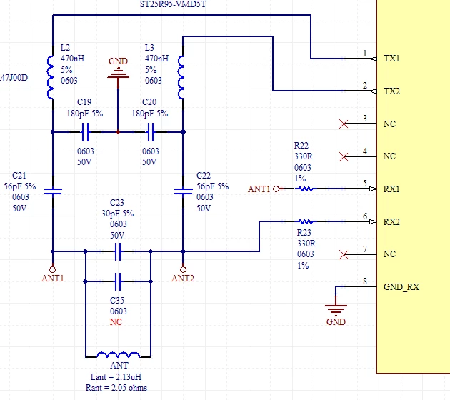

Current schematic of RF part:
Current PCB layout:

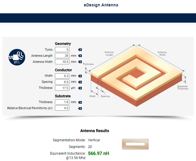

eDesign tool gives Lant = 567nH. Since the coil is double side, multiply it by 4 (but I will use 3.75). Then, 3.75 * 567nH = 2.13uH.
So I drawn the coil. Total lenght is 594mm, if consider both sides summed. Rant calculated = 2.05 ohms. To reach 2.05 ohms, use PCB parameters: 0.5 oz (18um) copper thickness, length = 594mm total and 12 mils for trace width.

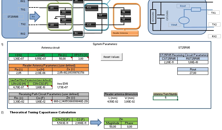

Having Rant = 2.05 ohms and Lant = 2.13uH, I can use the component calculator spreadsheet of ST25R95. And from here came my values shown at the top of the topic for capacitors C21, C22 and C23.
Is there something missing on the calculations or on the procedure? For example I don't know how to calculate the capacitance between the holes, maybe it should be considered...

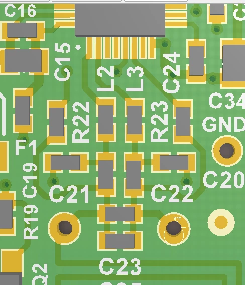

And on layout software the antenna looks like this:
Considering that antenna, could I choose more suitable values than the ones that are currently choosen?

    • Edesign suite antenna modules calculates the coil inductance taking into account the parasitic cap. thus, value given by eDesign suite is closer to the equivalent inductance extracted from imaginary part of impedance rather than the pure self inductance. so no need to hole to home capacitance.
    • last point, as described in AN5248 calculated components shall be validated by a tuning circuit input impedance session.
