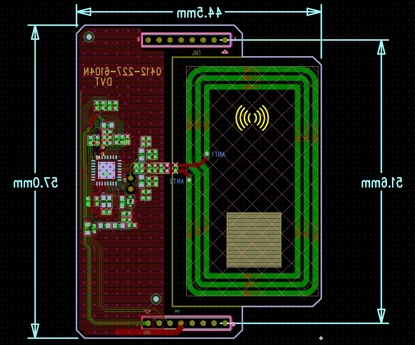

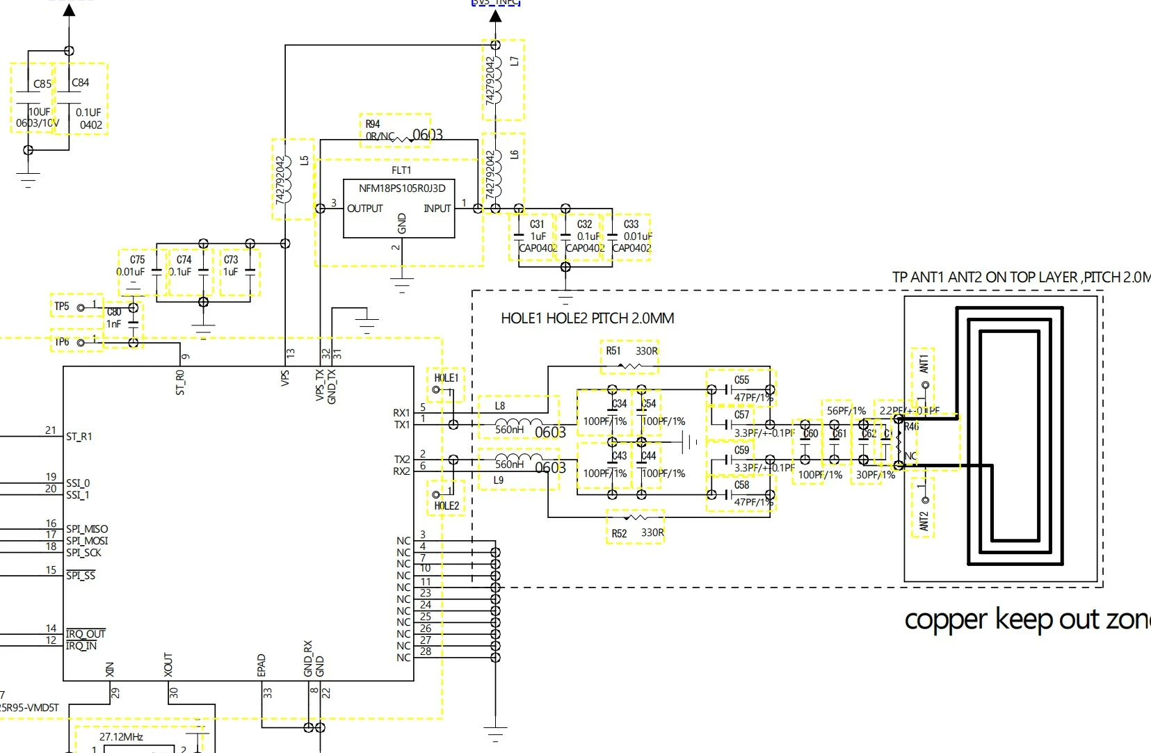

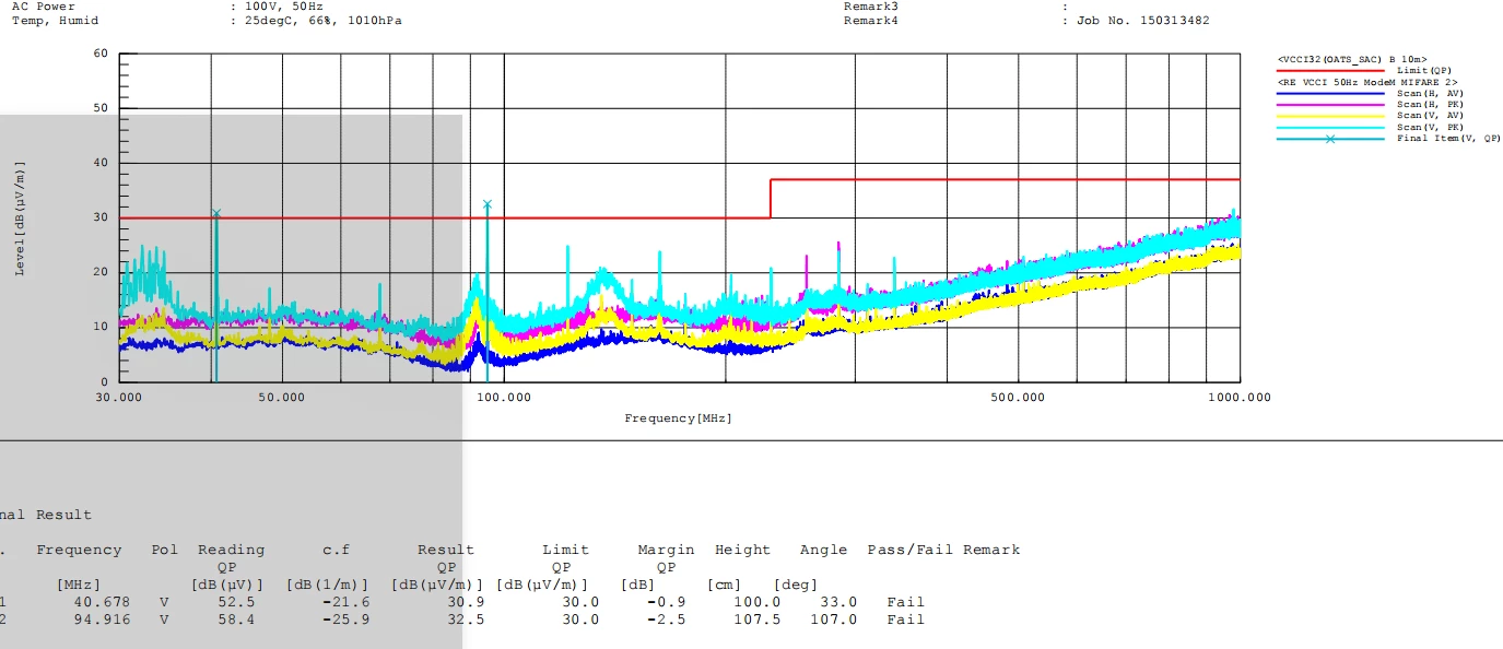

I am using the ST25R95, following the application note and matching tool to define LC components for EMC filter and matching circuit. the function test is good, but I have a high pulse at 3rd harmonics 40.8MHz and 7th 94.92MHz, do you have similar case happens with emission issue?
have any suggestion?

If the card is put in close distance / close coupling on the reader, it will receive the maximum power. Most cards have an internal limiter which is rectifying and limiting the received voltage. Dependent on how this limiter is inside the card is designed, it can produce more or less harmonics. This is something the reader has no influence, since the hard is cutting off the tips of the sine and therefore creating harmonics.
You can try to improve the placement on the reader and the distance between reader antenna and card antenna.
How does the spectrum look like, when there is no card in the field, and only the reader device tested?

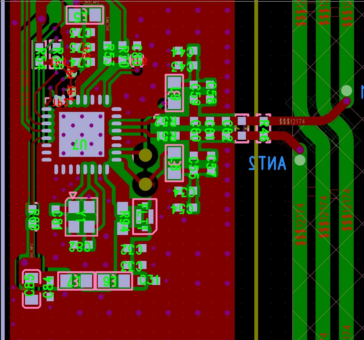

Hello Jeckson,
In general it could be that a ESD diode is saturated and cuts off/limits the sine wave. I would like to ask you to check all the voltages, if they are inline with the datasheet specification.
Could you also share the layout related to the NFC part.
It would also be interesting, if you change supply filtering what the resulting change in the spectrum would be.
BR Travis
JECKSONAuthor
June 25, 2025
Hi Travis
Thanks for your help!
I will check all voltage tomorrow, please check my layout first2025-06-25 230130.jpg2025-06-25 230226.jpg2025-06-25 230431.jpg
