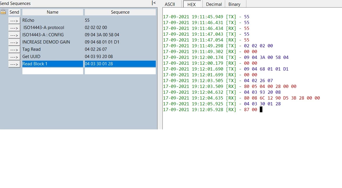

0693W00000DnYRMQA3.jpgHi,
I am getting the UUID of the device but I am unable to read or write the data. Its giving the response of 0x87 00 (No Tag). Help me to solve the problem... How to read the data from the memory...?
Please check out the above commands sets...
Board: X-Nucleo-NFC-03A1
Kind Regards,
Nishanth M

    the tag does not reply to the READ (30 01) command because the tag has not received the SELECT command. The tag is therefore not in ACTIVE state
    I would suggest to send 04 08 93 70 [4 bytes UID] [BCC] 28 i.e. SendRecv(SELECT with UID+BCC) to enter ACTIVE state. Once in ACTIVE state, the tag replies to commands such as READ.
    i would also suggest to use the X-CUBE-NFC3 firmware package from st.com. This provides the various steps to activate a tag.
    Rgds
    BT

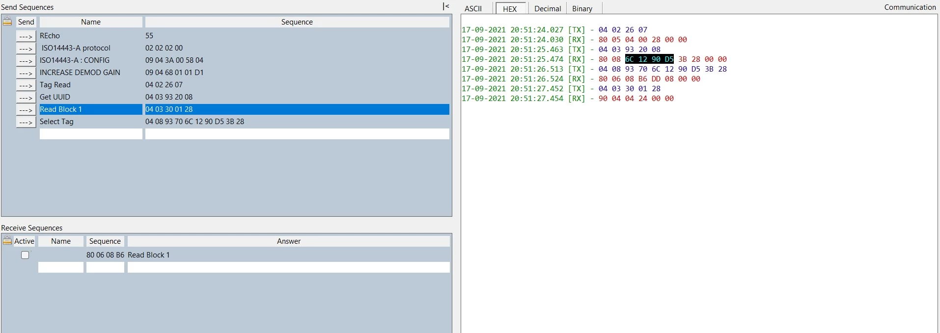

    I tried by selecting tag command, but now it gives "90 04 04 24 00 00"
    Still i am not able to read the tag data...

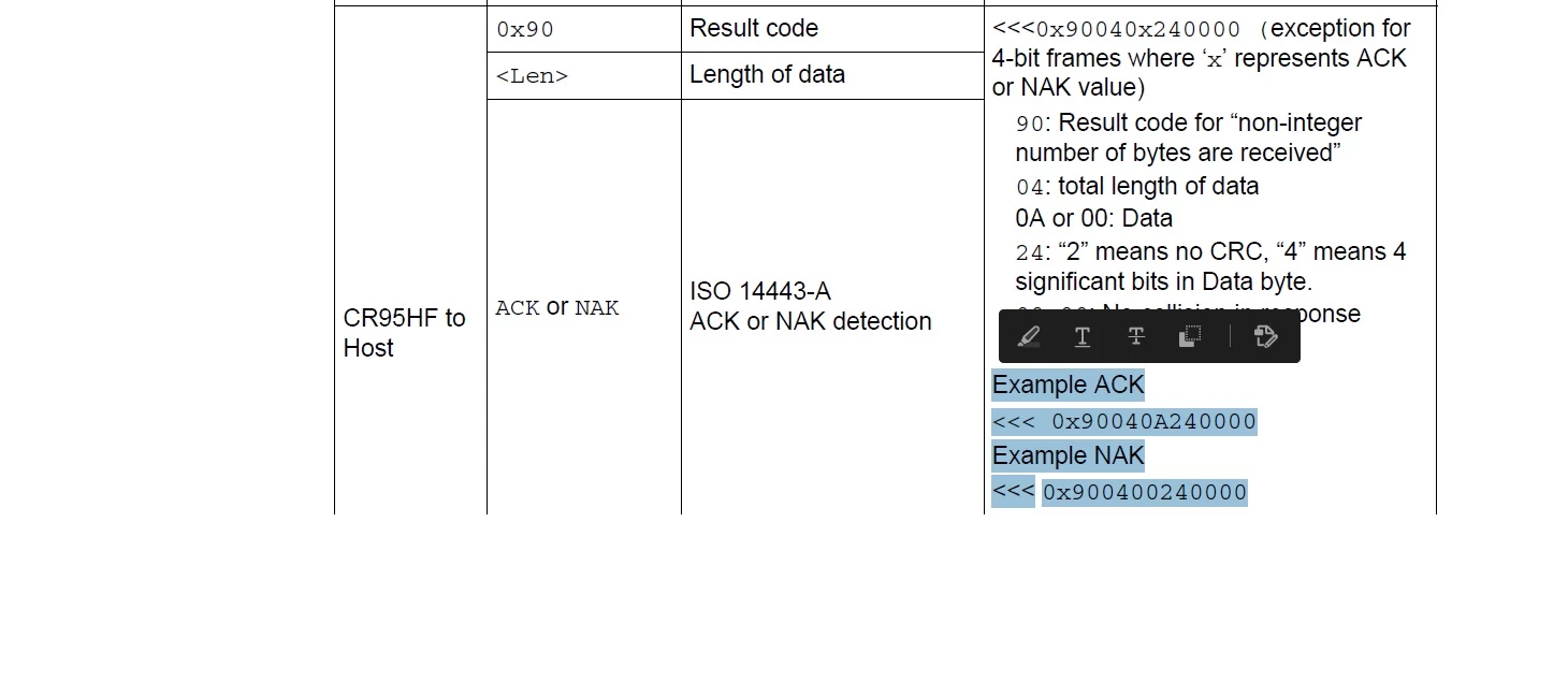

    I checked in the datasheet for the above response, but I am not clear that, In the datasheet shows 0A as ACK and 00 as NACK. But in my case 04 is coming...

    the ACK or the NAK is a reply from the tag. So, the list of NAK values depends of the manufacturer of the tag. The ST25R95 datasheet only gives some examples of ACK and NACK answers.
    Which tag do you use (manufacturer & model)? Make sure this tag support READ command without any prior authentication
    Rgds
    BT

    Brian TIDAL
    September 17, 2021
    according to the Datasheet of the tag you are using (see figure 4 of the datasheet), a proprietary authentication is needed prior to any memory operations. Trying to send a Read command without having performed this mandatory step leads to receiving a NACK answer from the tag. Such tags are not Type 2 compliant and the proprietary authentication is not available from ST. See related topic: https://community.st.com/s/question/0D50X0000ADDjr7SQD/what-are-the-nak-value-meanings-for-cr95hf.
    If your want to simply perform Read/Write commands without any authentication/encryption, Type 2 compliant tags will fulfill your needs.
    Rgds
    BT

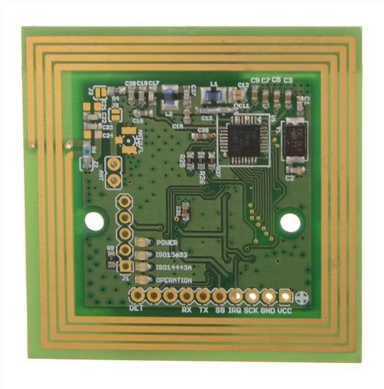

    I want your suggestion such that in my PCB layout, I am trying to put all the RF chip and components will be at center of the antenna. So that I can get more space. If I seen the CR95 Eval board the antenna part is separate and no other components also placed at the bottom and inside the antennal tracks.
    0693W00000DnjeWQAR.jpgThis above type of placement is recommended?
    Will you share the PCB guidelines for the CR95H...

    Brian TIDAL
    September 20, 2021
    in accordance with this Community Ground Rules, I would suggest to start a new thread regarding the PCB and HW related questions and to mark this current thread as replied.
    Thanks in advance,
    Rgds
    BT
