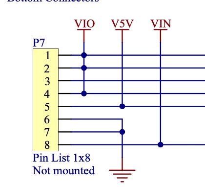

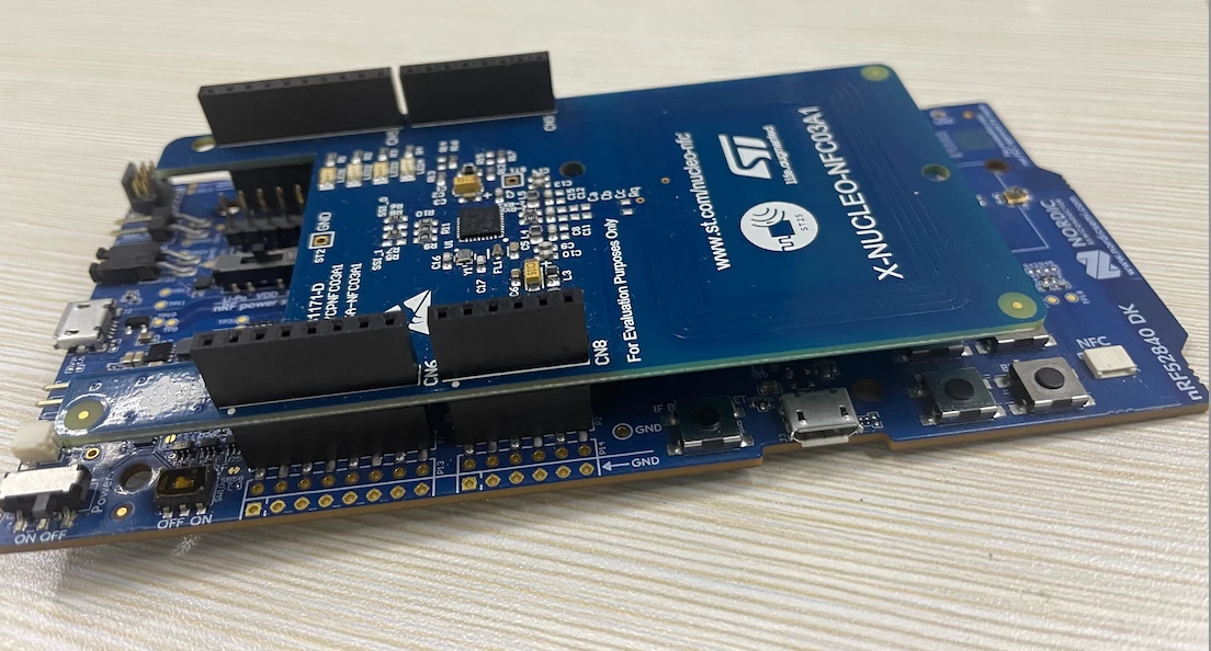

The nRF52840DK is compatible with the Arduino Uno Rev. 3 standard so they are wired with the connector.
The 3V3 supply on CN6.2 and CN6.4 are different pins, as well as GND. But they are connected on the nRF52840 respectively.

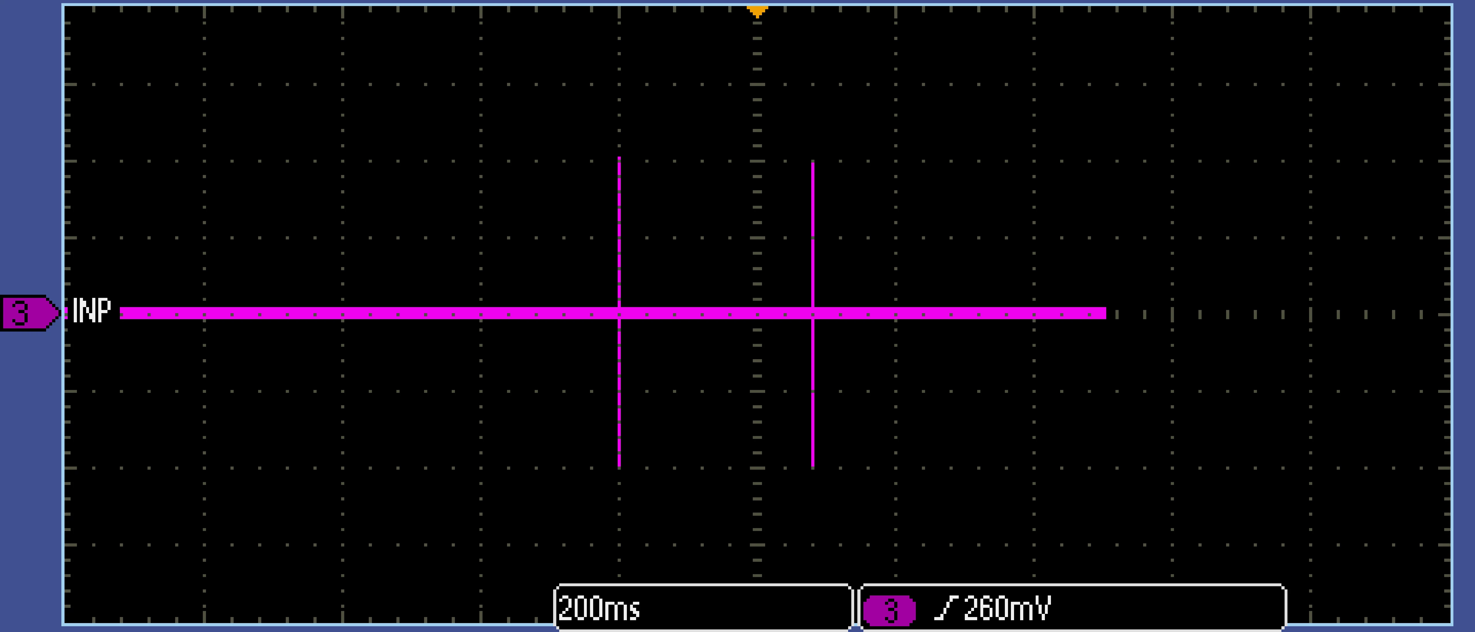

When entering in WFE mode for a given calibration step, [<Maxsleep> + 1] bursts of <SwingsCnt> pulses at 13.56MHz are transmitted every tINACTIVE milliseconds.  tINACTIVE is  (<WUPeriod> + 2) x tREF with tREF=8ms and therefore tINACTIVE is 16ms (this is actually closer to 17ms due to some processing after each burst). So, with <Maxsleep>=1 and <SwingsCnt>=63, there are 2 bursts of 63 RF pulses transmitted every 17ms and then a response is returned.
The burst can be observed on a scope (just connect the gnd of the probe to the tip of the probe and put the probe in the field and you should be able to capture the field):

P.-S. the antenna of the X-NUCLEO-NFC03A1 board seems quite close to the MCU PCB. This will therefore cause issue during tag detection. I would suggest, for test purposes, to use some wires between the MCU board and the  CN5/CN6/CN8/CN9 connectors of the X-NUCLEO-NFC03A1 to make sure the antenna is in open field.

I am using wires to connect the MCU board and X-NUCLEO-NFC03A1 now.
Seem that the interval of the 2 bursts is more than 200ms in my tests. I forgot to trace SPI CS, will confirm it later.
