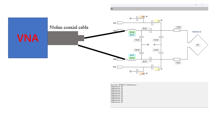

I am currently using the ST25R500 and designing a reader with the goal of achieving the maximum possible reading distance. I have been working on the antenna design, impedance matching, and the internal transmitter impedance settings of the ST25R500, but I have encountered some confusing results and would really appreciate your advice.

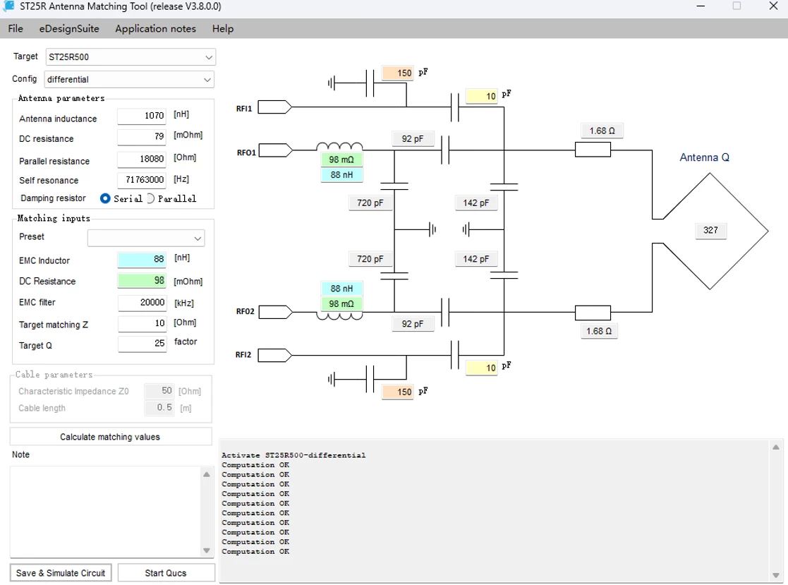

My antenna is a 2-turn enamelled-wire coil. For the impedance matching, I am using the impedance matching software officially recommended by ST.
Based on the recommendations in the datasheet, I set my target impedance to:
10 Ω − j4 Ω
As far as I understand, this target impedance should be within the recommended range.
I entered my antenna parameters into the official matching software and used its built-in simulator. I then adjusted the values of the matching components, as shown in Figures 1 and 2.

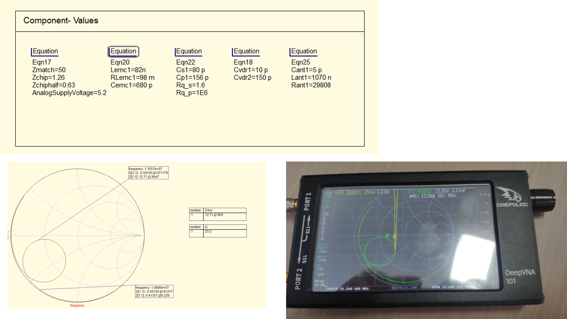

However, after actually building the circuit and measuring the antenna feed point with a NanoVNA, I obtained a significantly different result from the simulation.
The measured impedance was approximately:
Z ≈ 23.55 Ω − jX
The corresponding reactance is approximately equivalent to:
C ≈ 3.11 nF @ 13.56 MHz
My NanoVNA measurement setup is shown in Figure 3.
(This is the schematic diagram of the wiring I did during the test. On the actual PCB, it is not powered on. ST25R500 should default to the high-impedance state.)
This leads to my first question:
Why is there such a large difference between the impedance obtained from the official ST matching software simulation and the impedance measured in the actual hardware using the NanoVNA?

  1. How should the target impedance in the official ST matching software be interpreted?
    Is the target impedance the actual load impedance that should be presented to the ST25R500 RFO1/RFO2 outputs?
  2. Why is there such a significant difference between the simulation result from the official ST software and the impedance measured with the NanoVNA?
    In this situation, should I use the simulated result as the reference, or should I primarily rely on the actual antenna/feed impedance measured at 13.56 MHz?
The matching impedance of Z=23 -jx is not concerning to me at all. There are parasitic which cannot be estimated in the simulation since they are related to PCB layout and PCB stack-up. For example, the dimension of the parallel capacitance track width and its capacitance to the below metal layer. It creates an additional parallel capacitance of typically ~3pF to 10pF which is shifting your resonance point lower in frequency. Using the strong capacitive matching (as you did) such additional parallel capacitance is increasing the matching impedance. Please take a closer look at chapter 8.4 Matching network behavior of AN6092 for finetuning the matching impedance.
Has this question been sufficiently answered above?

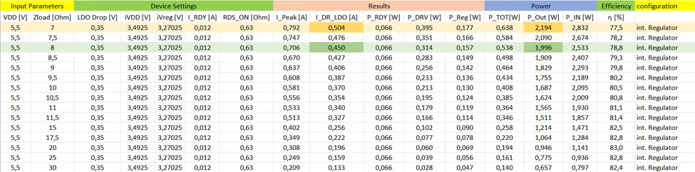

What is the actual relationship between the ST25R500 internal transmitter impedance setting and the external antenna/load impedance?
Why does reducing the ST25R500 internal impedance from approximately 20 Ω to approximately 2 Ω result in a longer reading distance?
Please have a look at chapter 4 Dissipated power calculation of AN6092. It explains the relationship between dissipated power, ouput power and efficiency. You can put the formulas in an excel file to compare different scenarios fitting to your application. For example:
To correctly do the load balancing you would need to go the other way around. Instead of increasing the transmitter impedance, you would need to lower the matching impedance.
Zsource  ~ 2*0,63, ZLoad = 1,26Ohm
But the result would violate the Abs max ratings specified in the datasheet:
And the device would stop working.
