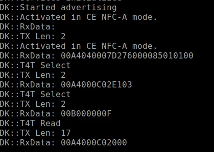

Hello, unfortunately I dont́. However, I have noticed something in the HandleCardEmulation function that is extracted from your demo:
void NFCHandler::HandleCardEmulation(rfalNfcDevice *nfcDev)
 #if RFAL_SUPPORT_CE && RFAL_FEATURE_LISTEN_MODE
 ReturnCode err = ERR_INTERNAL;
 uint8_t *rxData;
 uint16_t *rcvLen;
 uint8_t txBuf[150];
 uint16_t txLen;
 do
 switch( rfalNfcGetState() )
 case RFAL_NFC_STATE_ACTIVATED:
 err = this->TransceiveBlocking(NULL, 0, &rxData, &rcvLen, 0);
 case RFAL_NFC_STATE_DATAEXCHANGE:
 case RFAL_NFC_STATE_DATAEXCHANGE_DONE:
 txLen = ((nfcDev->type == RFAL_NFC_POLL_TYPE_NFCA) ? cardEmulationT4T(rxData, *rcvLen, txBuf, sizeof(txBuf)) : rfalConvBytesToBits(cardEmulationT3T(rxData, rfalConvBitsToBytes(*rcvLen), txBuf, sizeof(txBuf))));
 CCC_Log("TX Len: %d\n", txLen);
 err = this->TransceiveBlocking(txBuf, txLen, &rxData, &rcvLen, RFAL_FWT_NONE);
 break;
 case RFAL_NFC_STATE_START_DISCOVERY:
 return;
 case RFAL_NFC_STATE_LISTEN_SLEEP:
 default:
 break;
 while( (err == ERR_NONE) || (err == ERR_SLEEP_REQ) );
 #else
 NO_WARNING(nfcDev);
 #endif /* RFAL_SUPPORT_CE && RFAL_FEATURE_LISTEN_MODE */
For the Samsung A12 I get these logs:
It goes through T4T Select and T4T Read and has different sizes including 118 (NDEF payload size); However for Xiaomi 14T I got this:
It seems like the communication does not advance and is always stuck at the same stage.

would be useful to see the received payloads and the sent payloads as well. However I would be suspecting a timing issue here. So it might be better to disable the logs and do a logic analyzer trace which allows to see timings, payloads and many more things.
Regards, Ulysses
