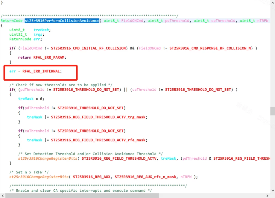

ST25R3920B appears RFAL ERR INTERNAL in the field on process
In the process of using ST25R3920B as a card reader, if the value of RFO is modulated to 0, there will be an RFAL ERR INTERNAL error, and the card reader will not be able to read NFC cards. Changing the value of RFO to 0x03 can not detect the existence of the card.
What is the reason for this RFAL ERR INTERNAL error? How can I adjust the value of RFO to make the card reader return to normal and read the card again?

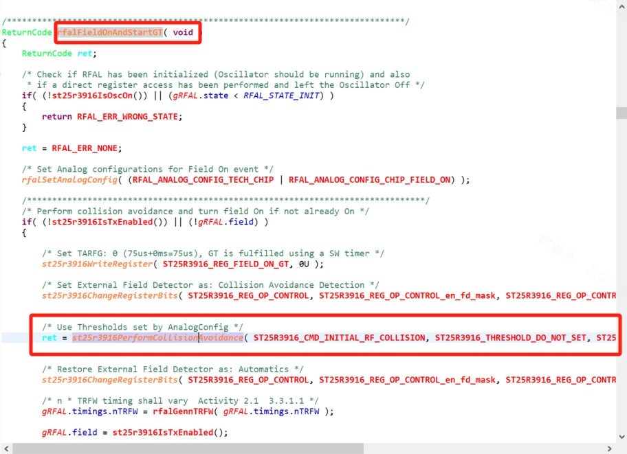

the reason is further down in the code:
 if( (ST25R3916_IRQ_MASK_CAC & irqs) != 0U ) /* Collision occurred */
 err = RFAL_ERR_RF_COLLISION;
 else if( (ST25R3916_IRQ_MASK_APON & irqs) != 0U )
 /* After APON wait for CAT interrupt, indication field was switched on minimum guard time has been fulfilled */
 irqs = st25r3916WaitForInterruptsTimed( ( ST25R3916_IRQ_MASK_CAT ), ST25R3916_TOUT_CA );
 if( (ST25R3916_IRQ_MASK_CAT & irqs) != 0U ) /* No Collision detected, Field On */
 err = RFAL_ERR_NONE;
Neither CAC nor APON interrupt are coming -> Is your interrupt handling in MCU working properly? Did you enable ST25R_SELFTEST and successfully run through the initialization?
I am not following your description of RFO value. Which value, where? RFO is in the first place the antenna output pin of ST25R3916B/20B.
Regards, Ulysses

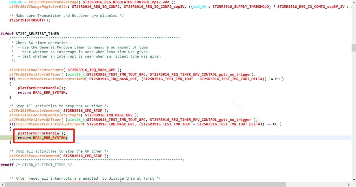

I turned on ST25R_SELFTEST and ST25R_SELFTEST_TIMER, and the initialization failed.Does this mean that the fault lies not in the software but in the hardware?

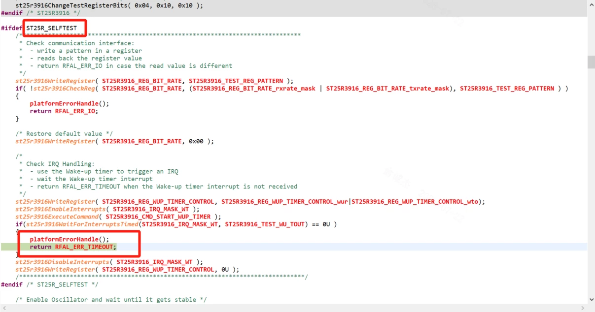

July 22, 2025
Hi
I use ST25R_SELFTEST and ST25R_SELFTEST_TIMER to check my program,but both failed.
ST25R_SELFTEST returns RFAL_ERR_TIMEOUT,
ST25R_SELFTEST_TIMER returns RFAL_ERR_SYSTEM (2nd).
What is the reason for this error, and how should I solve this error?
Thanks, zhang
Ulysses HERNIOSUS
July 22, 2025
please read the comments around these places. Here the code will test
  1. if interrupts are received and signaled to the main layer
  2. if the timer handling is about right. Not too fast and not too slow.
If you fail on any of these you need to look into your ISR and your timer porting.
Ulysses
July 24, 2025
The function st25r3916Isr () was called only once during initialization, and was not called when an error occurred.
The MCU is NXP S32K1.
Ulysses HERNIOSUS
July 24, 2025
this means your interrupt are not handled properly. Having INT line statically high is also a sure indication of that.
Ulysses
