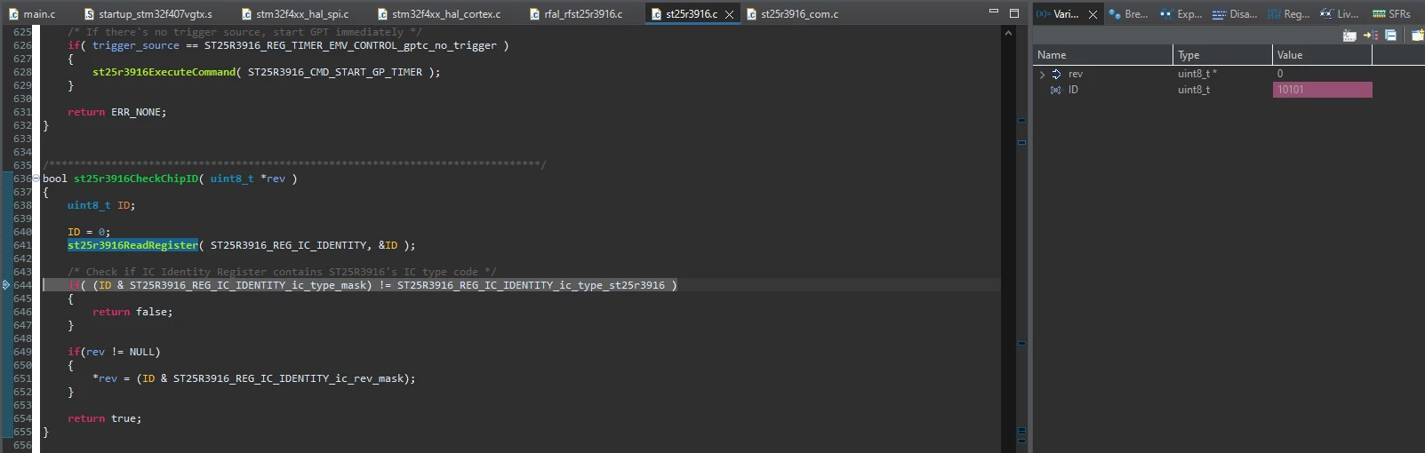

I'm working on a project where I'm using the ST25R3918 with RFAL libraries. Initially, I read the IC identity register and performed a right shift. Why did I perform this right shift?
I modified the read register function, added a right shift, and successfully read the correct registers. However, my code is now not functioning correctly.
What steps should I take to resolve this issue?

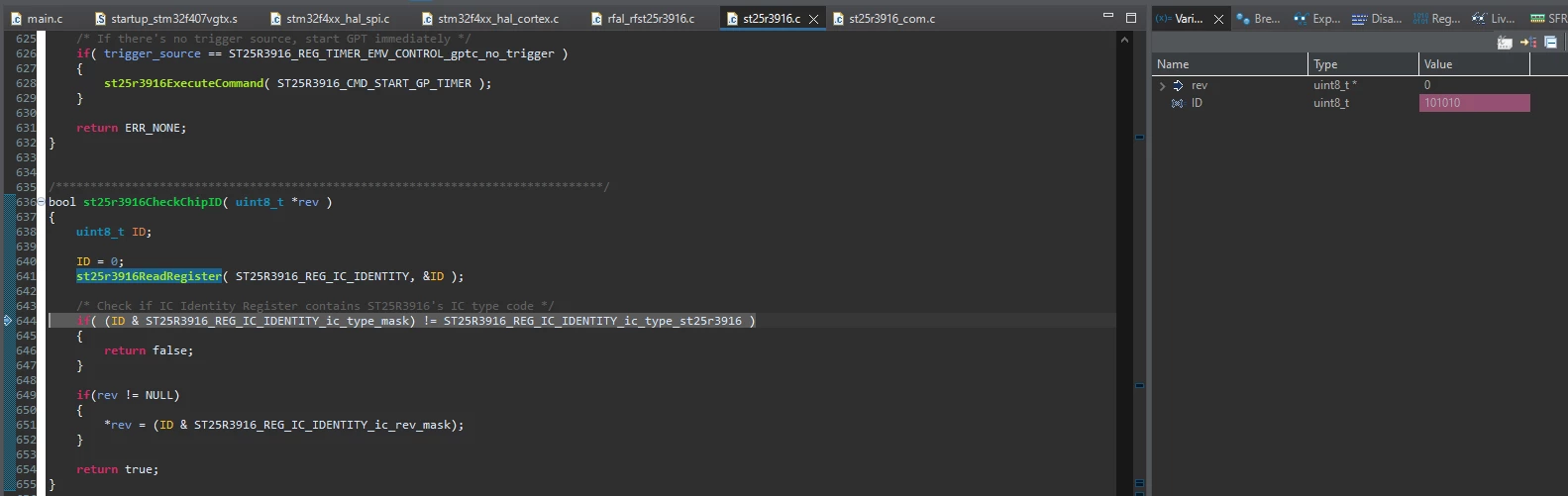

do you mean you have modified the st25r3916ReadRegister function inside the RFAL? I would recommend to not modify the RFAL source.
For your information, the IC identity register is checked during the RFAL initialization. Can you share more details on why you need to read it ?

September 25, 2023
yes, when I modified st25r3916ReadRegister it read like this
when I didn't modified st25r3916ReadRegister it read like this

Ulysses HERNIOSUS
September 25, 2023
Hello zeynepdicle,
reading shifted values from registers is typically an effect of using an incorrect SPI mode in your driver. Please check this.
If still not consistent then also share scopeshot / logic analyzer trace of the read of the IC identity register.
BR, Ulysses
