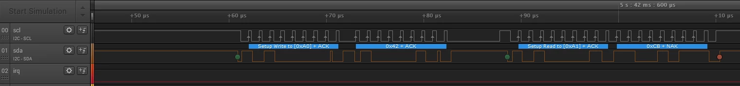

register access to the ST25R3917 is possible without (running) oscillator/external crystal.
When software enables the oscillator (en bit) and the I_osc interrupt is not masked the IRQ line will be driven high once the oscillator is deemed stable. Such does not happen automatically.
The 32kHz on MCU_CLK indicates that the internal low power oscillator got enabled.
I would start looking at the I2C protocol - most common is a shift of the address - whether direction bit is included or not.
As reference you will find here a read from ST25R3916 (with address 50h, shown here as 0xA0) from register 02h. I recommend starting with read from register 3Fh (IC identity), where you will need to send 7Fh instead of the shown 42h.
0693W00000LxK32QAF.pngBR, Ulysses

BTW: It seems like Saleae changed the I2C address interpretation in the new version:

I tested the third board with I2C_EN connected to VDD_D instead of 3V3. Unfortunately with the same result. As the waveform used for communication seems correct, we might have a PCB assembly problem. Does the BSS line need to be tight to GND when operating in I2C mode? I couldn't find any information on that.

Possible checks:
  1. Verify Pull-ups on SCL/SDA
  2. Check connections into ST25R3916 chip: open SCL and SDA and measure ST25R3917 protection diodes using multimeter (red on GND, black on I2C line).
  3. Attach scope and perform signal integrity on I2C lines - not relying on logic analyzer threshold levels.
Best Regards, Ulysses
TWirt.2061
April 11, 2022
Hello Ulysses,
thank you for the good instructions. I solved the problem with the scope. The SDA signal dropped a couple of hundred mV during the ACK phase. Its a bit embarrassing but the GPIO configuration was the problem. I assumed that the alternative function mode will take care of the output configuration in HW and disables the normal IO stages. As this isn't the case it was set to default (push-pull) so the master kept the SDA line high. Simple problem, simple fix but not easy to find on a friday afternoon ;) Thanks again.
