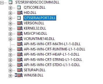

Hello TOzya. Can you give me the release nb of the dll? ( right click on the dll and look at 'detail' tab). You can also check dll & exe dependencies with Depends.exe usually distributed with Microsoft visual studio. For the 1.2.0 release, dependencies are: 0693W00000GYpLbQAL.pngSo we are using release version of the QSerialPort lib. Your problem can comes from the .exe itself

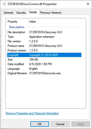

I TOzya.
The Dll version number will allow me to check that you are not using an old version that can potentially embedded debug version of QSerialPort (it has been a known bug that has been fixed). The up to date one is v1.2.0 and use the right version of QSerialPort.
Concerning the .exe generation, it seems that you are using QtCreator. Check that in your .pro file you have QT += serialport and not QT += serialportD (normally the debug version is included automatically by qt framework)..

this is the snapshot of the DLL details:
0693W00000GZLgvQAH.pngv1.2.0.0
