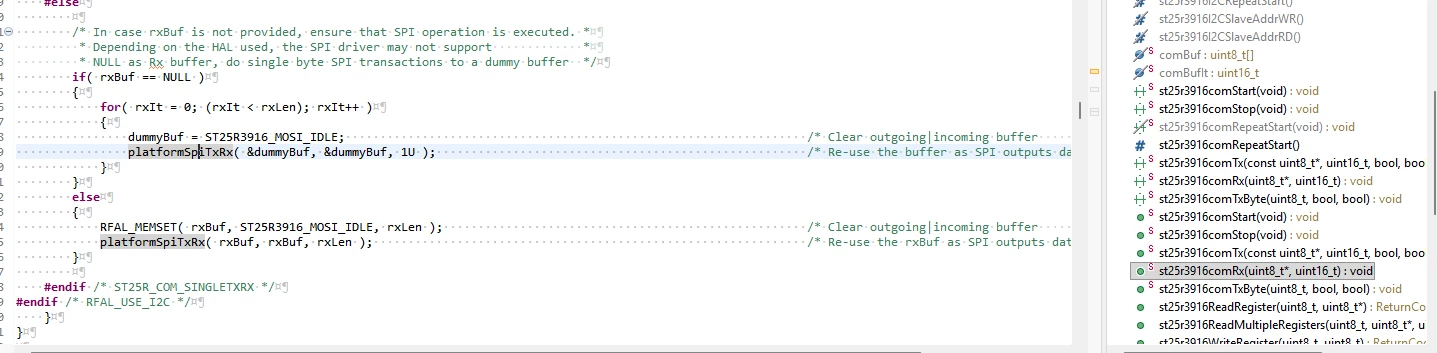

I am using a ST25R3916B with RFAL 4.0, connected to a STM32WB55 via SPI in a battery powered application, so naturally wakeup mode is used. Specifically inductive wakeup with auto averaging.
For a short test on the table this works just finde, but when I let the setup run for multiple hours and thousands of wakeups, at some point it becomes unresponsive.
If I measure the generated field via oscilloscope, I can still see the ~35µs pulses every 400ms, just as I have setup the mode, but there is no interrupt generated.
I do not want to completely dismiss the possibility that the MCU is missing one interrupt somehow, but shouldn't a consecutive change trigger a new interrupt?
What I have found in the AN is
Values close to the edges can lead to a configuration that never wakes-up the system, so, if delta is the difference that triggers an interrupt, the reference value must always satisfy the following conditions:
• reference - delta > 0
• reference + delta < 255
Is there a known situation were auto averaging can maneuver itself into that position and not recover?
Edit: Also I have seen in the Errate that MOSI needs to be be pulled low during IRQ register read, but the RFLA seems to solve this with the following code, right?

It is FreeRTOS using one low priority task for NFC "work" and one high priority task to service the interrupts. The later is activated via Notification from an rising edge EXTI. The former is woken, again by notification by, the IRQ task and then keeps running until wakeup mode is reached.
The WB55 is in Stop2 Mode with wfi if all task are sleeping and of course the EXTI is configured as an interrupt wakeup.
The SPI is shared via a (recursive) Mutex on platformProtectST25RComm()/platformUnprotectST25RComm. If an external task wants to exchange data via NFC, the data is exchanged back and force via queues so NFC itself is handled exclusively in the NFC "work" task.
Edit: This Morning my test was still running fine. Only change since then was an added timeout on SPI transceive (for bigger amounts of data the transceive is done via DMA and awaited with notifyWait, which did not time out before). Keeping my fingers crossed and thank you very much for the insights until now.
