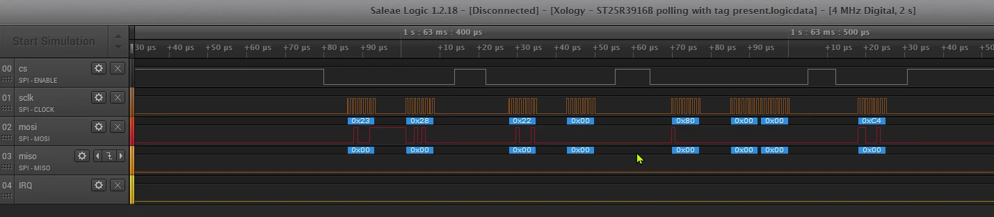

I ported the porting example to a different processor. The self tests are enabled and initialization passes. However I'm not able to read a tag. Logic captures (Salae) are attached. I've verified that I'm receiving interrupts and processing them. I also tested this hardware with an externally NUCLEO-L476RG board and off the shelf firmware and it could read the tags fine. Tags are very close to the antenna, within 1cm.
I noticed that when a 14443 tag is present, the number of interrupts increase, from about 15 per second without a tag, to 20 per second with a tag. But it never outputs the UUID of the tag itself. In the captures I observed that the interrupt gets serviced in about 20uSec.

    here there seems a problem in your SPI implementation:
    0693W00000YAZaUQAX.pngHere should be the sending of REQB(RFAL_NFCB_CMD_SENSB_REQ) command (3 bytes 0x05 0x00 0x00). The TX length is correctly written: 0x18 which means three bytes but on writing the FIFO the first byte is not there. Similar I found everywhere in the trace: The st25r3916WriteFifo() does not cause sending of the correct bytes, sometimes the first one missing, sometimes the second and basically always shorter. I suspect and issue in the platformSpiTxRx() but please debug starting from st25r3916WriteFifo().

    Thanks, I was able to set up a test of st25r3916WriteFifo() and was able to identify the issue. The MSP430 only has a one byte output buffer for SPI and the code was writing over the buffer before the byte was transmitted, so not all the bytes were sent. Once I fixed that the whole thing works; now I am able to read tags which is very nice. Thank you for your help.
