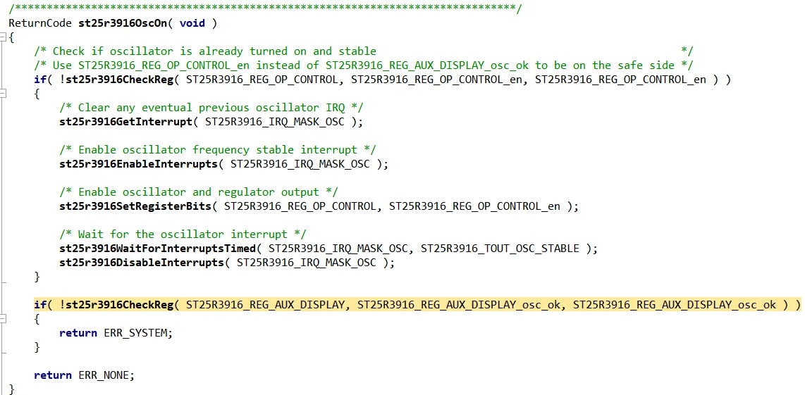

I've already replaced all the SPI functions from ST with the Nordic ones, and I've confirmed successful SPI communication using the SALEAE device. However, I'm encountering an issue with the MISO channel not receiving the correct parameters. As a result, the program initialization is failing in the line:

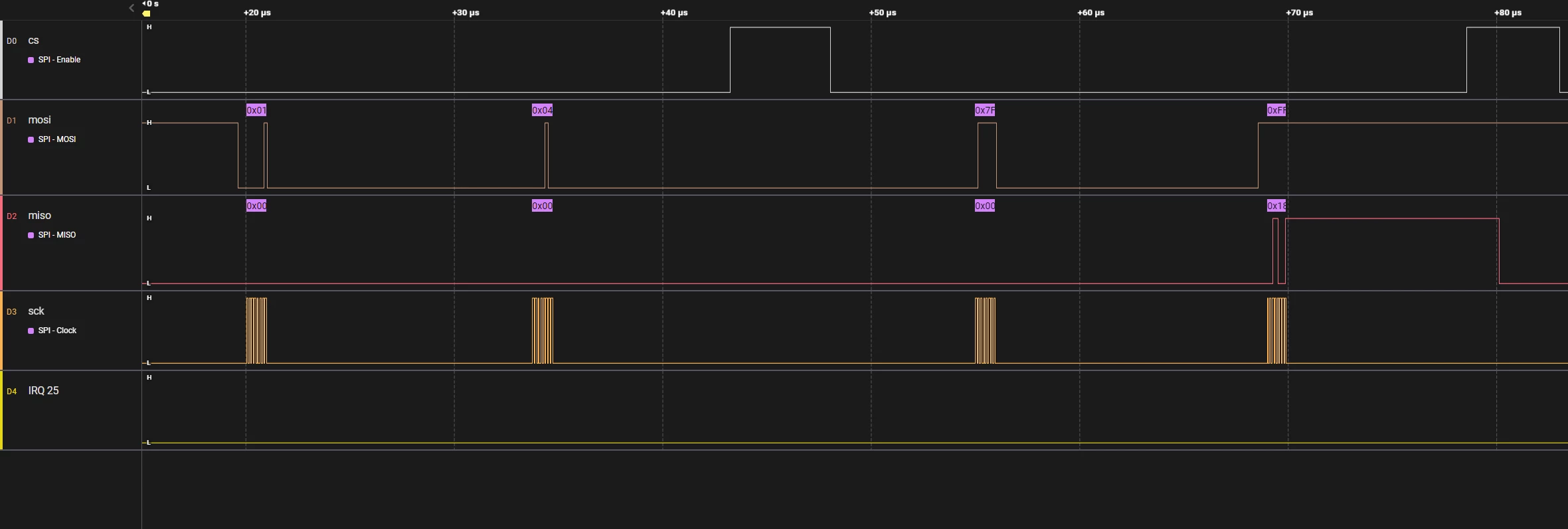

I believe the issue lies within the SPI configuration. While I am able to send and receive data, there are instances where the received data does not match the expected values by the ST25R3916B.
As you can see, the interruption gets triggered.
in this image, i'm asking for the CHIPID, and I receive 0x18 (that's the same with the NUCLEO L053).

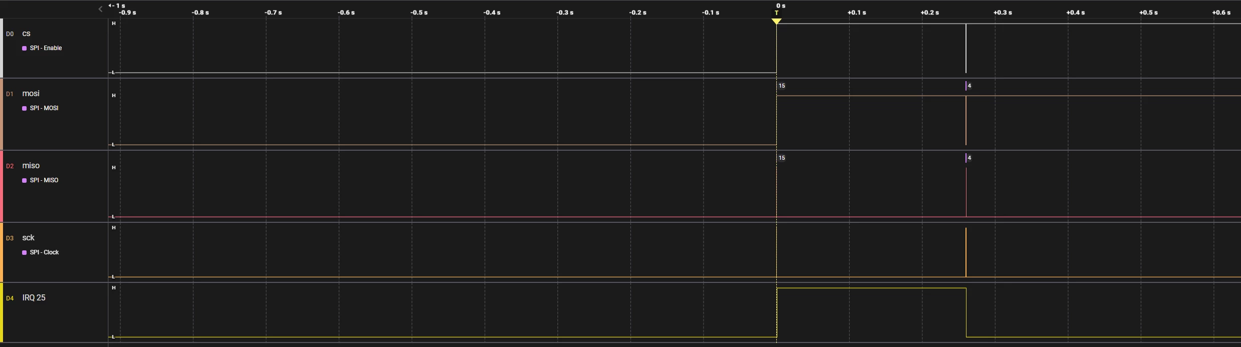

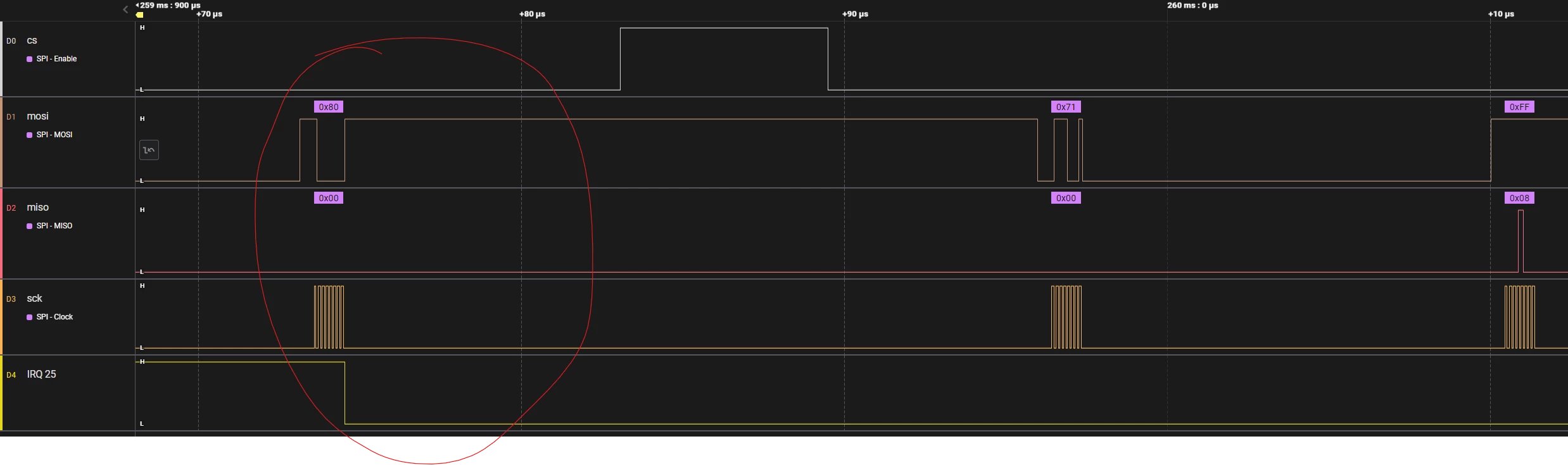

otherwise, here i should expect some data, and i do not get anything:
In addition, it's worth noting that the Chip Select (CS) pin only changes at the beginning and end of each transmission. This behavior is intentional because the ST25R3916B needs to keep the CS pin low while performing a multivalue send option.
I appreciate any assistance or suggestions you can provide to help resolve this problem. if you need more information, do not hesitate to contact me.

I would suggest to enable the ST25R_SELFTEST and ST25R_SELFTEST_TIMER switches during compilation. This provides communication tests and interrupt tests. Check then the return code of st25r3916Initialize
Also make sure to configure the Salea SPI decoder with CPOL=0 and CPHA=1 (if I am not wrong, IC identity register (3Fh) of the ST25R3916B contains 0x31 not 0x18 so the configuration is likely incorrect).
Make sure the nRF52840 SPI is properly configured as per ST25R3916B datasheet §4.3.3:
"The ST25R39xxB have a standard serial peripheral interface with clock polarity of 0, a clock phase of 1, and an active low slave select signal. Communication starts with the MCU pulling BSS low. The MOSI pin is samples on the falling edge of SCLK, and the state of the MISO pin is updated on the rising edge of the SCLK signal. Data is transferred byte-wise, most significant bit first."
