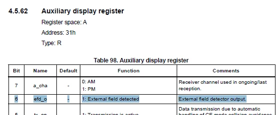

The first step in card emulation of the ST25R products is to recognize the field of the initiator.
Can you please observe the efd_o bit while approaching with another reader?
Some more information about the efd:
External field detector
This is a low power block used in the active or passive target mode to detect the presence of
an external RF field. It supports two different external field detection thresholds, namely
Peer detection and Collision avoidance threshold.
The Peer detection threshold is used in the active and passive peer to peer modes to detect
when the peer device turns on its RF field.
The Collision avoidance threshold is used to detect the presence of an external RF field
during the RF collision avoidance procedure.
BR Travis
