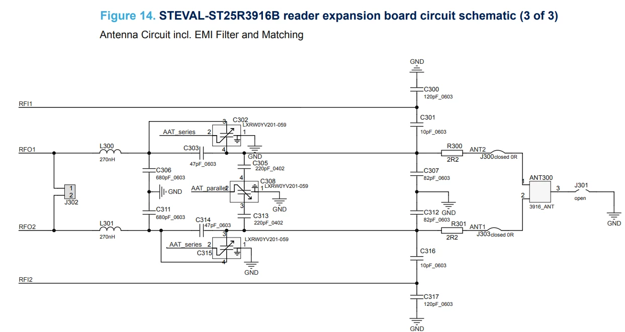

[ST25R3916] Reference Design : End of Life for variable capacitor LXRW0YV201-059
  • May 12, 2025
  • 1 reply
  • 1340 views
Murata has announced that the variable capacitors LXRW0YV201-059 will become obsolete in 2026.
https://www.mouser.com/PCN/Murata_PCN_for_Mouser_(LXRW)_Mar._6_2025.pdf
These components are part of the antenna matching/EMI filter circuit in the STEVAL-ST25R3916B schematics.
Do you have any recommendation for an alternative reference to replace these capacitors once they become obsolete ?
Thanks in advance,
Best regards
Best answer by Ulysses HERNIOSUS
Hi
unfortunately no alternatives available. Please have a look at
https://community.st.com/t5/st25-nfc-rfid-tags-and-readers/st25r3916b-aat-variable-capacitors/m-p/788594
BR, Ulysses
